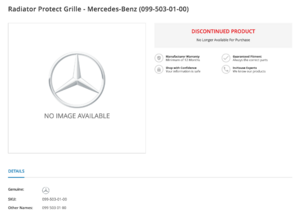

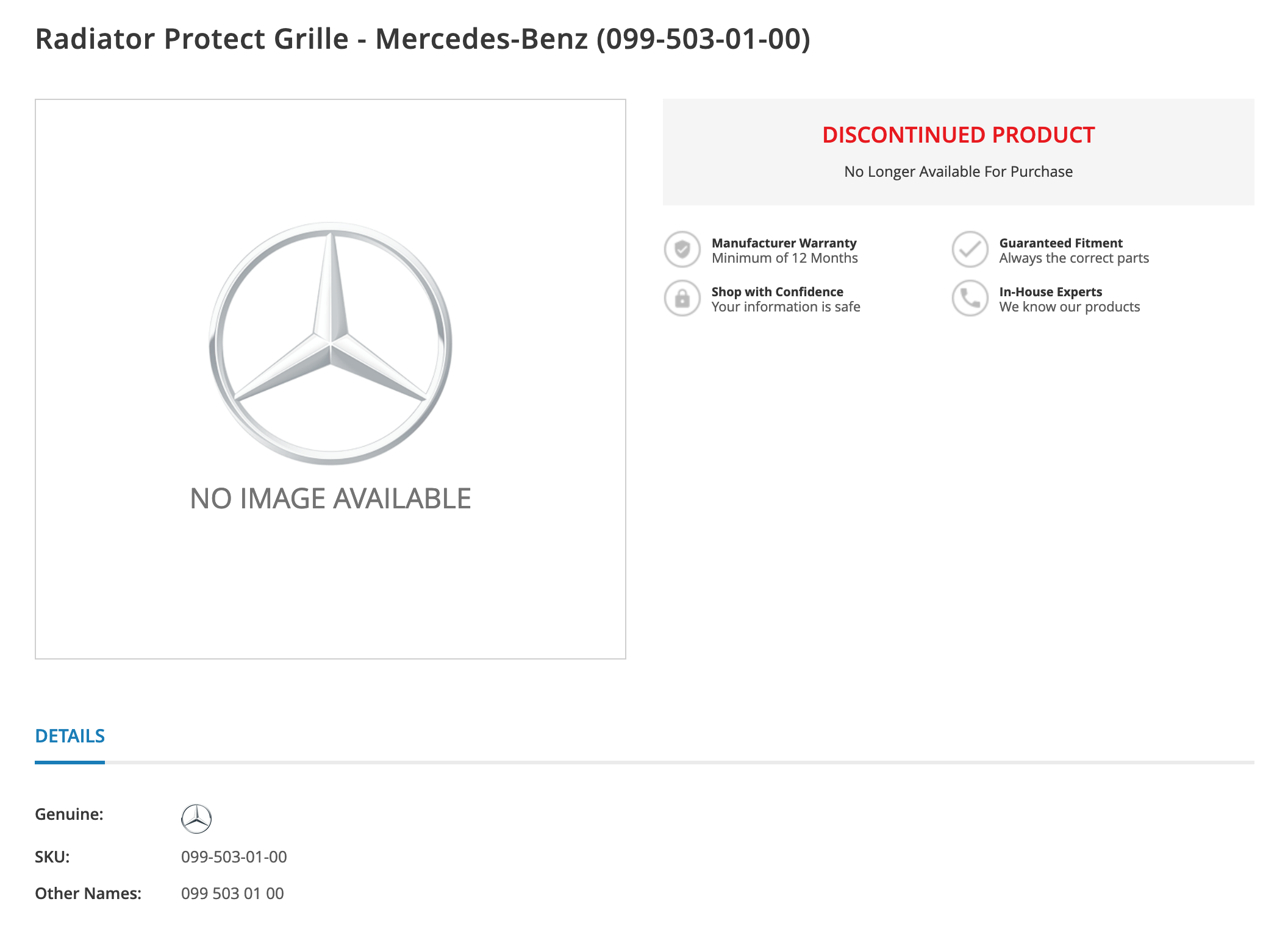

This is what im seeing trying to buy the radiator protection grille from the part numbers given here:

Anyone know where to get the parts for a 2016? Part numbers are showing as discontinued

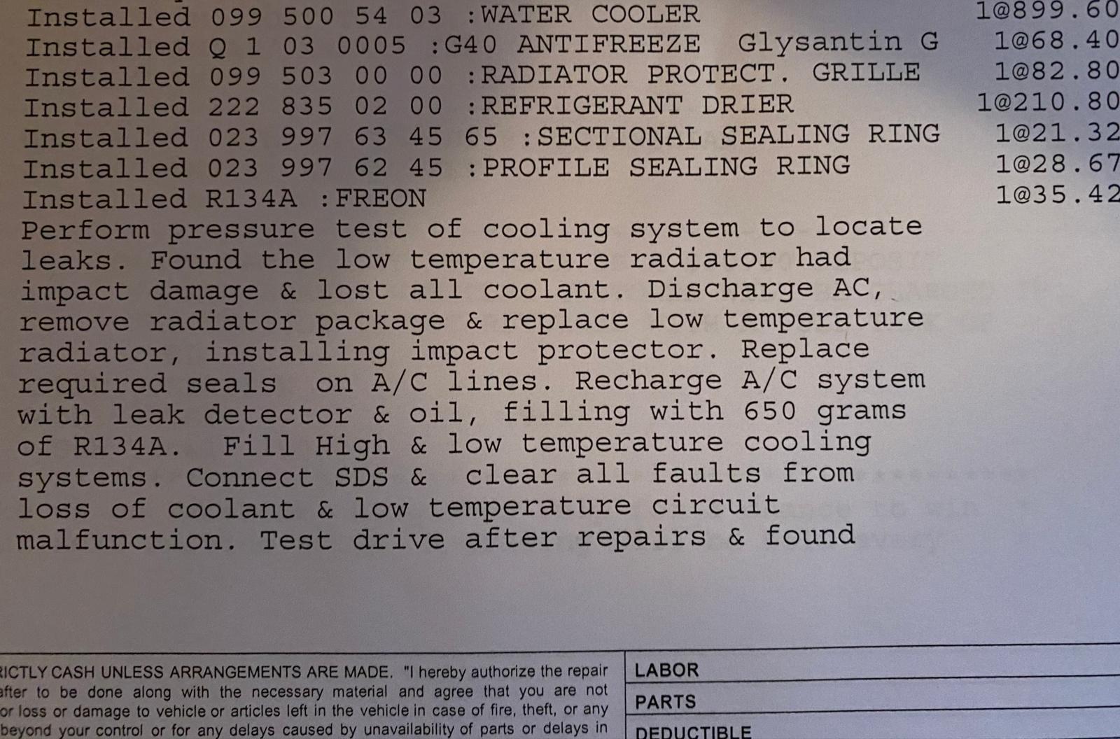

You can see the part number in the image I linked in my comment above for the radiator grill. 099 503 00 00

Quote: You can see the part number in the image I linked in my comment above for the radiator grill. 099 503 00 00
Thanks, part number different from previously reported in the thread
