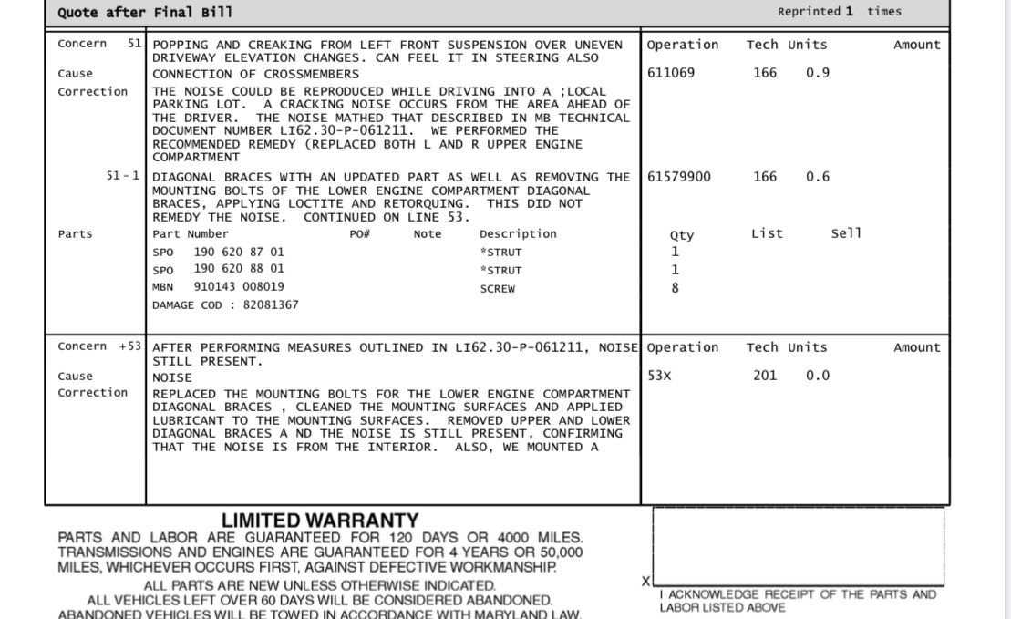

Can you describe your sound again? What I'm hearing is more of a rattle, not loud at all, when you go up a curb or when the road surface is uneven. It's only really noticeable at low speeds.

If you can feel it in the steering, then how can it be related to the interior trim? That’s what I would ask your technician.
And tell him to check the antiroll bar bolts torque.

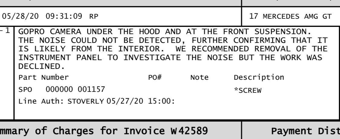

I would not worry about the dash removal. It looks bad, but a competent tech will put it back and you won’t notice anything different. But I can’t see how it’s related to something behind the dash if you can feel the issue through the steering column.
These cars are well engineered, especially the GT - MB wouldn’t put a suspension adjustment in a spot that required the dash to be removed to access.

I’m just so out of energy. Expect the rudeness and disrespect I received from the General Manager Sam. Even the Mercedes-Benz executive rep called since I filed a complaint. She called me today to follow up and I told her I don’t want anything out of this. This whole experience has made me done with cars. Can’t deal with a cocky rude disrespectful General manager whether I’m spending 15k or 150k. They win, I give up. I’ll just deal with the noise and if I decide to have my car worked on, I’ll try another dealership. But they said the only next step was to pull out the dash to get to the bolts to torque them. I didn’t spend almost 100k to have that done and not enjoy my car. Come on I just bought it and I know I can put it in the shop for warranty but unless you’re a real car enthusiasts you don’t understand.

I think I may swap this amg GT in for a s63 coupe. There are way to many creaks and cracks going on inside the cabin. I believe suspension related. It’s always in slow left turns and slowly driving up on uneven surfaces. Someone mentioned re tighten the shock strut brace nuts. But I’ll give the dealership a shot to fix this if not they offer car take back for same value or more at this MB dealership.
