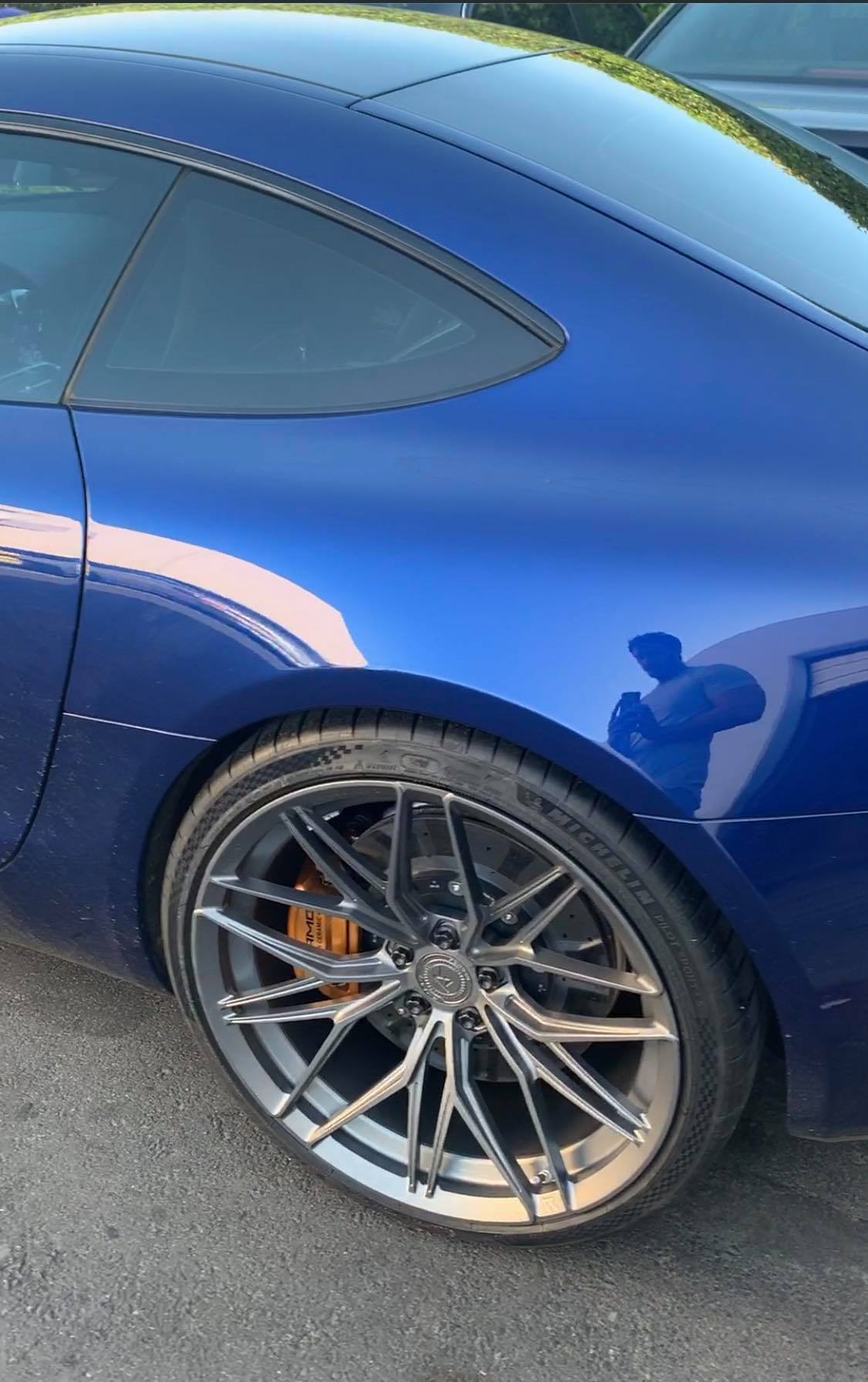

Here are some pics of how she sits today. I know the springs will settle in a bit, causing the car to get even lower.
Does it have to do with the fact that there are 19's up front and 21's in the rear? Suspension too soft? Too low? Tires too wide? Can we roll the fenders? My mind is racing trying to figure out a way to make this work...
I think I will have it raised a bit and would love to hear if anyone has advice on how to reduce rubbing other than reducing tire size (that will be my last resort, after I finish these tires).
Can I go 325/25/20 in the rear??? Would you?-qecjkw5.jpg
Can I go 325/25/20 in the rear??? Would you?-z4rpuet.jpg

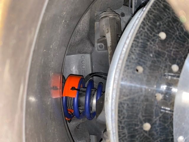

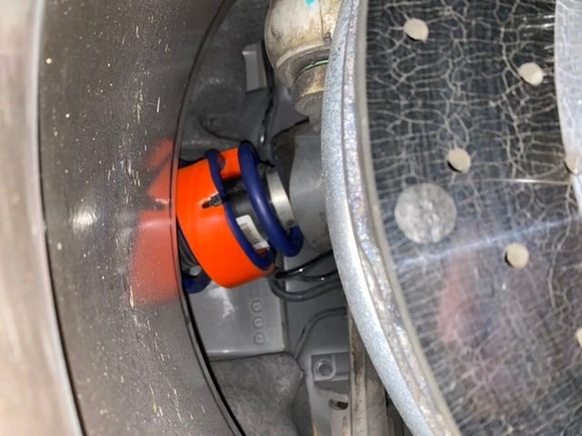

Here is a pic from mounting on my car yesterday:
I, too, was getting some rubbing over some medium to heavy bumps with my new wheel/tire setup and lowered on H&R. Now I really, really have to try to get it to rub over large bumps, dips at high speeds.
I was actually less worried about the rubbing before but more concerned that the H&R springs on both my factory and aftermarket wheels have the rear sitting about 5/8” lower than the front. I called H&R, and after looking at pics, they said this was normal. I think that’s ridiculous. Using the orange insert, it raised my rear about 3/8”. I’d consider using the red insert in the future to bring it perfectly level with the front.
Hope this helps. Worst case you’re out about $100, and you don’t like it. Best case, it’s a simple fix for $100.
I was actually less worried about the rubbing before but more concerned that the H&R springs on both my factory and aftermarket wheels have the rear sitting about 5/8” lower than the rear. I called H&R, and after looking at pics, they said this was normal. I think that’s ridiculous. Using the orange insert, it raised my rear about 3/8”. I’d consider using the red insert in the future to bring it perfectly level with the front.
Wow, this looks like it might be what I need! Thank you. Couple questions: Did you put it on only the rears? Also I think the quoted area I bolded was a typo, was the front or rear lower?
Also yeah I am very surprised about the rubbing given the gap too.

Yeah, that was a typo. The natural stance for the H&R is to have the rear about 5/8” lower (per wheel gap - not fender to ground) than the front. I only did this on the rears. No rubbing on the fronts from what I can tell.
