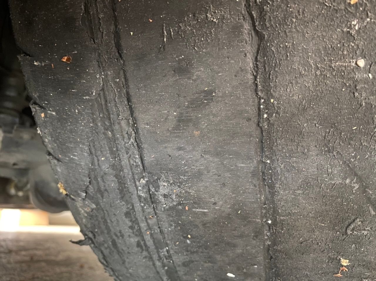

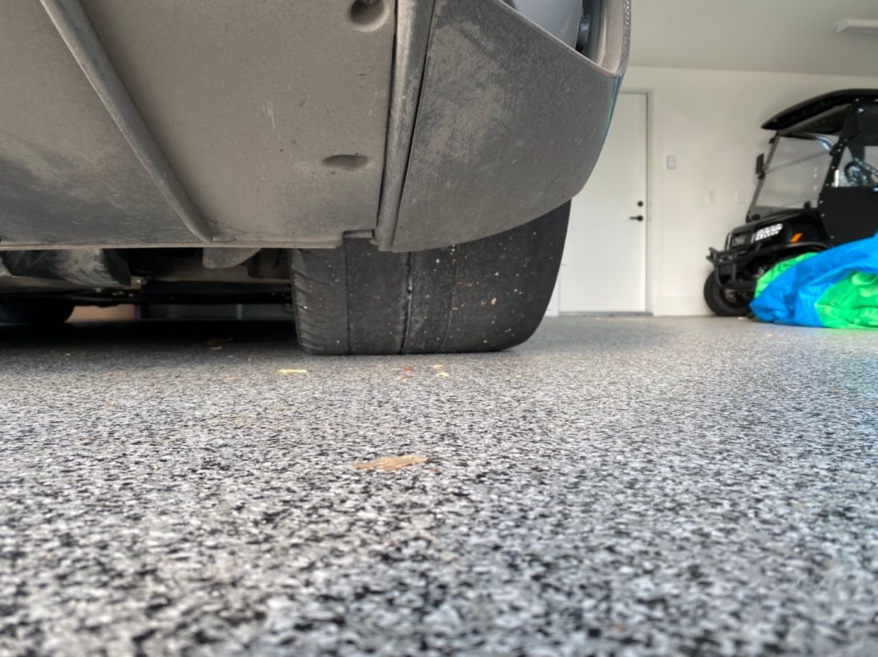

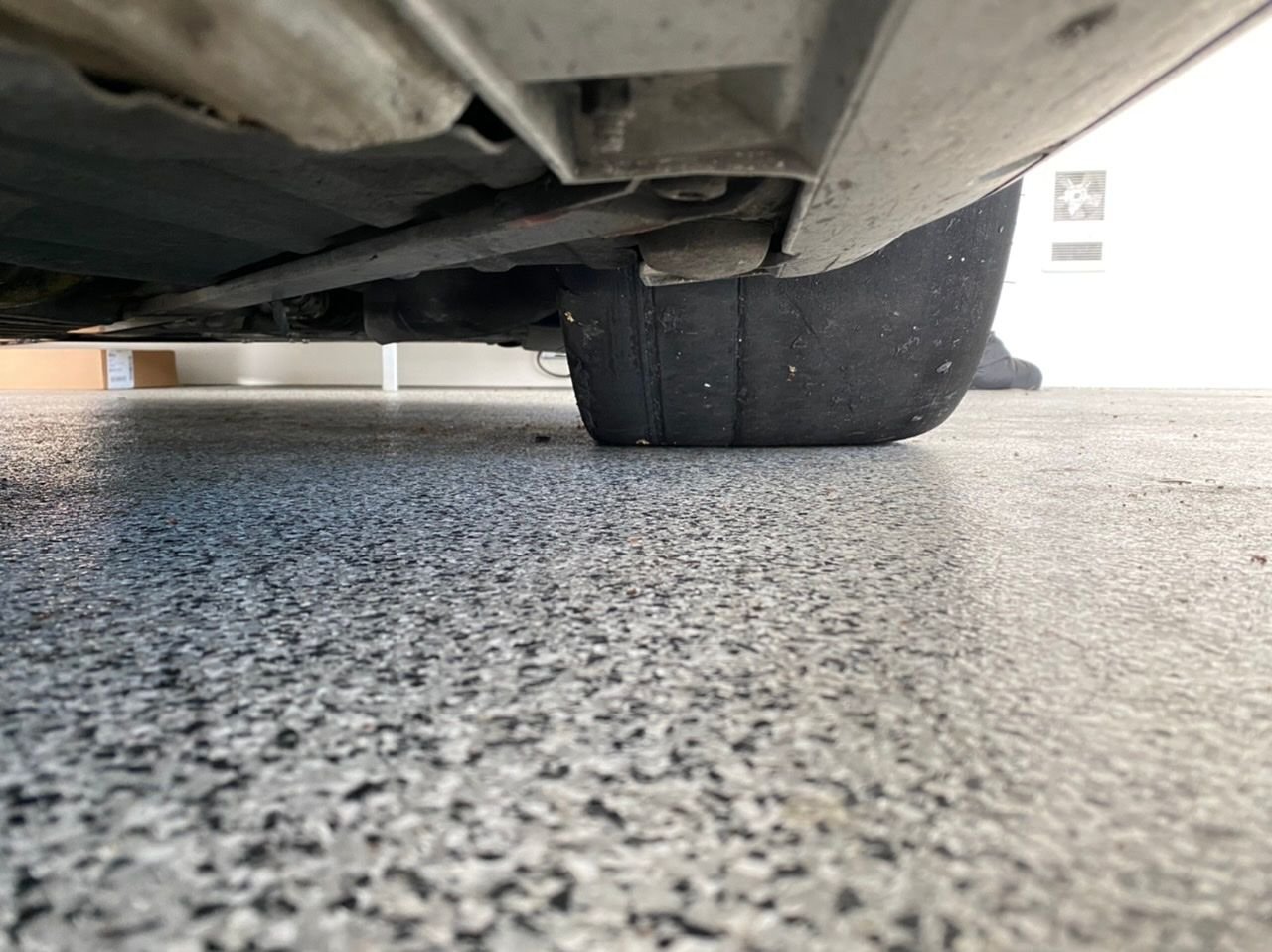

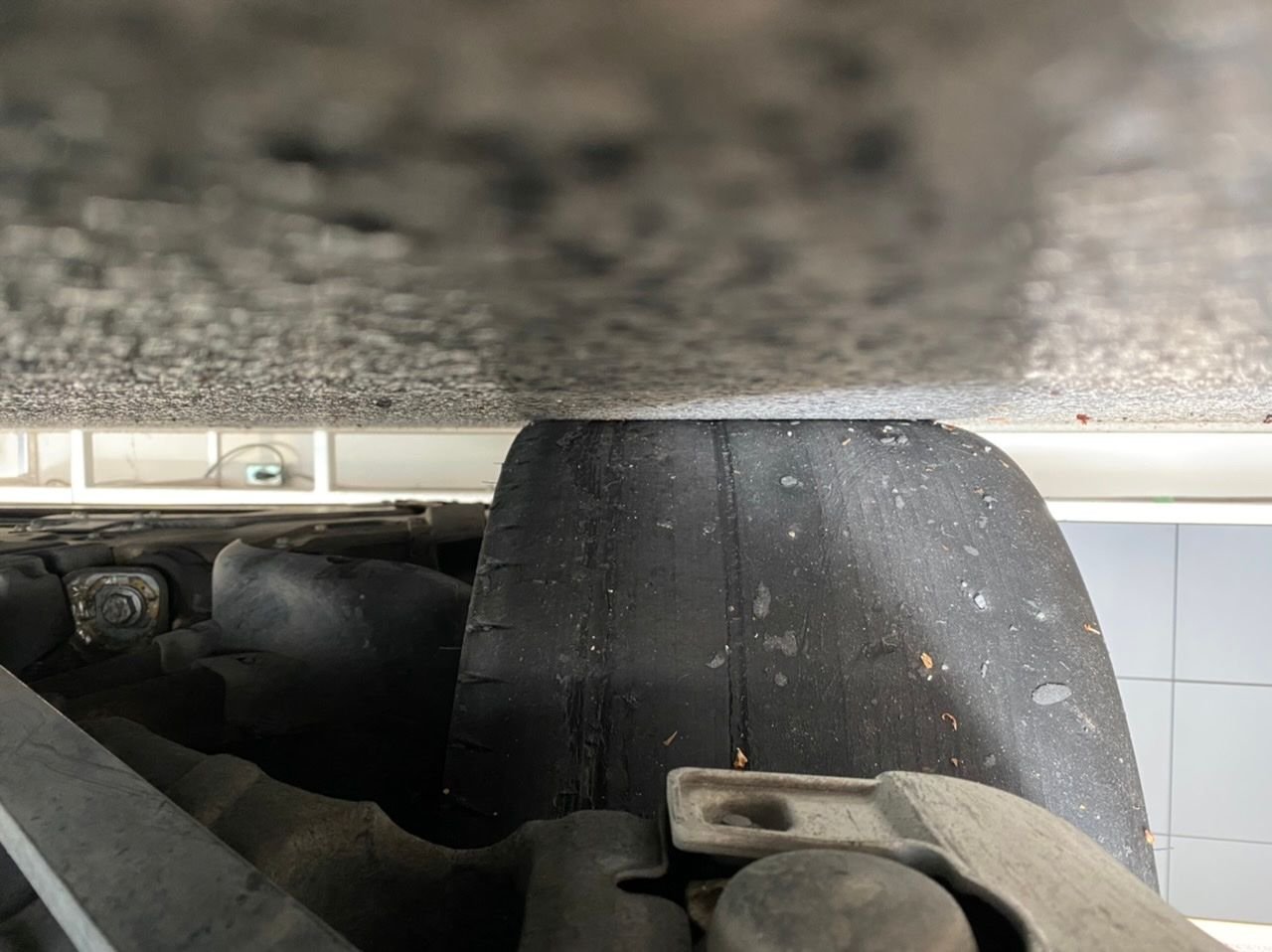

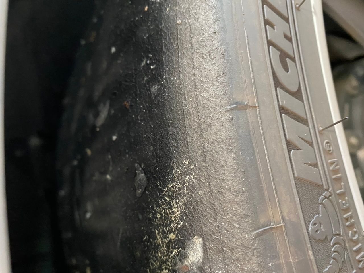

Track tires

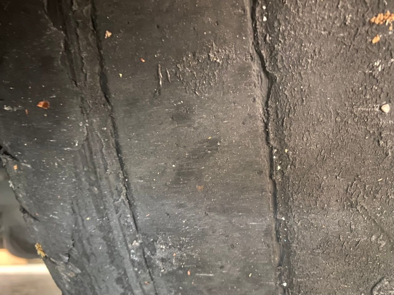

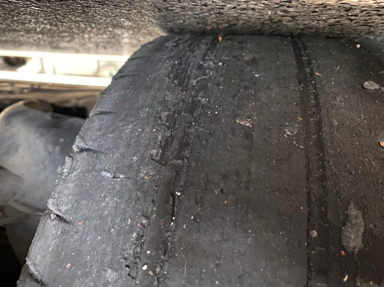

Anyone running anything different than cup2s or cup2 ZPs?
Sizes and why?
finished my ZPs today.

Can you post some pictures that aren’t quite so close?
ZPs can look like a hooker having the busiest night of her life, but still able to go another couple of rounds. In other words they look like they’re toast, but if there isn’t any intrinsic tread damage as recently posted from our colleague in PR where the whole centre block was delaminating, the tyre can easily tolerate another track day or two. With vigourous driving the outer tread block delineation essentially disappears, just leaving the inner two radial lines. Also, the tyre picks up rubber debris like mad which again makes it look like it is shot. Wiping them down to remove the picked up debris when the tyres’ been hot can change the looks of them quite a bit.
What were your cold/hot pressures? There is one picture showing that you maybe were ‘rolling over’ on the tyre too much which could be from too low a psi.

Tried to keep the psi around 32-34. One session I started too low and maxed around 30. Another session (first) they crept to 37/38 but I came off.
Last two sessions the grip was non existent compared to the start of the day and when they were new. Last laps were 2-3 seconds off my best laps. Did 5 20 minute runs but 2 I cut short.

Honestly to me they look exactly how a ZP put to hard use normally looks. I would say that you should at least get another track weekend out of them. Many guys on the Corvette forum run them until there is zero ‘tread’ gap showing.
As for grip: they don’t take kindly to a very fast lap when cold; it’s best to run at 7/10ths the first green flag lap and then go ***** to the wall. Also, they always get ‘greasy’ around lap 8-9 of a 2-2.5 mile circuit.
I would also keep playing with tyre pressures. With my local track which is primarily an anti-clockwise circuit I would generally always run with 1 psi less in the right front versus the other three tyres to try and keep all of them around the 32-34 psi range at the end of the session.
There is no doubt the ZP is a compromise: it’s fast, yes, but also very heavy due to being an RFT; hence it generates lots of heat. It is the only track tyre that allows you to drive to/from the track however. Ultimately getting a second set of wheels and running the R7’s is the way to go, along with a rollbar and belts.

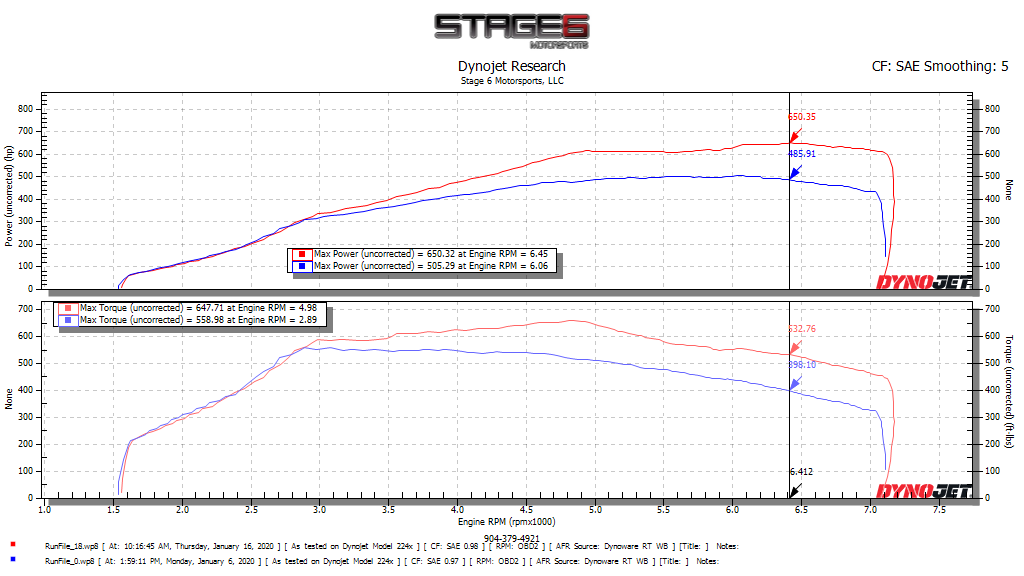

2016 AMG GTS with Weistec W.3 ... it made 650HP and 645TQ to the wheels on a Dynojet Dyno in the Florida Heat. This is on 93 Oct the Blue lines are with the Weistec W.1

Link to tune? That looks great!
