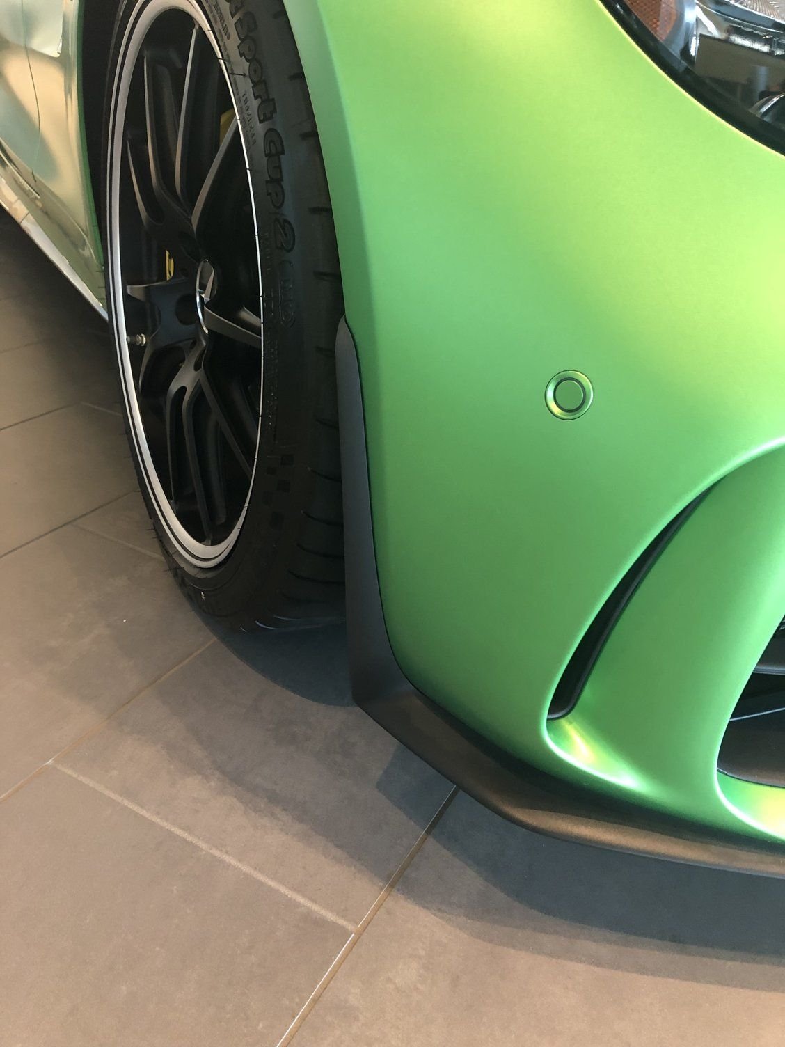

I will just put wheel spacers in the front imo...
And the 2 plastic flics from the 2020 gtr👌
190-885-15-03
190-885-16-03
190-885-15-03
190-885-16-03
Awesome! Can you do a HOW TO on how you installed the front side fins? I want to do the same thing and want to know how to get them to stay...
Old May 24, 2021 | 04:11 PM
mbjj57's Avatar
Joined: Mar 2017
Posts: 372
Likes: 97
amg gtc 2020 bk
it is easy to install, 3 m tape and self tapping screws..
