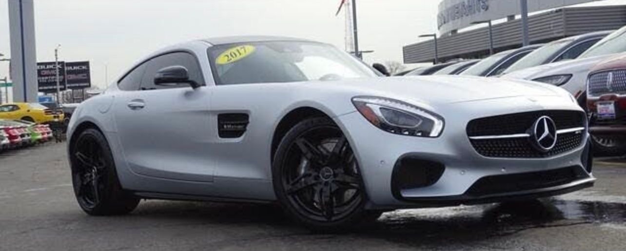

Hi everyone. I was wondering is there a website that someone can link me that offers a grill swap for a 2017 gt coupe to purchase from? If possible? I am not even sure if you even can grill swap the front grill of this car. I am looking for the new vertical grill seen on the 2018+ models. I provided pics of an example car that I would potential do a grill swap on. I am not a fan of this type of grill and am a huge fan of the newer grills and was just curious if this was even available. Any advice helps.

You have to look for the whole front end assembly of a 2018 GT and even that requires some body work to make it adaptable to 2016-17 models. There is a grill with vertical louvers that fits in the space of this model but that is a compromise and not a true Panamericana grill. Do a search for Panamericana grill. It is discussed extensively here.

do a search for grill or panamerica grill, here are a few, there are retrofits, but not everyone loves them since in the pre-face lift bumper mouth is not as wide, the "retrofit" grill ends up being upside down compared to the facelift grill. Some folks have swapped the entire front end...
https://mbworld.org/forums/coupe-roa...6-amg-gts.html
https://mbworld.org/forums/coupe-roa...onversion.html
https://mbworld.org/forums/coupe-roa...na-grille.html
