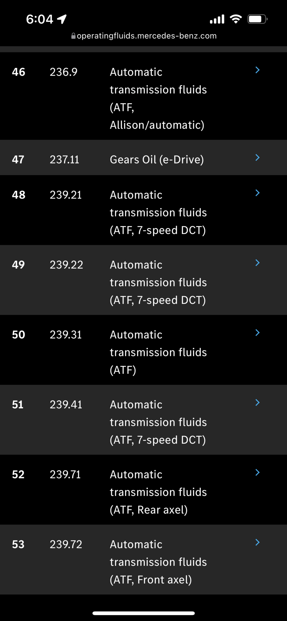

Have you used the operating fluids site? Former bevo site.
I would buy it from the dealer.

The MB BeVo site lists Shell TF DCT-F3 as the transmission fluid for the AMG GT. But try to find it.

What about calling the dealer? MB part numbers are listed on the operating fluid site.
