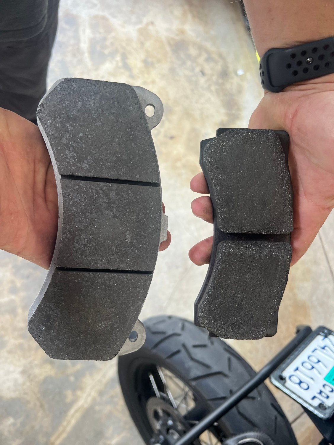

Do NOT use AP “kit” on car for track duty !!
I was so happy when I found a “kit” that allowed me to use my amazing AP calipers from my C7Z on my new AMG. cars are nearly the same weight. those brakes gave me insane stopping power on that car so what could go wrong ?
*** AP kit was for a C7Z , they don’t make one for our car. Someone makes an adaptor for that kit to work on our car ***
I didn’t actually see them side by side before having them put on or I would have known this was a huge problem. 🤯
Two track days two sets of pads. Same
results. Inadequate stopping power. Brakes got hot , boiled fluid and had soft pedal. Frustrating. Pads were shot after one day. I have Tikt cooling ducts in the front. I was hitting 132 mph at Laguna and couldn’t not go any faster or I wouldn’t be able to stop in time. My C7Z o was hitting 139 mph and wishing i was a few more MPH faster. I’m actually shocked i was running 1:39 lap times there with ****ty brakes like this.
Was told by the place selling the kit that maybe I needed to burnish pads better or try a different compound……. umm nope that isn’t going to fix this issue sorry.
After a long talk with Girodisc I decided to get their new rotors made for factory CCM calipers. So I can now see very clearly the issue. Pad looks about twice the size !!! No freaking wonder it wasn’t working properly.
So here you go….. moral
lf the story. Stick with big brand names
for brakes. This is probably obvious to most. I assumed incorrectly as did the maker of this adaptor that similar weight car they would work fine. Wrong.
Yes those were the front not rear pads from C7Z AP kit next to the Girodisc pads. 😳🤯.

AP Racing has never made one of their Radi-cal BBKs for the GT-R. I asked Jeff Ritter at Essex as soon as I bought mine but there just wasn’t enough profit in it given the low numbers of units that could be sold I’d guess.
You used a third party adapter, (not APR) to try and use your existing AP Racing kit from your C7 Z06 on the GT-R? Thank God you were only boiling brake fluid as it could have turned out to be much more costly.

Yes i thought I clarified that in my post. it is NOT an AP kit made for our car. it’s a adaptor a third party made to use on that AP kit for our car. I had no idea it was such a mismatch. when i got the car I had them put the kit on before even picking it up so i never compared. I very wrongly assumed it was appropriate for our car. similar weight worked amazing on the C7Z. the person making this adaptor certainly should know it was WAY undersized. 🤷‍♂️. Clearly i should have been double checking more carefully. and not trusting that people would engineer it halfway decently ….
agreed. Lucky. If it wasn’t such a well made brake kit and pads it would have faired a lot worse.
Pisses me off when people make things improperly or totally wrong /dangerous for the end user. This never should have been sold to anyone intending to track the car. Hey around town it was great …..

Yes that’s the one. Told them I had GTR. Shouldn’t matter. No way it would work properly on either platform with real track use. Maybe a novice driver or street driving it would be okay.
I have contacted them and asked to return it. It was not properly tested before being released to the public. Nice idea but dangerous end result.

I bet that Essex Racing as the official importer of AP Racing equipment did not sanction this at all.

definitely did not. Said they did track test them …. “every track has different braking requirements “ while that may be true these are not ready for prime time. not even close IMO. Sure a novice driver may get away with them or street warrior. Boils SRF fluid in first 20 session at Laguna Seca driven decently.
Said i can return but can’t offer a full refund since they are used. Fine with me. just want it in my review.
Most importantly don’t want others to follow my footsteps.

Hey how are your brakes doing? I just purchased a GTR and I ordered the same setup from Girodisc. Since we both go to LS I'd like to know how they're performing.
Old Sep 21, 2022 | 05:45 PM
dllhg's Avatar
Joined: Feb 2013
Posts: 1,212
Likes: 228
From: Norther CA
2014 cls63 a amg. 2018 AMG GTR
hey. they are performing quite well thank you. two track days on them so far. Jeff Cool tan a session on them and got a 1:34.1 with zero fade of lack of braking. i was hitting 137 mph he was hitting 139 zero issues. 👍. proper brakes for this car. feels great.
also they aren’t noisy around town which is a huge plus
