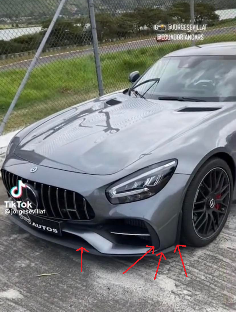

Hey all,
I'm trying to identify the factory 2018+ facelift GTS/GTC/GTR front aerodynamics package lip. Does anyone here know the part number for it? I can't seem to find it anywhere.
Thank you

Only available on the GTC with a sport aero option:
left spoiler : 1908858501
right: spoiler 1908858601
center spoiler: 1908857901

As far as you know, if I bought these five parts, would they fit onto a GTC front bumper that didn't come with the sport aero package? I want something to add to the front bumper, but am not the biggest fan of RW Carbon's only CF spoiler option.

fits like it was made for it (it was)! I did this to my previous 2018 GTC Roadster - it wasn't an option for the Roadster.
