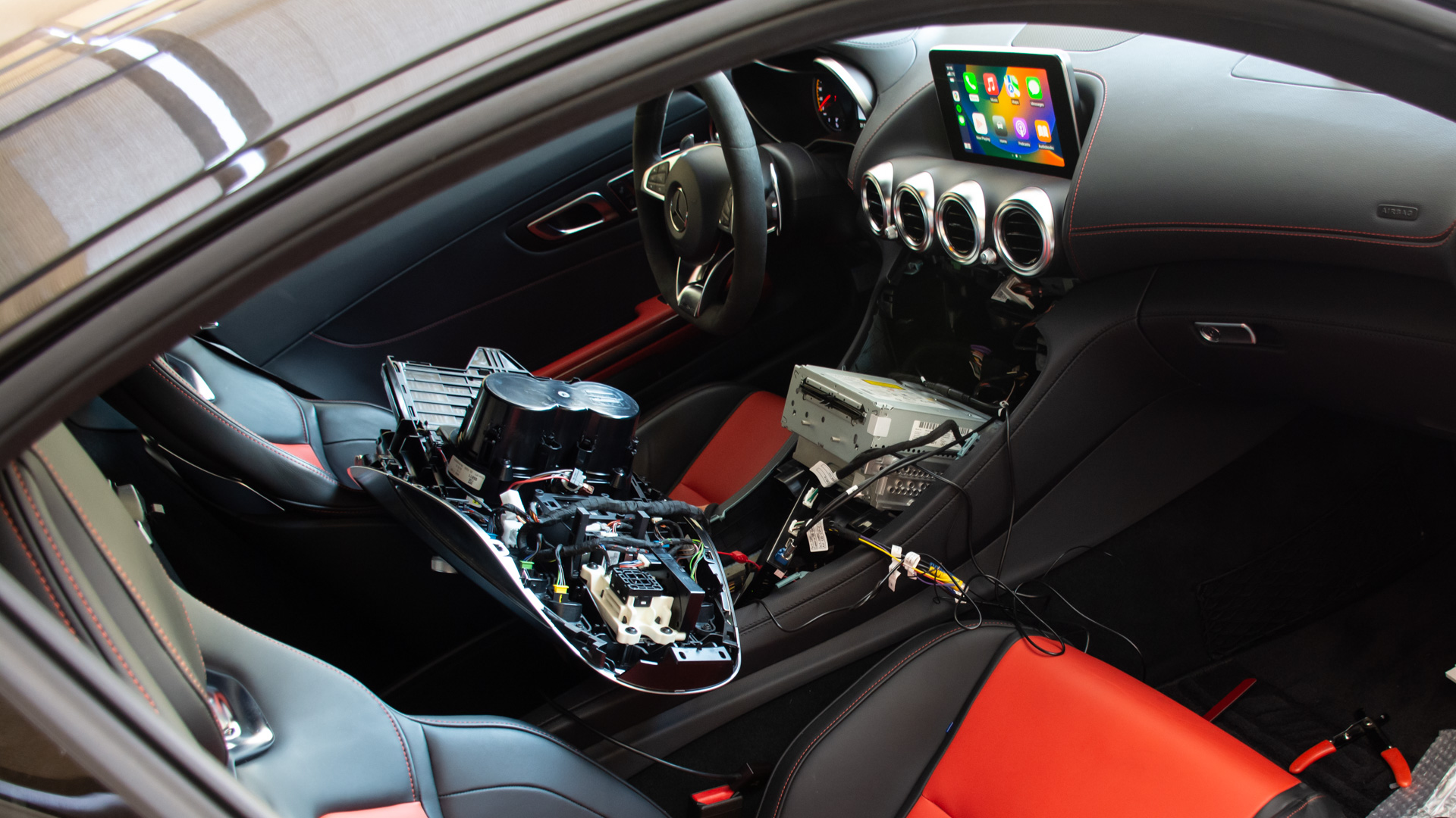

Installation of that thing is a pure pleasure, in comparison to W222 or W205 to be honest. The center console is held in place by 2 screws, accessible from within the armrest (hidden under a small flap). There is also a LOT of room to store the unit under the center console (mine is literally below the control knob). I was really surprised to see how roomy this center tunnel is. Again - in comparison with C class, that does not have any room at all there OR W222, which (if you have a secondary AC unit there) is a half day job to get to the console in the first place...

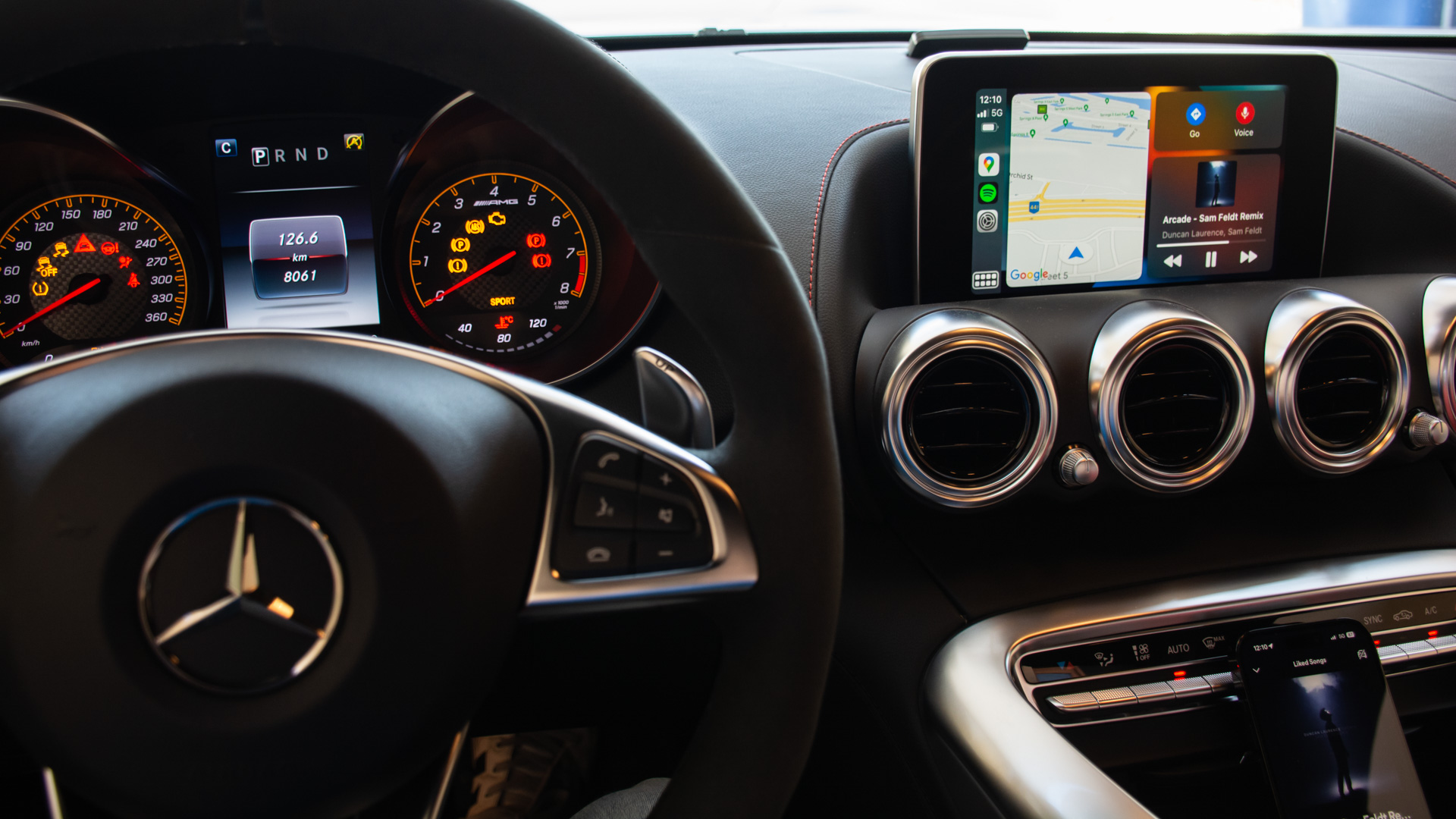

I'll let you know later how stable this thing is, but for now I am expecting no issues. With Android Auto mode it was a hit-or-miss (OnePlus worked flawlessly in AA mode until Android 11 was released and AA became part of the OS, then I fell back to cable connection as WiFi was always cutting; Pixel 6 works wirelessly without *any* issues, Samsung S21 - also depending on software level, but it's been having issues with AA for a long time - even wired one - and Samsung did not hurry to fix it).

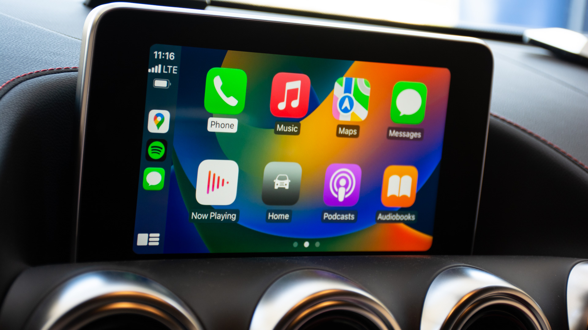

This is my first attempt to use IOS Carplay, so I am still not that aware of what works how and how better is it from AA... So far the pairing process was much smoother than AA - just turn on and wait couple of minutes for prompts to happen - done. Screen on. Music is playing... And the quality of UI seems much better than on AA. Even google maps looks better on IOS - animations when you select the destination and press "directions" are just lovely - not available on their native OS - shame!

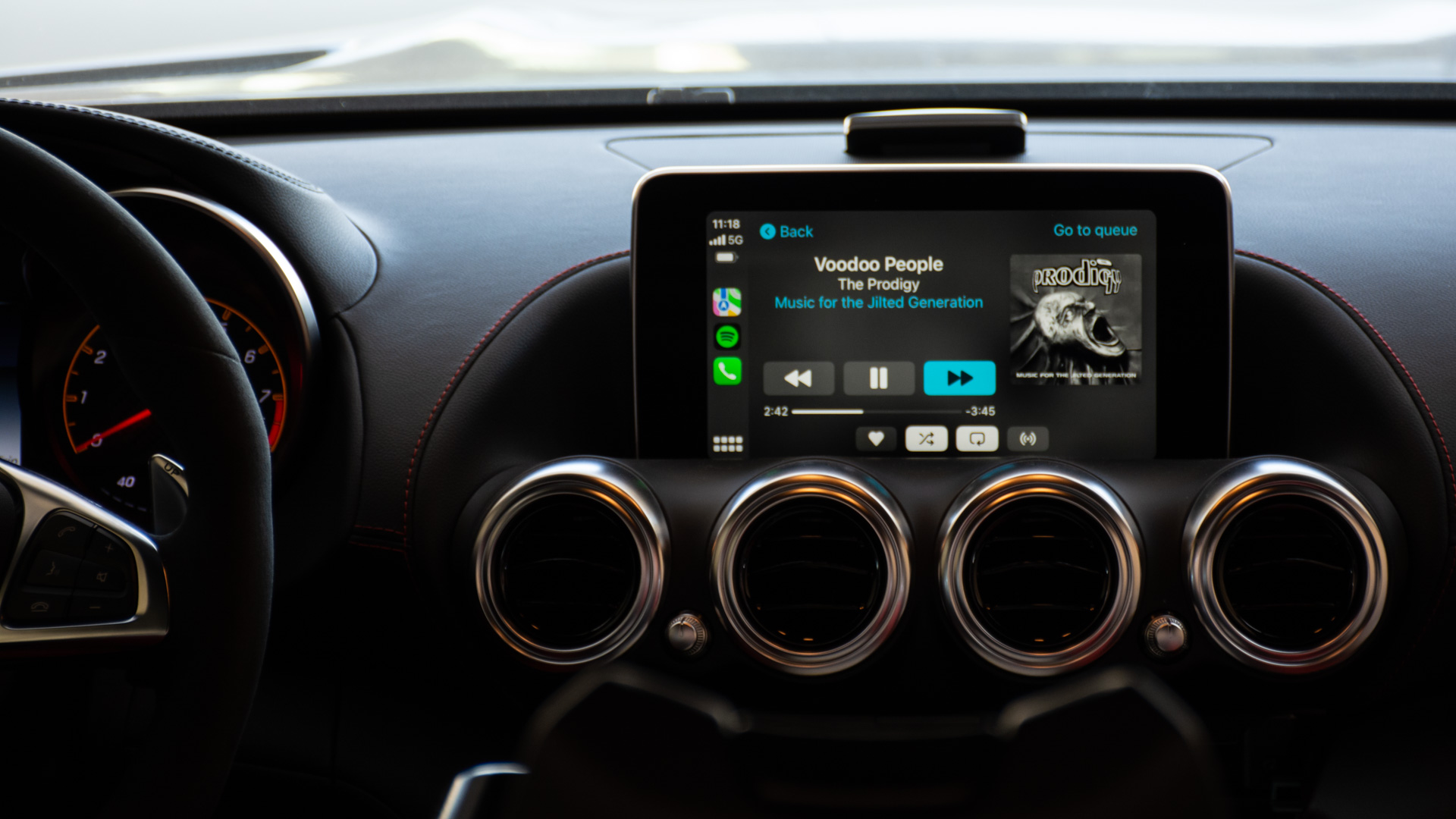

To make this solution perfect, they would need to master two more things:
- overlay of temperature/Aircon displays when in carplay/AA mode (currently you don't see that on this display, need to switch "back" to OE display to adjust temperature and fan settings)
- make a mode where FM radio would work with navigation prompts (you get the audio via AUX, so today it's either/or - some people actually install a secondary speaker to have google alerts vocalized during FM session, but this won't allow you to use spotify anymore on main speakers since there is no more aux passthru here in this scenario and you are stuck with FM or CD - bluetooth audio is blocked by your phone is in Carplay mode)
None of the above bother me, because I keep temperature on Auto and never listen to FM radio, that's why I keep coming back to this solution...
