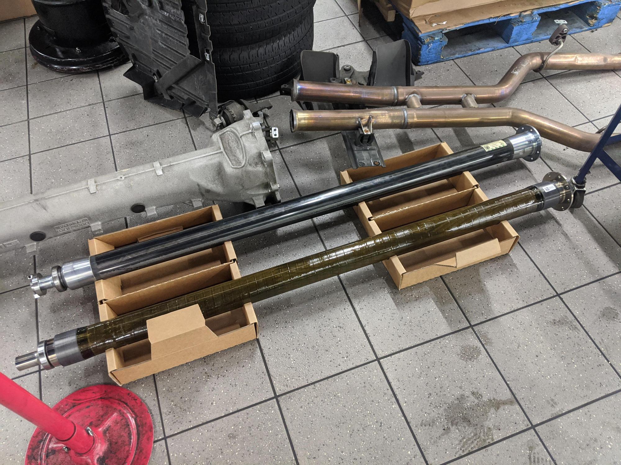

I occasionally got misfire codes, and it was resolved with the driveshaft recall. My tech told me it has to do with the sensors freaking out when the driveshaft starts slipping and things don't match up.

AMG
Originally Posted by user33
Curious ... how does a driveshaft "slip?"
The carbon fiber drive shaft starts slipping inside of the collars, which is why there is a recall for them for early year model GTSs.
Thanks ... makes sense when you see the end/collar pieces. You'd think there'd be an inside thread that was self-tightening (for forward gears) and was tightened to pre-stress during the assembly/glue process (threads would also provide more surface area for glue ... but likely require thicker shaft-ends and collars). Of course, that'd assume breakage would always occur in forward and not reverse gear(s). #;-))
Agreed, here is a side by side of the old one (top), and "improved" one (bottom). I chased misfire codes for a few months, before getting the recall done. I was also shocked that there was any correlation.
