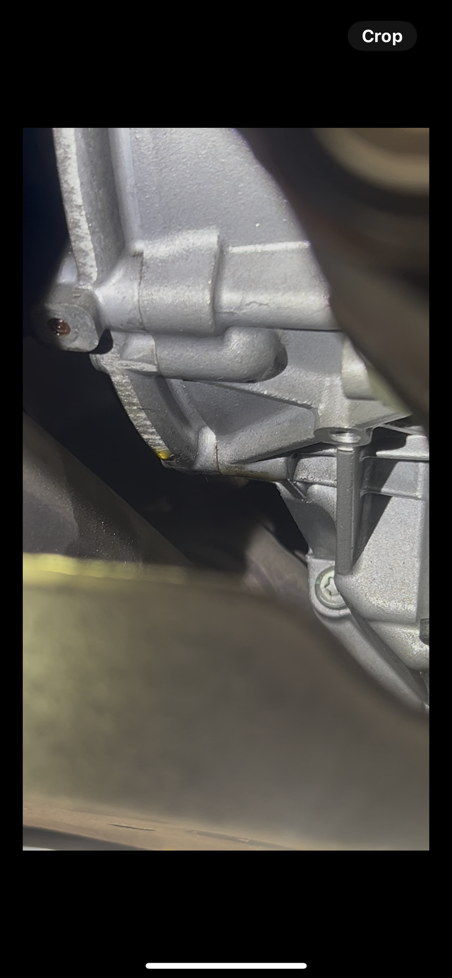

Gtr 2019
Guys my gtr 2019 has 33km dealer maintained and transmission fluid changed 3 months ago was going to sell the car last week we put the car for inspection and suddenly I found this…… what do you think

Quote: Guys my gtr 2019 has 33km dealer maintained and transmission fluid changed 3 months ago was going to sell the car last week we put the car for inspection and suddenly I found this…… what do you think
Ah that possibly looks like the infamous weep hole leak but prob best to get that investigated by a dealer or an indy who has experience with ferrari/getrag dct service.
is it just slight seepage or is it an active leak once you start the car? If the latter then that unfortunately sounds like bearing is failing.
Some more info on this thread: https://mbworld.org/forums/coupe-roa...ir-manual.html
really sad to see this on a 2019 gtr and kind of confirms that nothing was ever fixed in subsequent model years and that these transmissions are just ticking time bombs due to a design flaw from getrag.
please keep us posted

May 12, 2025 | 04:33 AM
yes, oil coming from that hole means that the oil seal that separates the 2 oils has broken

Quote: yes, oil coming from that hole means that the oil seal that separates the 2 oils has broken
Oh gosh, no that is not the "weep hole" leak where the transmission needs to be dropped to replace the radial shaft seals just inside the gear box. This is a leak from the differential cover. It's either a failed differential cover o-ring or the tiny o-ring that seals the channel between the casing and the differential cover. Refer to bulletin 2612 pages 25 figure 7 for the small o-ring, and page 26 figures 8, 9 and 10 for the differential cover gasket. Bulletin 2612 REPLACES 2076 12_2019 Getrag Remove Differential.pdf
Here, I made a video. I just happen to have my transmission apart.
