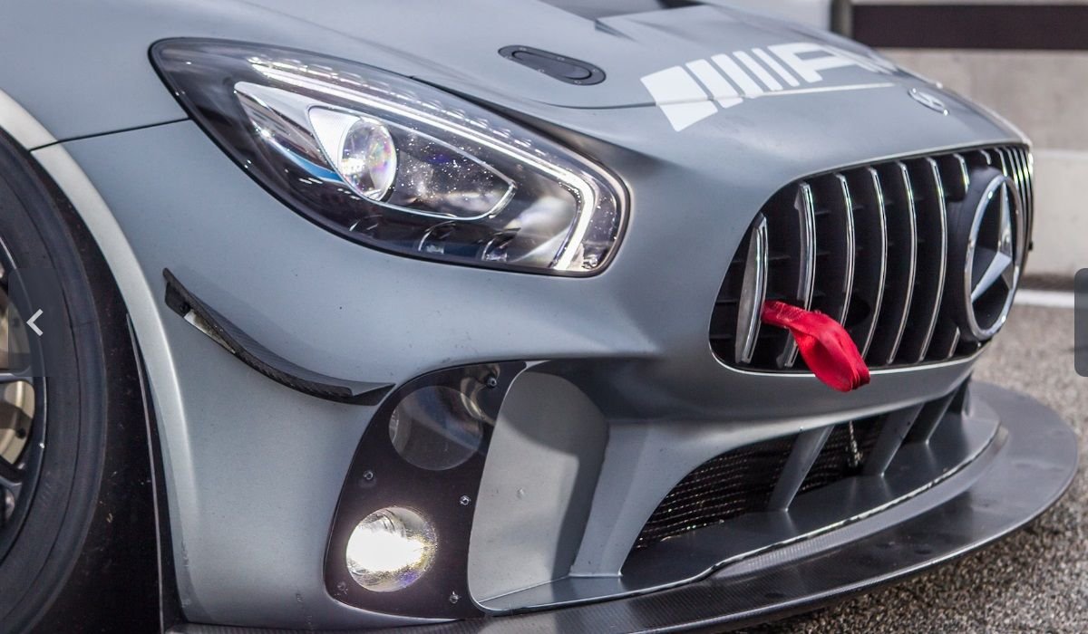

pics of the AMG GT4 aero for you.

Not fair to tease.
