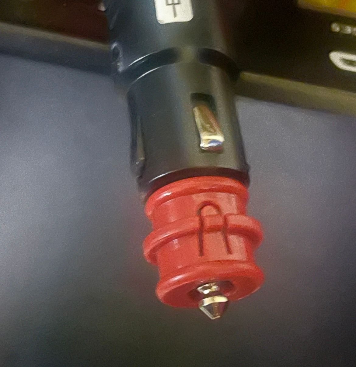

Do you have to remove that red cap from the 12v plug even though it doesnt really seem to click with or without?

This one? Just leave it on the plug. It will hold the plug tight in the trunk's 12V socket.

@untamedd You can do this. Since I'm sitting in an electric wheelchair I have to do it unsighted and with one hand. It takes a bit of force to push the plug into the socket.
yes sir all good. I was just afraid of breaking it initially as ive never really used one before but all good and in trickle mode now.

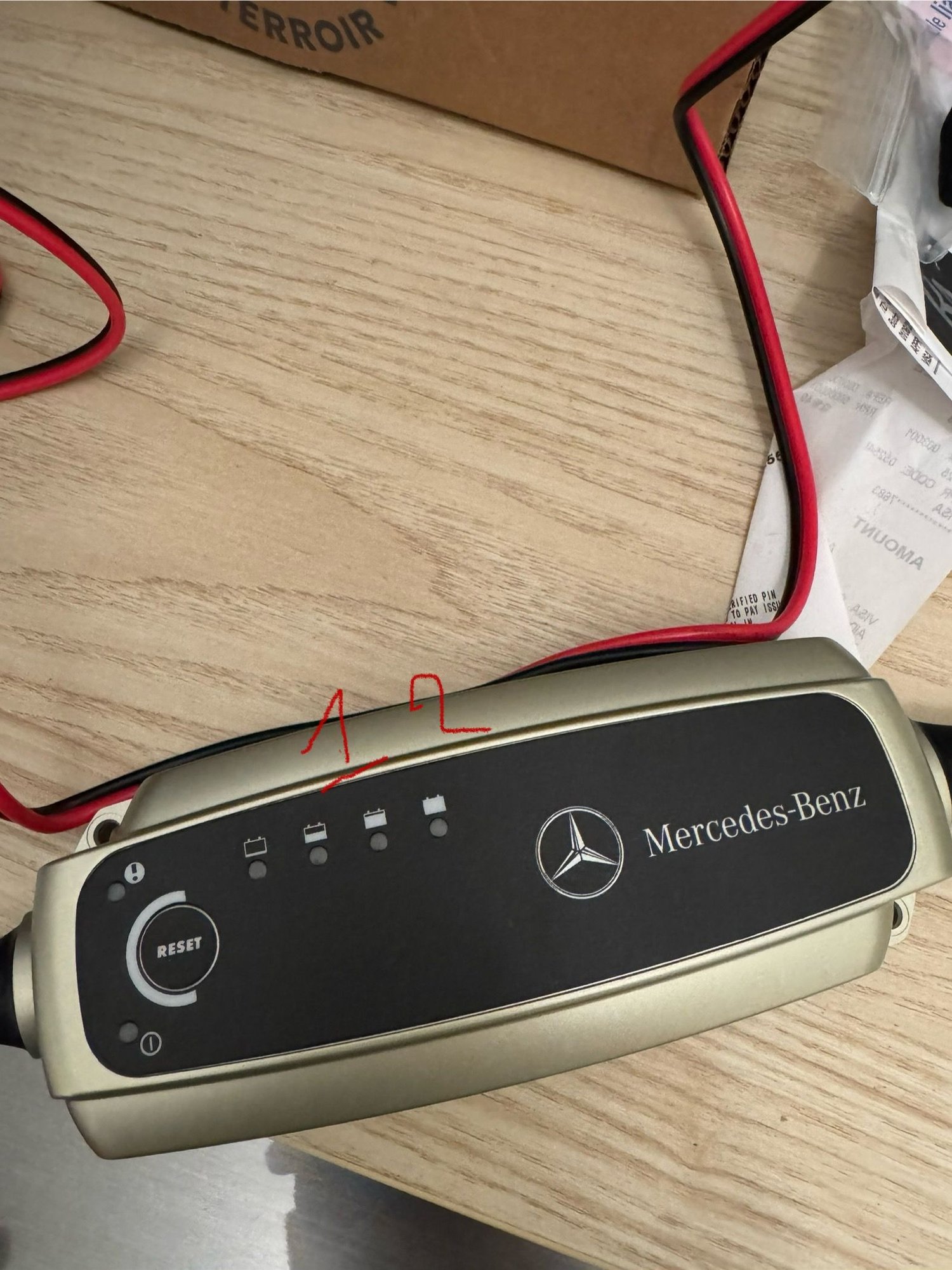

Hey guys, hoping someone can clarify expected behaviour from the charger as ive used it twice and observed two different patterns:
1) first time i used it, the third light lit up solid orange indicating battery was charged 80%. Left it overnight and next morning fourth light was lit solid green indicating a full charge.
2) second time i used it, holding the reset button after plugging it in, the fourth light blinked indicating battery was fully charged but then when i let go of reset, no light would stay on.
from my first experience, i thought that even if battery was fully charged, the fourth light would still be a solid green or is the expectation that if battery is fully charged, no light would stay on the charger? Thanks.
Old Apr 18, 2025 | 09:41 AM
GTConn's Avatar
Joined: May 2023
Posts: 312
Likes: 146
2019 AMG GTC Solar Beam Yellow
Try unplugging it and plugging it all back in. Seems I've had mine do that before too and that fixed it.
