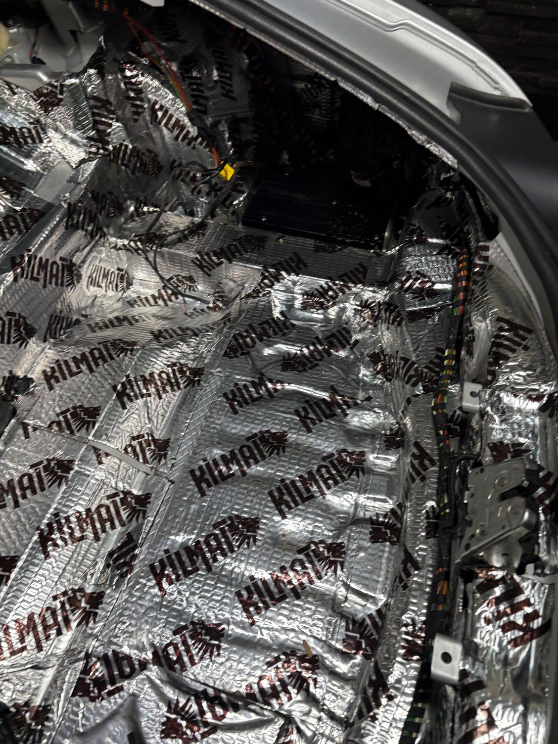

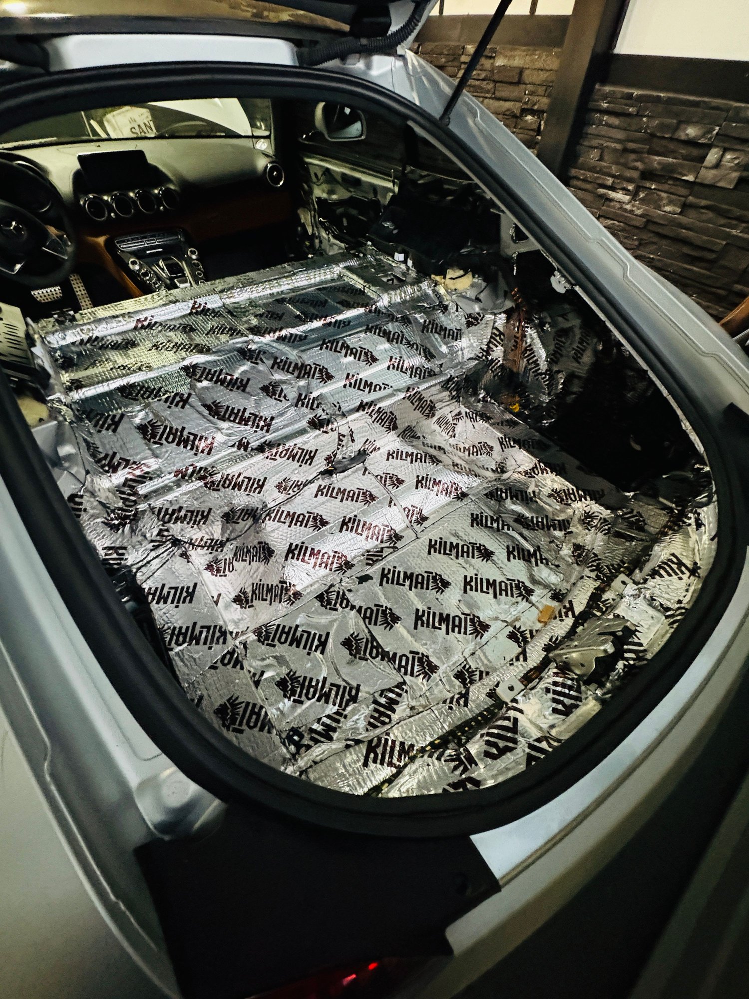

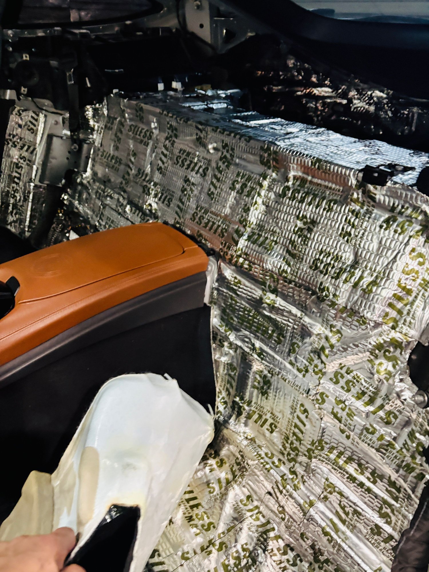

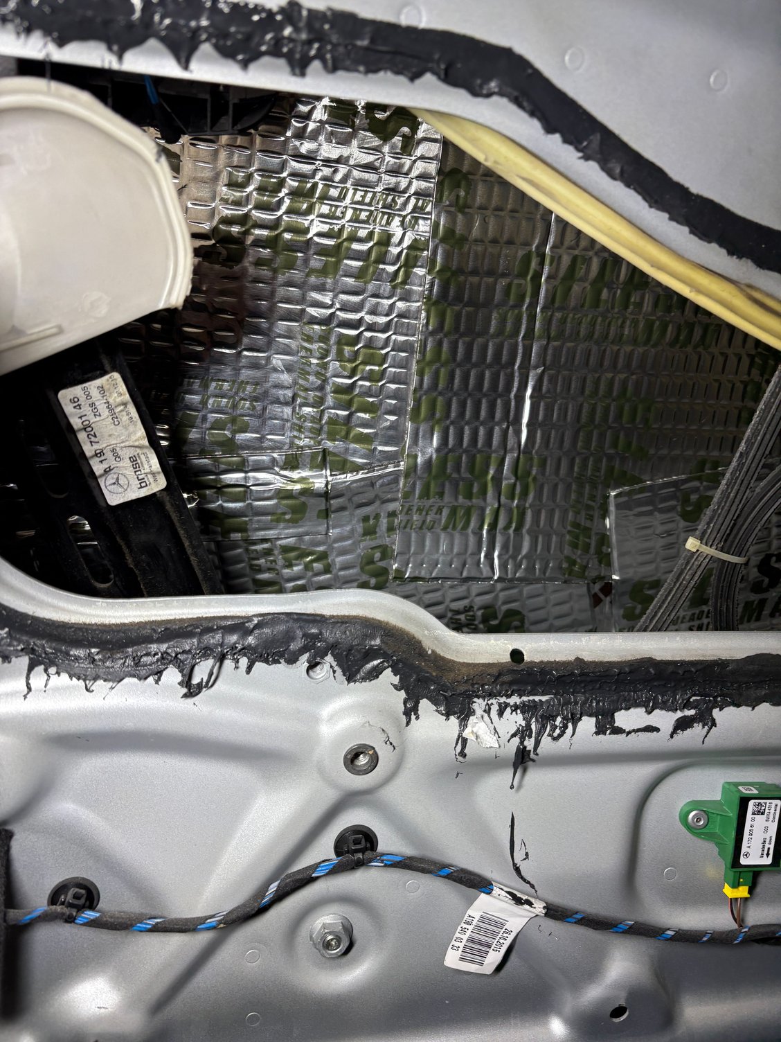

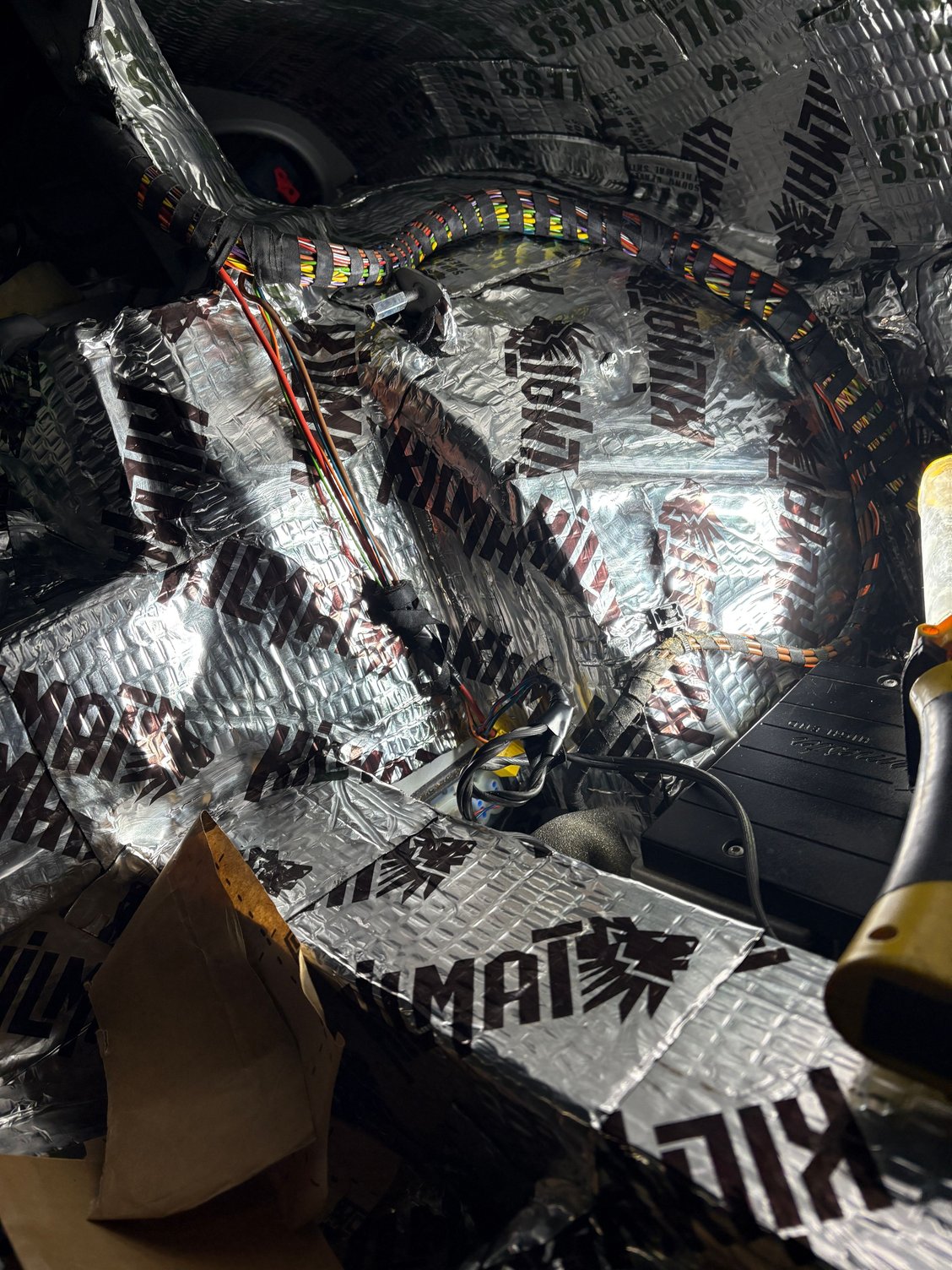

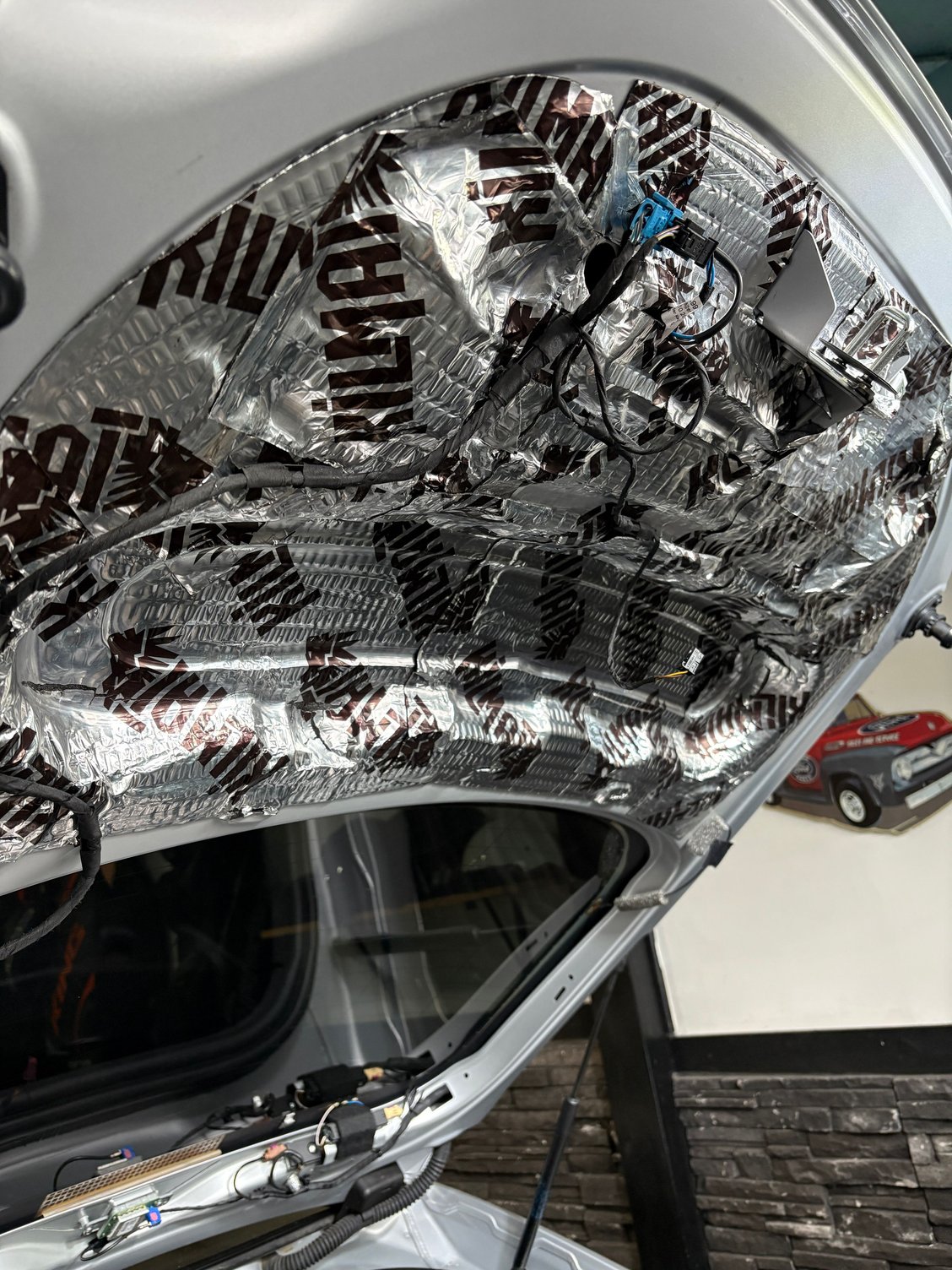

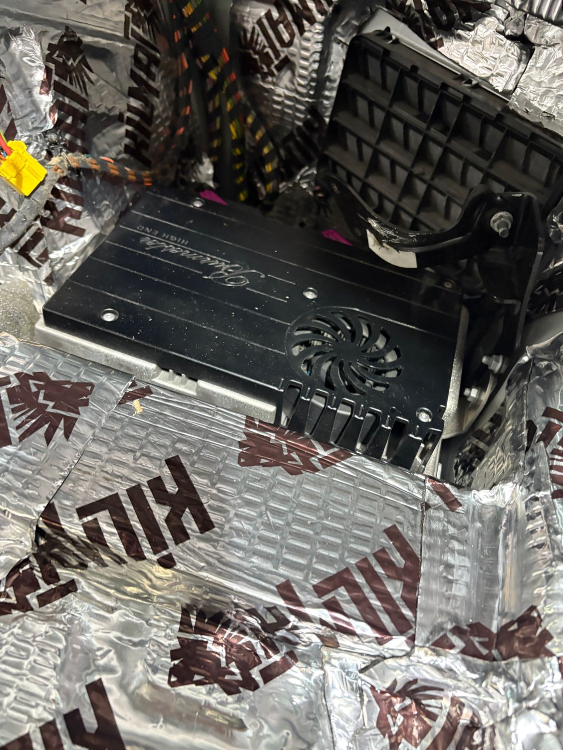

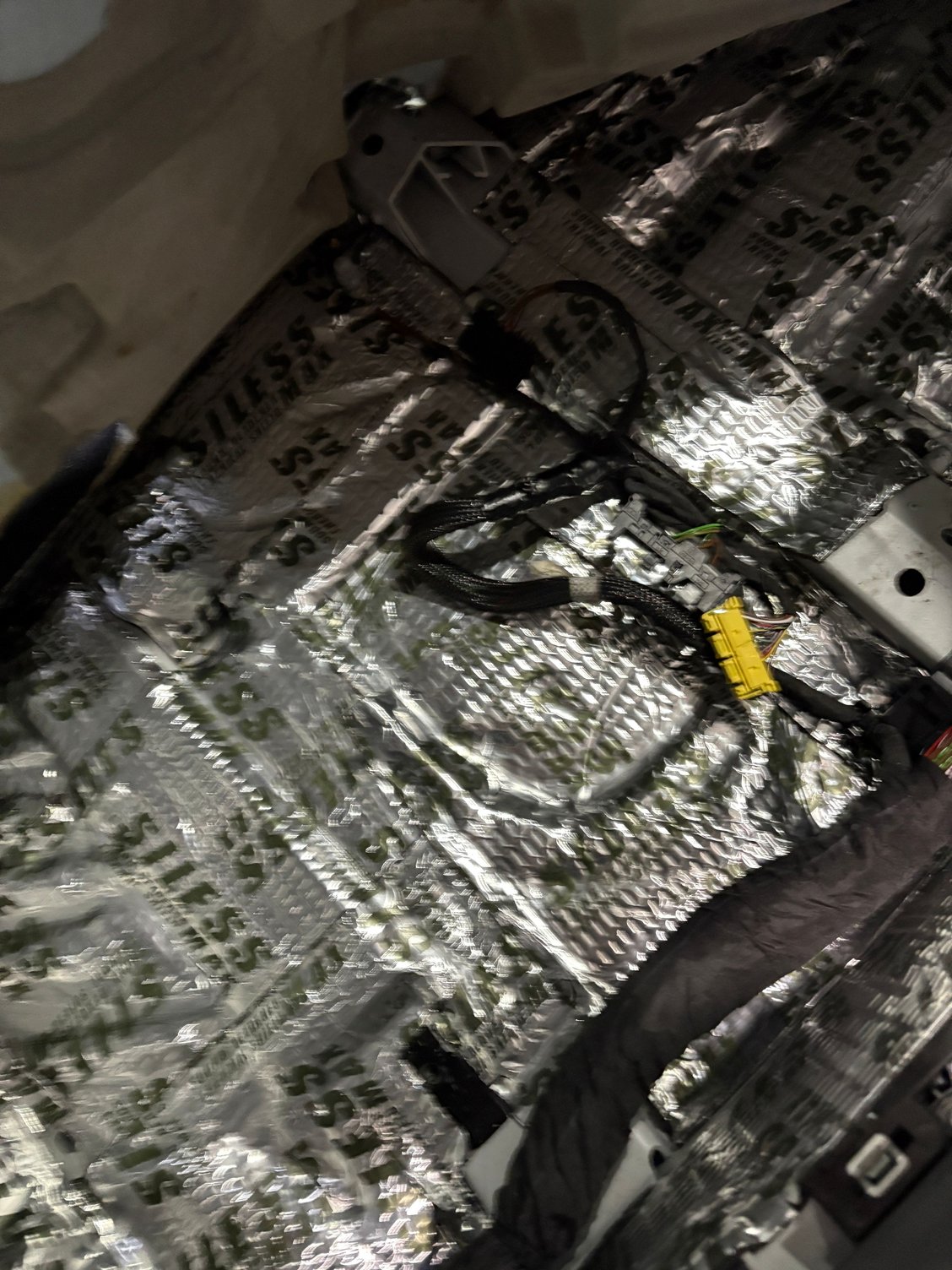

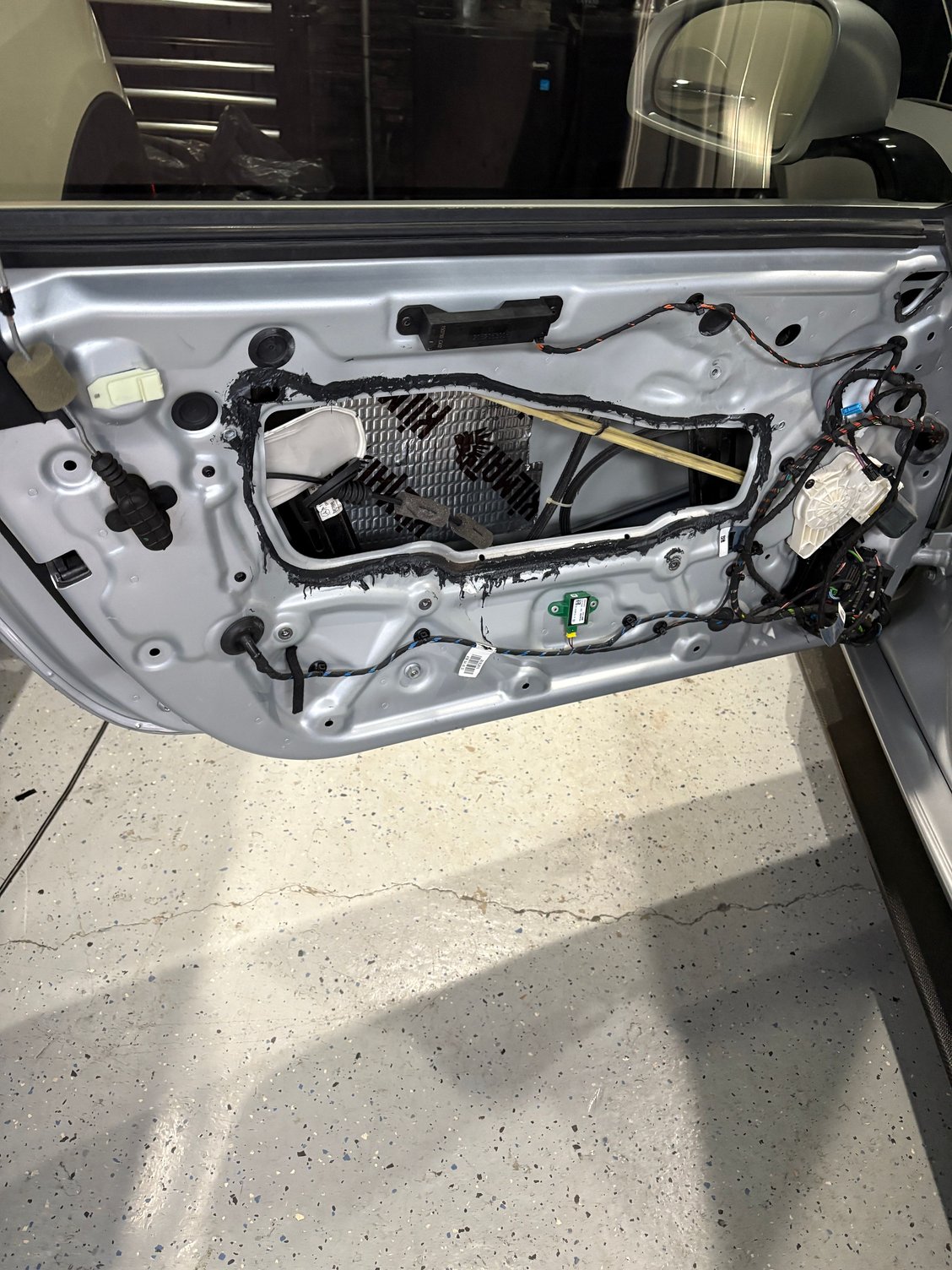

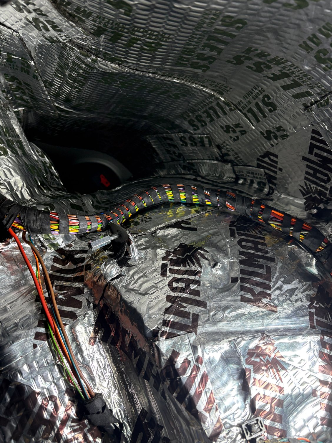

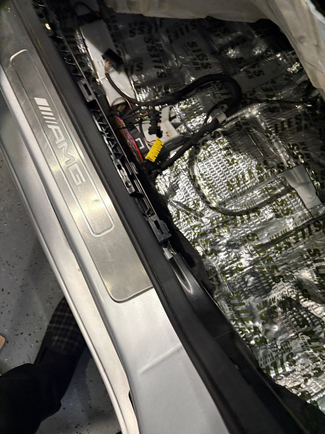

I really like this car but the road noise inside the cabin is really bad, so I decided to install sound deadening to most of the interior. Started with the trunk area and moved forward into the cabin.
Went with 120 mil on the floors and 80 mil on the panels etc.
Removed the door cards, most panels, carpets and seats, for the cabin I didn’t want to mess with removing the Center console but I was able to pull the carpet back enough to reach most of the floor, the doors I installed the deadener on the door skins.
Used about 95 sqf of sound deadening, I know I also added a bit of weight but to me it’s worth the trade off if it works, unfortunately I won’t be able to test it out until the spring because I store the car for the winter.
here are some picks.

Wow, that is like a major surgery, hopefully it helps a lot for you.

Nice clean install. That stuff can be a pain to work with!
It looks difficult but it’s actually very easy to take this car apart, worse part is the seats but even that’s not too bad.
Thanks, I am very happy with the install.
It was actually very easy to install, the glue only activates when pressed or rolled so there is plenty if time to position the mats.

Yup! Also put it in the doors to reduce bass rattle.

Thank you,
I used 42 sheets of siless 120 mil and 45 sheets of Kilmat 80mm
Total install time was about 26 hours but I took my time.
The only issue I had was with the subwoofer enclosure in the trunk, I installed a double layer of material in that area so that made it a tight fit, other than that I had no other issues.
Unfortunately I won’t be able to provide any feedback until the Spring, but I think it will make a huge difference, I can tell from the way the doors close, it’s a nice solid thump now compared to a hollow sound before.
