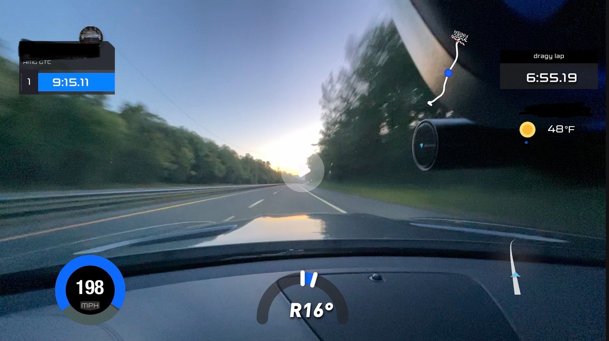

At those speeds, the GTC’s retractable rear wing was fully deployed.
I’m confident that raising the GTR’s rear wing to 10 degrees would negatively impact its top speed. While the GTR’s fixed rear wing and extended front splitter are excellent for high-speed cornering—by increasing both front and rear downforce and planting the car more firmly onto the surface—they also add significant aerodynamic drag. This added "weight" on a straight line doesn’t help; in fact, it slows the car down.
I did capture speedometer readings during several runs. When using 305-width tires (the GTC’s OEM size), the speedometer matched both GPS devices perfectly, with no discrepancies.
However, since the GTC’s speedometer is calibrated for 305/30ZR20 tires, switching to 335 or 345 series tires—which rotate fewer times per mile—will cause the speedometer to underreport the actual speed. For example, in the photos below, the speedometer shows 192 mph, while the GPS accurately reads 198 mph, running on 335/30ZR20 tires.
If you calculate speed based on approximately 6,550 RPM in 7th gear (as seen in the picture), comparing 305 tires (764 revs/mile) to 335s (744 revs/mile), the numbers align very closely.
So no—I don’t believe AMG is secretly helping us make our top speed case. 😊
Dragy-Lap app showing the actual GPS speed at the same minute 6:55.15 of the run
Dragy-Lap app showing the actual GPS speed at the same minute 6:55.15 of the run.

Interesting. Didn't know whether the GTC had the ability to turn the rear wing deployment off, or not.
Yes, I can confirm that full angle on the GTR's wing slows it down. I did a 1-session test and saw a difference on the long straight at Area 27 raceway.
That's the first time I've heard of a Mercedes speedo reading "dead on" (with the proper tire sizes). Every Mercedes I've ever owned has always shown a "protective speed skew" according to radar displays (a couple of them being of the "highly calibrated" kind <sigh> and GPS speed comparisons when on track. IIRC, when you do the math, the diameter/rotational difference due to full vs worn tread depth can yield a couple of percent difference. When you consider the diameter difference between different tire manufacturer's tires of the same size spec, you can see the problem for the car companies.

Just to clarify how the GTC's retractable rear wing works: you can manually raise or lower it when the car is stationary or at low speeds. However, once you exceed 40–50 mph, the wing automatically deploys and cannot be manually retracted until you're back below that threshold.
You're absolutely right about the general accuracy of Mercedes-Benz speedometers, but in the case of AMG models—particularly the AMG GT—I’ve found the speedometer to be surprisingly precise.
You also made a great point about how tire wear affects speed accuracy. Since I’m very particular (for safety reasons) about tire maintenance and typically replace them when tread depth reaches 4/32”, it helps keep my speed readings consistent and accurate, hence during the above tests.
