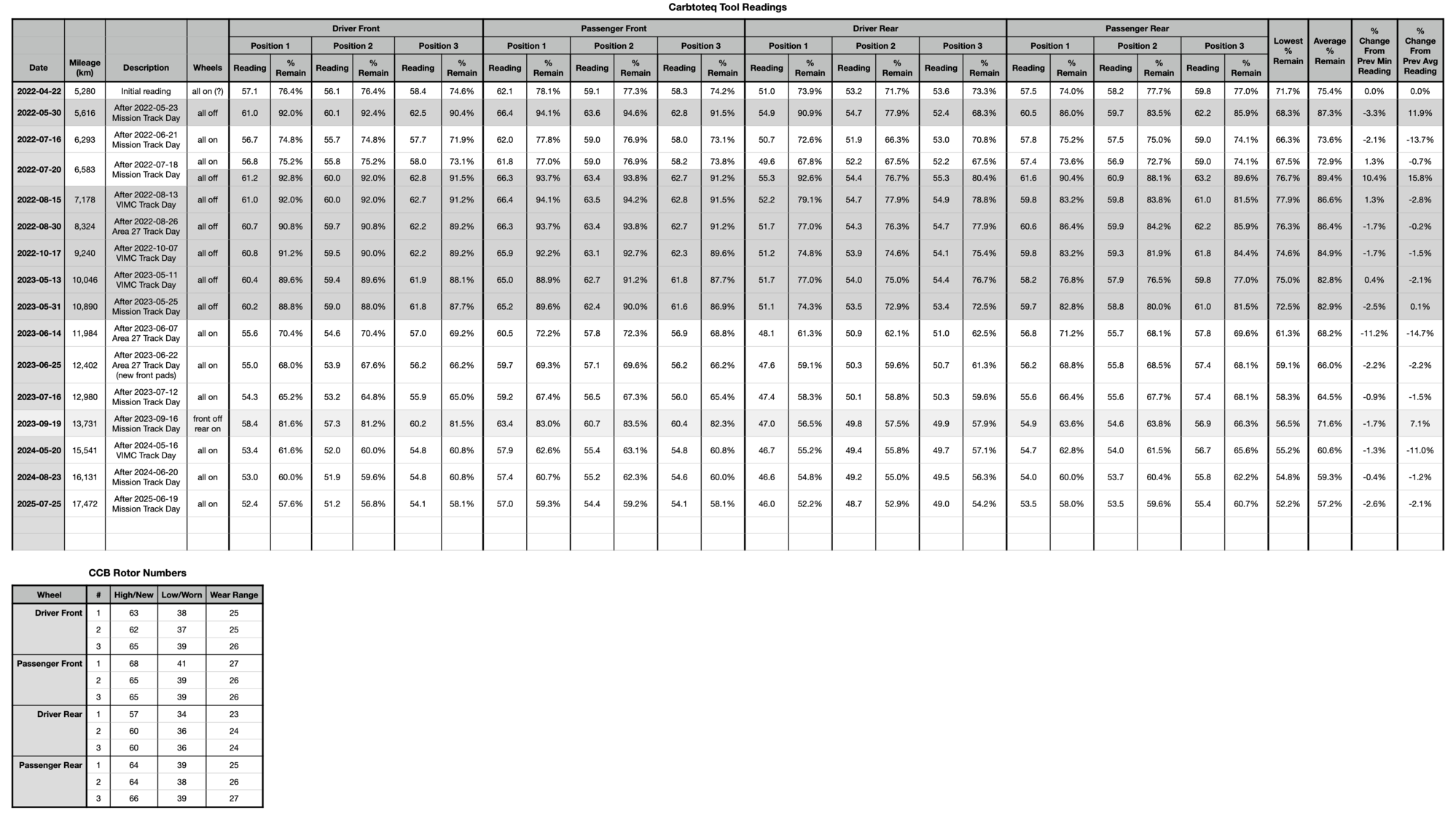

Some Real Track-Use CCB Rotor Wear Data
I do track days with my GTR Pro and capture tire, brake-pad and carbon-ceramic (CCB) rotor wear data after each track day. I have a Carboteq tool so I can get proper/accurate CCB rotor wear data.
Since I've accumulated enough initial CCB rotor wear data, I created a spreadsheet to help me understand the current (and future) data. I've attached the current data as a graphic and as a PDF. In addition to the track days that are on the measurement spreadsheet, there were 2 Mission track days run prior to obtaining my Carboteq tool (so 17 track days, thus far).
Track Notes
The 3 track characteristics are as follows:
- Mission : a short twisty track with 3 significant braking zones and lap times that allow little time for brakes to cool (it's known for "cooking" brakes) -- this is my "home" track on which I'm the most familiar/aggressive
- VIMC : a short very twisty track with average+ brake-wear implications -- it's very technical and I'm still coming up to speed on it
- Area 27 : a "proper" track at which I'm still very much a learner so probably average- brake wear (for me)
The car has the excellent TiKT brake-cooling ducts on front and rear wheels. This is important as it's heat that "wears" CCB rotors.

Results
As I've written in other posts, I've only found anecdotal evidence about CCB rotor wear with track use, but there are implications that CCB rotors (with good brake cooling) may last 40+ track days.
In the video
(at 5:25)
Opus implies that they got ~10K km track use from Black Series CCB rotors.
If you averaged 150 kph on your tracks, that's over 65 hours of track running,
at speed ... or 195 20-min sessions or, at 5 sessions per track day, that's
39 track days. So it seems like CCB rotors might actually be good for 40+
track days.
My measurements seem to be moving towards the same conclusion, assuming that the wear doesn't go non-linear at some point in the future.
I do see some anomalous readings in my data. Aside from the possibility of human recording/transcription errors, there's also the issue of the rotational position. Since building this spreadsheet and doing the material tests has helped me understand things more, I'll try to be even more precise with future measurements.
I've also found that it's important to apply the same pressure to the tool so it sits equally snugly against the surface of the rotor. Finally, there's the fact that any digital tool is (by definition) only accurate to +/- 1/2 of it's least significant digit, so there's always that variance.
Still, it's nice to finally see an encouraging collection of actual data (well, at least if you're a geek, like me). #;-)

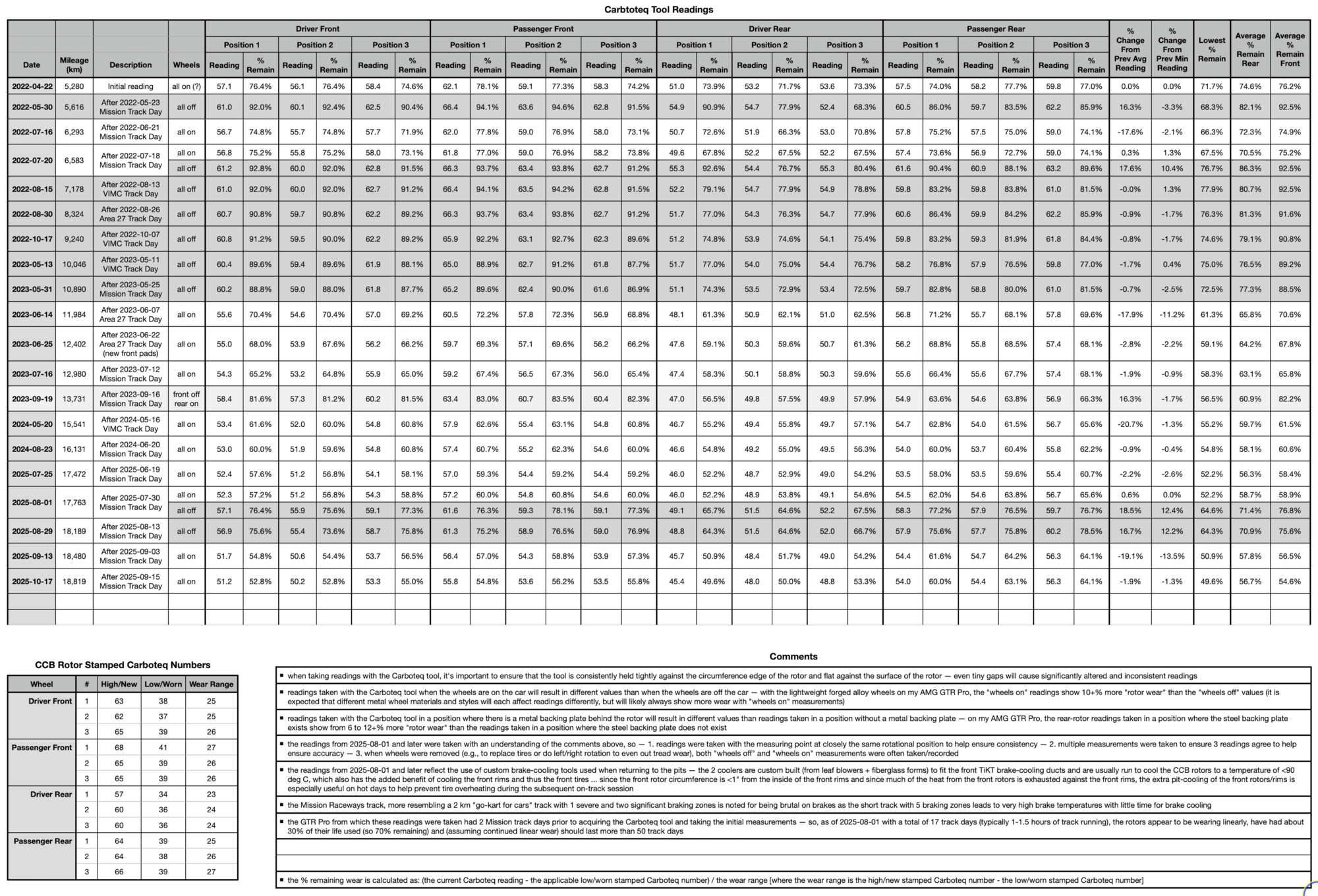

Updated Info
After doing another track day, I've updated the spreadsheet and data to incorporate an additional set of measurements both with wheels off and wheels on and to include the following comments:
  • when taking readings with the Carboteq tool, it's important to ensure that the tool is consistently held tightly against the circumference edge of the rotor and flat against the surface of the rotor — even tiny gaps will cause significantly altered and inconsistent readings
  • readings taken with the Carboteq tool when the wheels are on the car will result in different values than when the wheels are off the car — with the lightweight forged alloy wheels on my AMG GTR Pro, the "wheels on" readings show 10+% more "rotor wear" than the "wheels off" values (it is expected that different metal wheel materials and styles will each affect readings differently, but will likely always show more wear with "wheels on" measurements)
  • readings taken with the Carboteq tool in a position where there is a metal backing plate behind the rotor will result in different values than readings taken in a position without a metal backing plate — on my AMG GTR Pro, the rear-rotor readings taken in a position where the steel backing plate exists show 12+% more "rotor wear" than the readings taken in a position where the steel backing plate does not exist
  • above, the readings from 2025-08-01 and later were taken with an understanding of the comments above, so — 1. readings were taken with the measuring point at closely the same rotational position to help ensure consistency — 2. multiple measurements were taken to ensure 3 readings agree to help ensure accuracy — 3. when wheels were removed (e.g., to replace tires or do left/right rotation to even out tread wear), both "wheels off" and "wheels on" measurements were taken/recorded
  • the GTR Pro from which these readings were taken had 2 Mission track days prior to acquiring the Carboteq tool and taking the initial measurements — so, as of 2025-08-01 with a total of 17 track days (typically 1-1.5 hours of track running), the rotors appear to be wearing linearly, have had about 30% of their life used (so 70% remaining) and (assuming continued linear wear) should last more than 50 track days
At this point, I feel that I have a pretty good understanding of the track-use CCB rotor-wear situation for my car. I'll keep posting updates as I get more data.

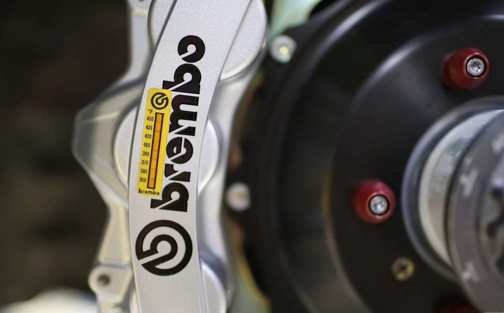

Also you should consider add temperature measurements to your data set. Some of these stickers from AP Racing or Brembo are also a good tool.

I've always used a very thin film of one of the WIS recommended greases for the back of the pad. I also doubt it makes any difference on the GTR's brakes.
I've always used the temp pads, 1 on rear calipers and 2 (1 top back-side, 1 bottom front-side) on front calipers. Currently sitting at:
Driver Front Bottom: between 210 and 232 deg C
Passenger Front Bottom: between 210 and 232 deg C
Driver Front Top: between 188 and 210 deg C
Passenger Front Top:between 188 and 210 deg C
Driver Rear: between 188 and 210 deg C
Passenger Rear: between 166 and 188 deg C
I've been using Motul 660 fluid which is spec'd for a dry boiling point of 325 deg C and a wet boiling point of 204 deg C (though they don't specify the moisture content) and have never had any brake fade, which is consistent with the measured temps. I have one of the little 2-prong multi-LED battery-operated fluid-moisture indicator-tools and have never had any moisture percentage show when bleeding my brake fluid. I see that I can now get Endless fluid via Amazon so I'll likely use them next time (Castrol supply is iffy via Amazon in Canada).

Updated Info
Wear is proceeding linearly and as expected, based upon the data thus far.

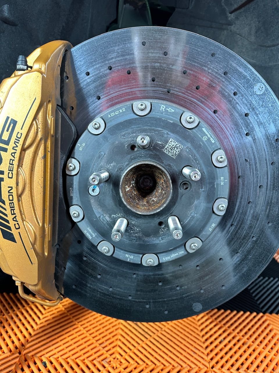

How do your discs visually look? Comparing mine to PCCB I seem to have a lot of pad deposit, or some sort of rotational marking around the discs, whereas PCCB always look extremely clean and mirror like finish even after using on track.
Old Oct 30, 2025 | 03:01 PM
user33's Avatar
Joined: Dec 2013
Posts: 1,085
Likes: 509
Mine look like this ... very "cleaned off." Twice I went through the process of (taping off the TiKT brake-cooling duct intakes and) doing a "brake bed-in," only to have the pad-deposits wiped clean at the next track day ... so I stopped doing that (pun intended). #;-))

Old Nov 2, 2025 | 12:14 PM
tsinc's Avatar
Joined: Aug 2024
Posts: 42
AMG GTR
Mine look quite different! This is with RSC1 pads.
Old Nov 2, 2025 | 01:29 PM
user33's Avatar
Joined: Dec 2013
Posts: 1,085
Likes: 509
Mine look quite different! This is with RSC1 pads. ...
Yeah, yours have some pad deposits indicating that some brake "bed-in" has taken effect ... and remained. That's what we'd all like but, in my case, it gets wiped (burned?) off when I run a track day.
With the pad deposits on the rotors, you should have smoother-operating brakes that are less likely to squeal. Be happy. #;-))
