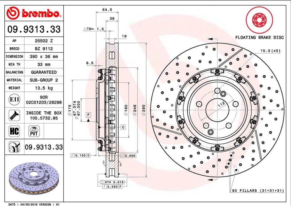

AMG GT-S iron rotor OEM part is a Brembo model 09.9313.33. As I track my car, I have bought many of these due to crazing and cracking from the heat cycles.
https://www.bremboparts.com/europe/e...atibility=true
Just search for this part number on auction or other sites and you will see they can be had for about $600 each. Even less from Rockauto which lists them
OEM Mercedes pads are part number 000-420-51-04 and can be had from an online Mercedes vendor for about $310 for a full set, and you will need a brake pad wear sensor part 171-540-06-17 for $14. Total parts cost would be $1524 or even less. Easy job. You do not need to replace caliper bolts. Mine are original from 2016 and thousands of laps.
