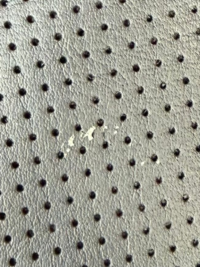

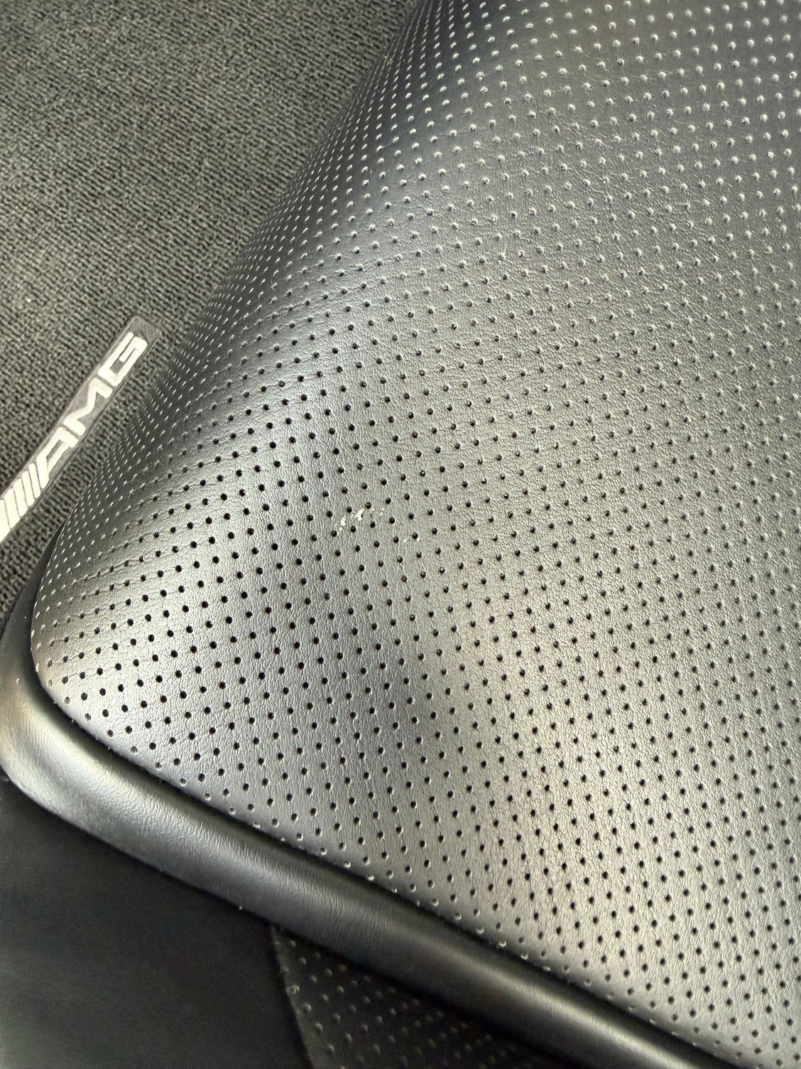

Hey everyone I went to pick up my GT C today from the detailer and noticed a small tear in the drivers seat leather. The car has recently been shipped, serviced, and now detailed so I’m not sure at what stage the damage occurred. I haven’t been able to drive it much and when I do it’s at night so it’s difficult to confidently direct blame. In any case, anyone have any tips on how to get this fixed? Attaching photos. Thank you!

This is an easy fix for an upholstery shop. They can cover up the scratch, then paint it to match the texture almost perfectly.

That looks like a small ,simple and easy repair.
If you take the DIY approach, take a look at this supplier for the cleaner, adhesive, dye, and top coat needed for this repair.: The Best Car Leather Dye, Cleaner & Repair Kits - Auto Leather Dye
You will need:
DyeNamic Clean with Application Pad – Auto Leather Dye to clean the damaged area or the entire seat if you want to refresh it (8 oz)
Luxury Leather Repair Crack and Crease Filler – Auto Leather Dye to fill in the small damaged area (0.5 oz)
Automotive Leather & Vinyl Dye – Auto Leather Dye the actual dye based onthe exact color name of MB (4 oz)
Anti-Dye Transfer Leather & Vinyl Top Coat – Auto Leather Dye top coat over the re-dye area (8 oz low-gloss)
the above amounts (oz) are an overkill for the job, but it's their min quantity.
Follow their video.
The repair should take not more than 30 min (using hair dryer to speed up the process).

Easy fix....leather dye

Another highly regarding Leather Dye/Repair company is Leatherique: https://leatherique.com/pages/leather-dye

Thanks for the insight folks. I’ve got an appointment at Wardell auto interiors in Santa Clara, CA. I’ll write how it goes in case anyone else in the Bay Area and needs work done in the future.

MY guess is they will sway you towards dye only as that is the least intrusive. They will have to do the whole panel to match. Depending how long you will keep the car and how **** you are, you could always see if you could buy the oem seat leather for a later date.
Ive replaced leather seating surfaces in a 15 year old e55 when I sat in the seat with a screwdriver in my pocket. That was a used perfect condition surface for 150. (have probably done a thousand car repairs and there's always a first and last time) I removed the leather and replaced with another stock cover. Now there is an aftermarket for those vehicles.
Ive also purchased original NOS '06 lx470 leather to replace a slightly worn driver seat surface (maybe about 600).
And lastly, Ive done a full interior leather replacement on a 2000 landcruser as well with a nice kit (big brand) I found randomly on closeout on eBay for 499.
It is an art, but also more of a mechanical skill and is very satisfying to have like new interiors in older vehicles.

The repair went well. I can't tell anything was there.
