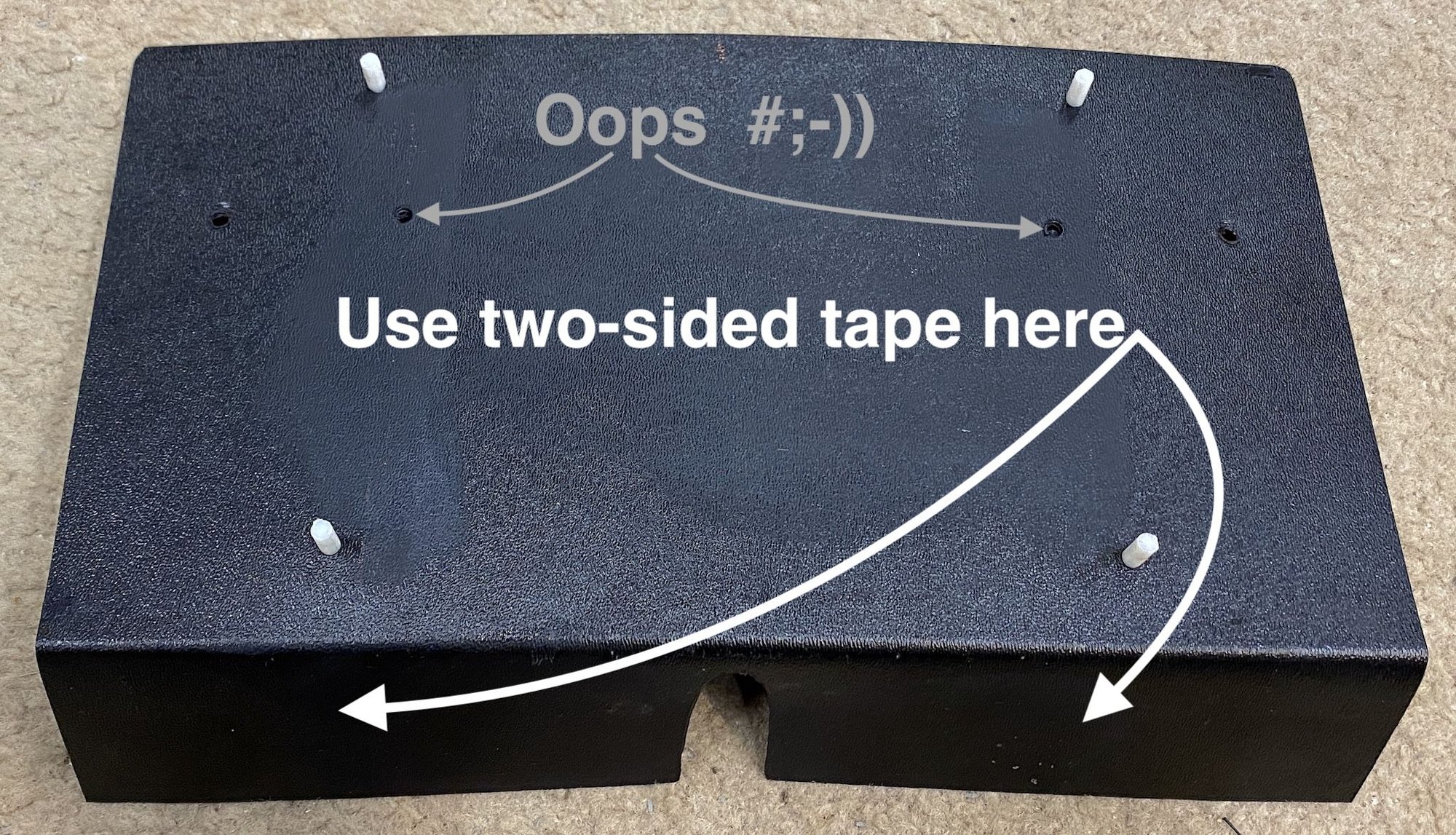

Rather than use any of the gawdy commercial front-plate mounts I was able to find (the OEM one being butt-ugly ... shame, AMG!), I purchased some thermo-plastic sheet from Mr. A. and made my own. While mine's specific to the GTR Pro, this may give others some ideas for something that's more in tune with the car's styling. Although it blocks the lower louvers a bit, so does the OEM euro-plate holder and I've not had any over-heating problems on track.

You’ll need to drill a single hole at the top of the splitter to secure the screw. Start with a small pilot hole, then allow the screw to widen it to the proper size as you install it. Be sure to apply double-sided tape underneath the bracket..

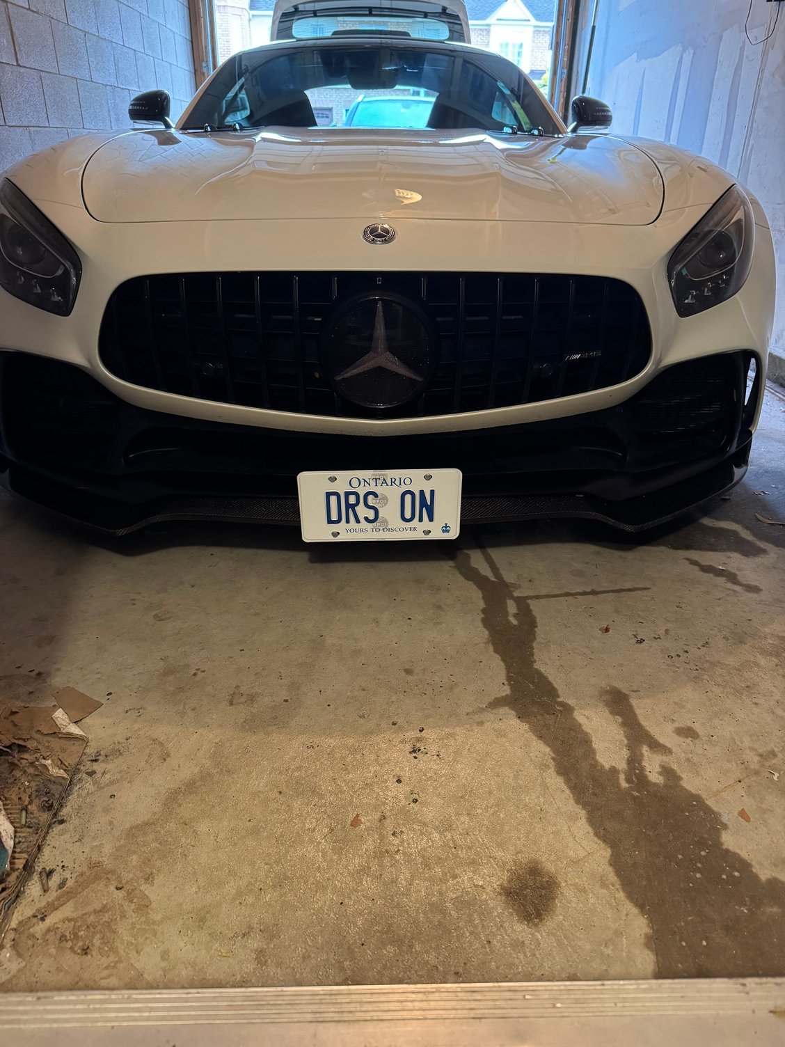

Removable license plate on 2020 AMG GTC

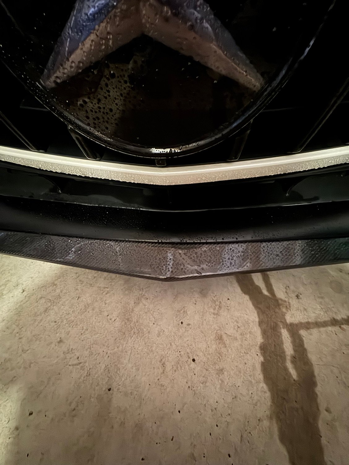

finally got mine installed. Shop had to make a custom fit for it because of the front lip but it turned out fine because on the surface there are no visible signs:
Perfect. Nice job
