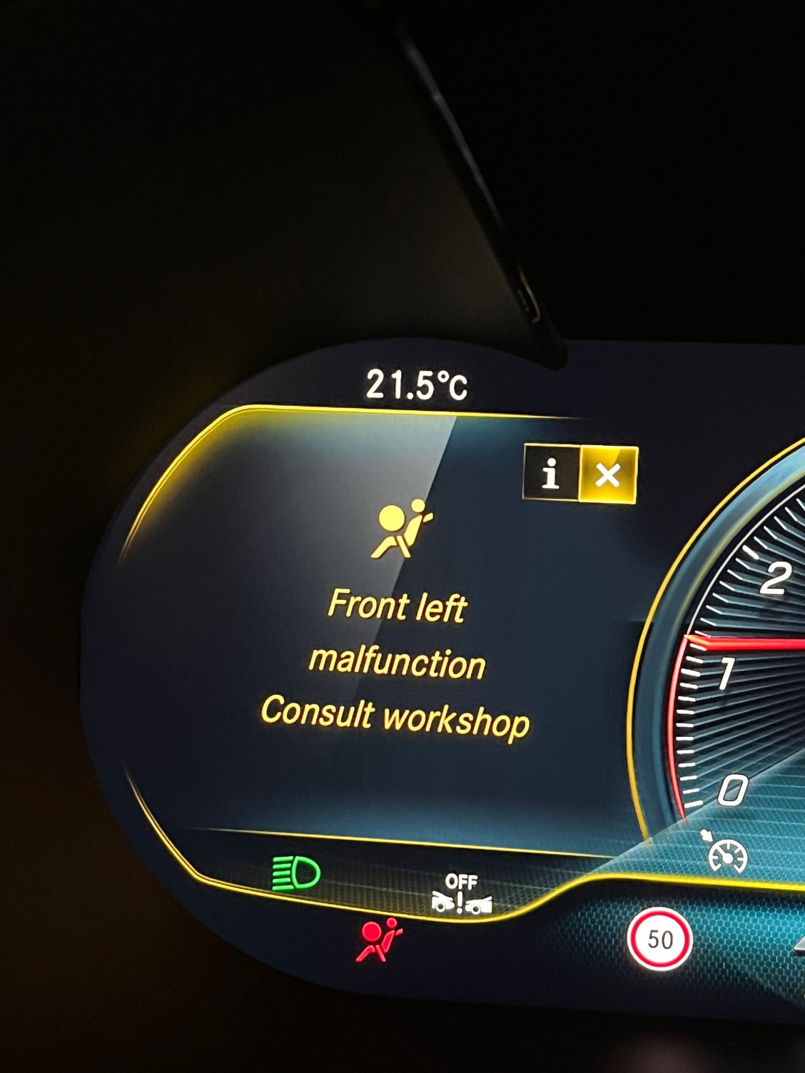

Since my car (AMG GT R) failed scheduled inspection (well it's a long story)...
it is currently off the road pending one part to be replaced.
However, I am having difficulty sourcing this part.
My authorised dealer has been trying for the last 10 months but has not been able to source this part.

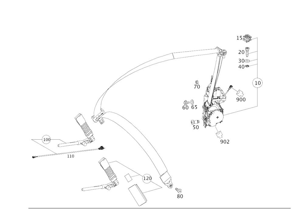

It is the driver side seat belt buckle, for bucket seat variant.
Does anyone know where I could get A1908680500 fully electronically functional and second hand, let alone a new one?
Part number is:
* 1908680500 (190-868-05-00) - Mercedes Benz Ts Seat Belt Buckle
* 1978600369 (197-860-03-69) - SLS, equivalent.
ref: https://www.mercedesbenz.parts/oem-p...kle-1908680500

I did contact safetyrestore 2 months ago, prior to knowing what was the exact issue.
Ref: https://www.safetyrestore.com/seat-b...tensioner.html
According to the page, it is exactly as described, the seat buckle pretensioner is "compressed".
I will attempt to go this route as there is currently no other option.
