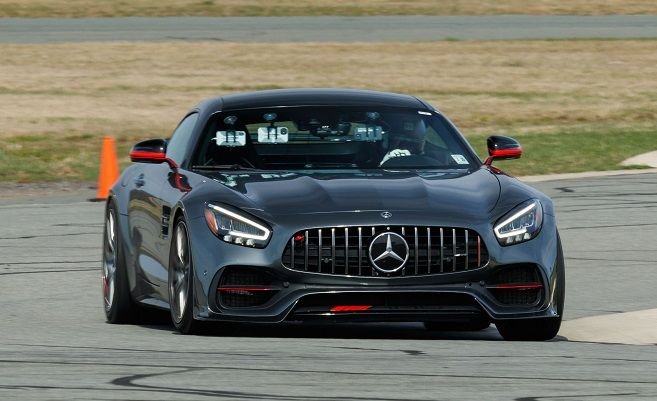

The first option with the 345 PS4S show 20mm and looks flush. I like it. This is my car with a 15mm spacer and the 305 tire too far. You can see how "stretched" the tire is to fit. Your pic with the 345 on the GT-C rim looks very close to flush fit. Is that correct? Obviously moving the entire wheel out 15mm is different that a properly fitting tire.

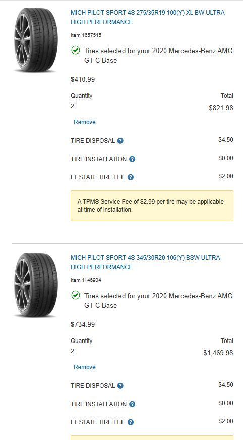

Checking to see if my dealer can match Costco who generally has the best prices but of course I worry about how they will handle my rims. It also bothers me when they dont take the time to remove the sticky backing from the old balance weights and then mount silver weights out where they are easily visible. I may buy a pack of black weights just to hand to them.

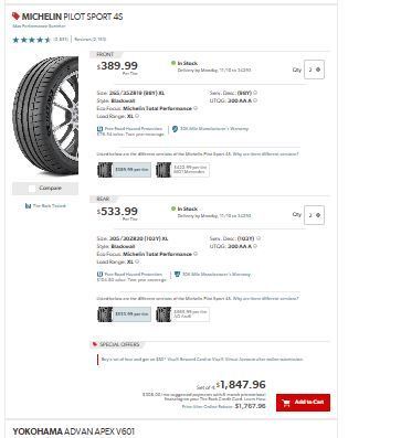

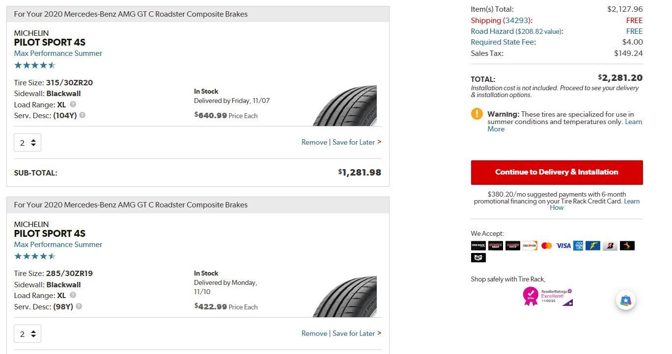

This is what tire rack recommends when I put my cars info in.. The front is fine but I don't understand why they are recommending that 305 rear which has an 11.5" width max

Funny, but I have alerted them over a year ago about it and they still recommend it.

Nice GT-R and custom wheels. I assume this is your friend’s car, since you have a GT-C.
Regarding the tires originally delivered with the vehicle, check the window sticker or the build sheet for confirmation. If you do not have access to the build sheet and cannot locate it online, send me your VIN via private message, and I will retrieve it for you from the AMG/MB WIS system.
Old Nov 11, 2025 | 11:57 PM
Mr. Demeanor's Avatar
Joined: Oct 2025
Posts: 23
2020 AMG GT-C
Yes it is.
