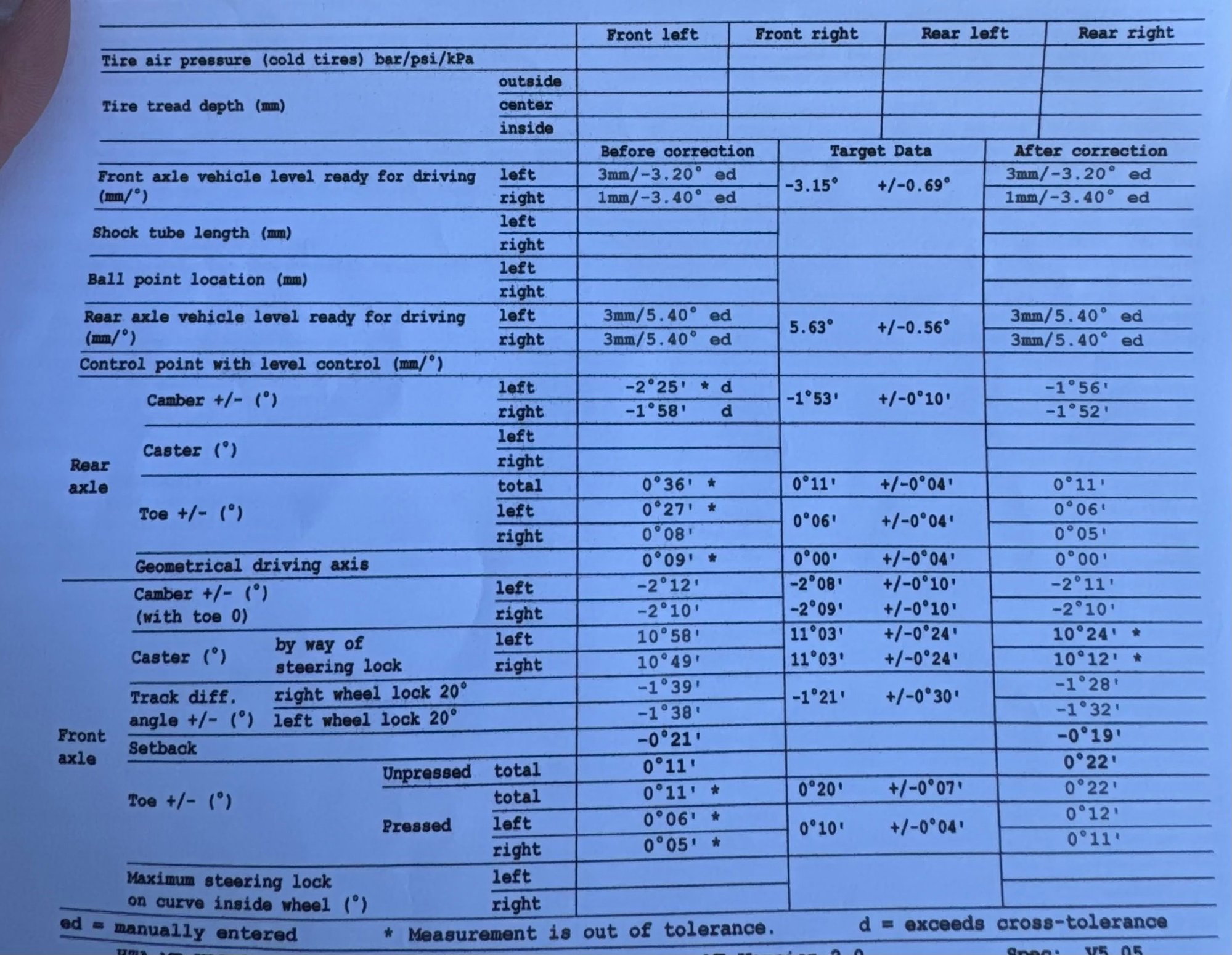

I just had an alignment done by Mercedes because of its habit to wander to the right; and it seems the car still wants to pull to the right, the steering wheel also ends up turning to the right when I let go. Wondering if that’s expected, but the wandering is a bit much. My service advisor is saying to let the tires wear down, but I’m not sure it’s that. I’ve attached my values, does this look ok? They had to use an alignment kit and install new shims.

The alignment is incorrect and needs to be redone.

Caster is not in spec…

clean carfax, PPI came back clean, no damaged to the suspension components at least visibly, everything lines up. The previous values weren’t THAT bad I don’t think. Do you see anything wildly out of spec? Not really sure how how these things are supposed to be
Reply 0
Nov 20, 2025 | 04:21 PM
I see they correct the front and rear toe. It was previously out of spec, but now your front caster is out of spec. Don't know if caster is adjustable on the GT. In many cars it's not adjustable. Caster affects straightness of a car. Toe does as well, but as said, they corrected that. Generally speaking, though, doing an alignment with worn tires isn't exactly the best thing. Your tires have likely uneven wear due to the toe having been out of spec. Swapping them left to right is an easy way to determine if the tires are the problem. Ultimately, best is to get new tires, then get it aligned again and see if the problem persists.

luckily it wasn't this - I just got back from service, and they realigned the car back to spec - the issue was that they forgot to set it in dyno mode and didnt factor in the rear steer which botched the alignment. car's good now, steering is straight. got worried about potential accident damage, but i had a bodyshop look into it, and there's no evidence of an accident which is a great relief
