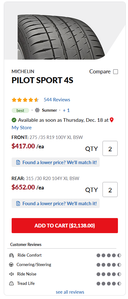

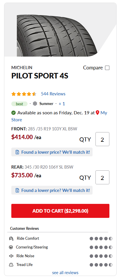

Couple of questions:
1) What made you decide on 345 over 25 sidewalls? Are you going to run it with stock wheels and alignment?
2) Why not run the correct fronts? Michelins makes AS4s in 275/35/19
I checked ChatGPT and it recommends compromising on sidewall.

Originally Posted by untamedd
ai just thinks stock size is the winner and good for it but plenty of ppl using that combo and no issues so experience > ai. 275 and 345 works too
Any reason you are going with 285 instead of 275 for fronts?
Just trying to keep the delta as close to the stock one between front vs stock. Plus the 10” wide rim can easily accommodate it.
you can also go with 275/335 for eg so there are different options. You can go to willtheyfit.com and play around

One possible option is to go down in sizes to the GT C sizes, since the GT C is the touring version of the GT R, so more selection for road tires. .
Do you believe it is better to go down on width to 305 rather than up to 345?
And if you DO go down on the rears, since the correct size is not available, why did you also go down for the fronts? The 275 width is offered in PS4S
From a performance standpoint, it’s hard to justify dropping to 265/305 on a GTR when Michelin PS4S is available in 275/35ZR19 front and 315/30ZR20 rear.
That setup is far closer to the OEM 275/325 sizing, so your front–rear balance remains essentially intact, and any impact on steering feel or traction balance is negligible.
The speedometer deviation is also minimal, far less than with a 305 rear.
To put numbers on it:
- OEM rear (325/30R20): ~27.7" diameter, ~750 revs/mile
- 315/30R20: ~27.5" diameter, ~757 revs/mile
That translates to only about a 0.9% speedometer offset, which is well within acceptable tolerance for street and spirited driving.
While the overall diameter change is small and not something most drivers would ever notice, if you’re a true perfectionist, there is a calibration procedure that can correct even this minor discrepancy :
https://mbworld.org/forums/coupe-roa...ml#post9227106

Thank you for sharing the actual measurements. I definitely want Michelin PS4S if possible.
If you had to choose between 275/35/19 front and 315/30/20 rear or 285/35/19 front and 345/30/20 rear. You would take the first one, correct?
From a performance and vehicle-dynamics standpoint, it really comes down to your primary objective.
As @superswiss correctly pointed out, there are valid reasons to size down if ultimate performance isn’t the goal and the car is used mainly on the street (though, admittedly, this chassis begs to be driven hard on track).
If you’re running a single wheel/tire setup year-round and expect to drive in cold temperatures, heavy rain, or even light snow, downsizing can be beneficial.
Narrower tires improve cold and wet compliance, cut through standing water more effectively, and generally behave better when temperatures drop.
On the other hand, if weather versatility isn’t a concern and you’re primarily chasing an aggressive stance, the 285/345 combination certainly delivers visually.
The tradeoff is meaningful: altered front-to-rear balance, increased rolling resistance, heavier steering effort, and a tendency toward understeer unless other chassis adjustments are made.
Given that Cup 2s are not well suited for street use and the colder winter weather in VA, the most balanced choice for single wheel set, year-round street driving with strong performance capability, while staying close to the car’s OEM engineering intent, is the 275/315 setup.
It preserves handling balance, steering feel, and traction characteristics without introducing unnecessary compromises.
One small point: note that if you opt for the 305. The PS4S call for max 11.5" rim and yours is 12" rim. Not a big issue, but out of spec for a safety item.
