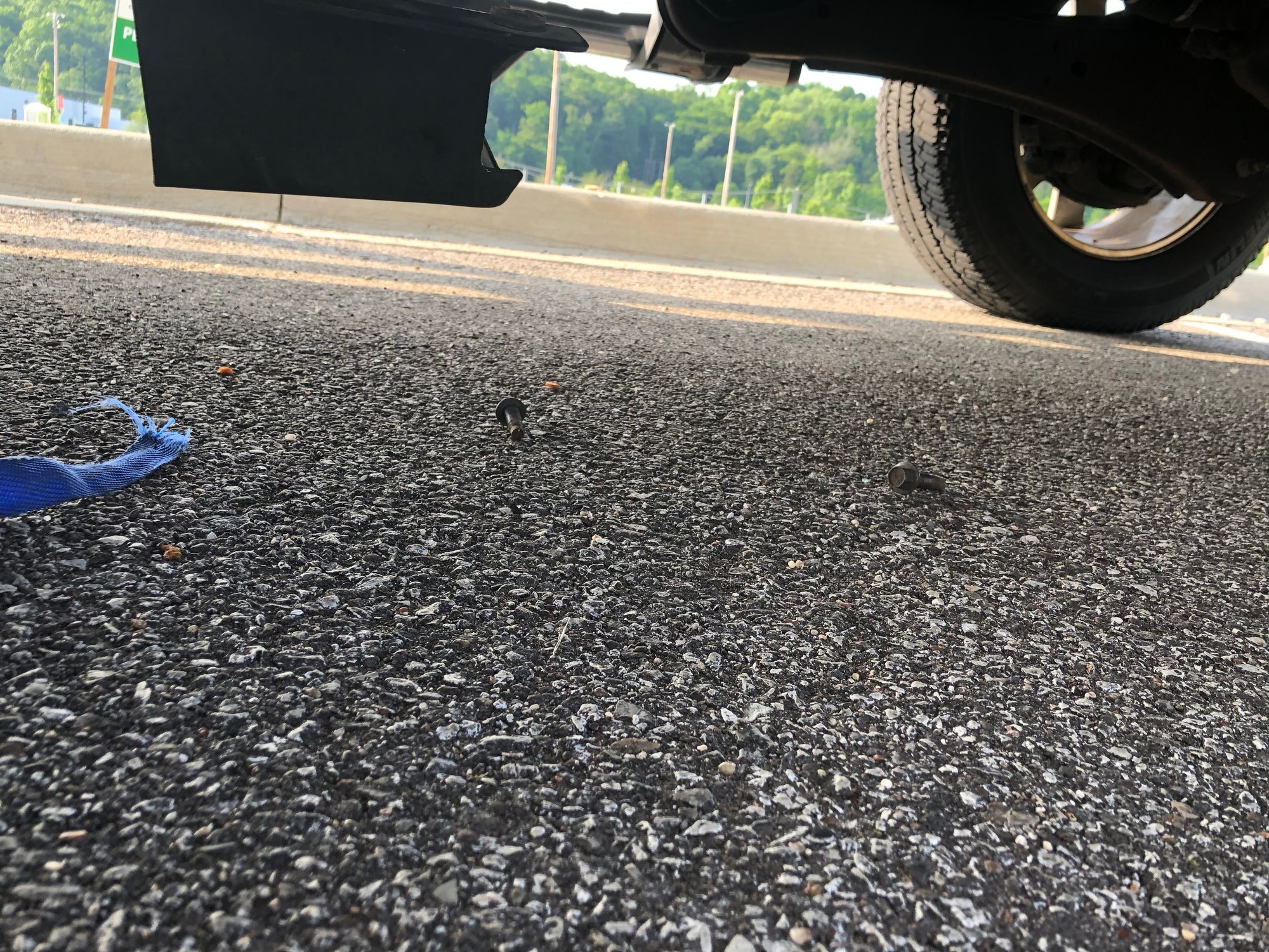

Someone tried to steal the DPF and Catalytic converter from my 2008 F250 6.4 while we were at a hotel overnight in Huntington WV. We were traveling from PA to St Louis MO and stopped at a Fairfield Inn & Suites around 1:45am. When I came out at 9am to retrieve the cooler I saw parts and a strap hanging down from the undercarriage. My initial thoughts were that I hit something on the highway. A closer inspection revealed two cuts and several parts removed. The would be thieves must of been interrupted and didn’t get their prize. The strap and bent exhaust indicates the thieves tied the exhaust to another vehicle and tried to forcibly remove it from my truck.
the locals all suggested this was NOT uncommon due to the high drug addiction in the area. Scrap value on these pieces are about $125 (US). The larger diesel equipment and higher ground clearance of a truck make it a prime target.
No service centers open (Saturday on holiday weekend) and no rental cars for 200 miles. I secured as much of the parts as I could and picked up some replacement bolts for the skid plate at a auto parts store. 400 miles later I found a welder in a rural farming community (Mount Vernon IL) willing to come back in and patch me up for $100 cash. On a side note: with no back pressure the emissions system would NOT enter regen. It immediately went into regen once the exhaust was patched.
We are home now. Insurance will cover the damage. Insurance adjuster estimated at $3000. Dealer came back with $4600. Including the $100 patch, my portion will be $500.
