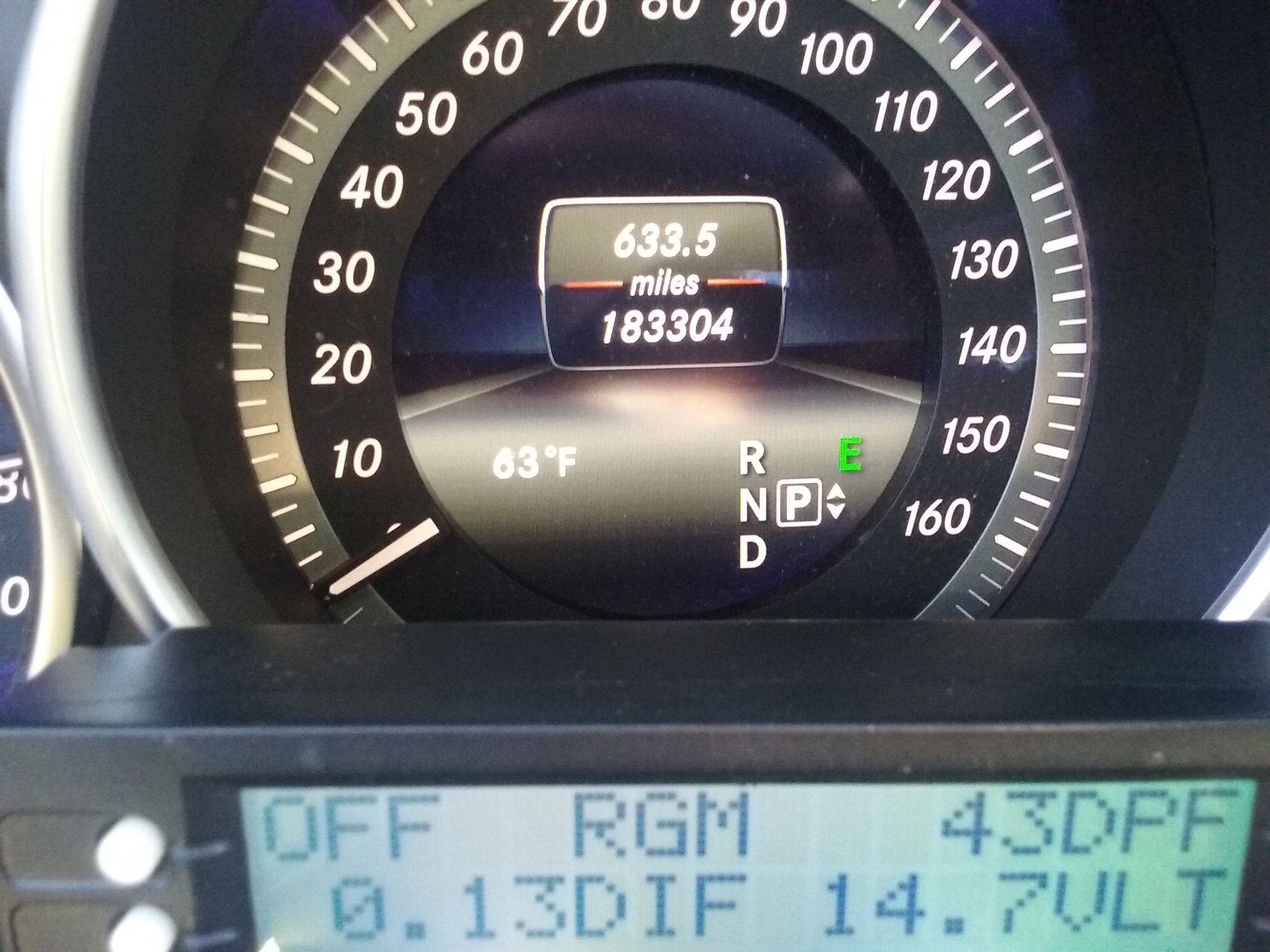

Yeah, wife can make different situation.
Years ago on wife SUV I had custom wheels with $500 tires (each) so I installed add-on TPMS that plugs into cigarette lighter socket.
Took mine business trip when the alarm come on. So what DW did? She pulled the plug.
Fortunately the leak was very slow and she did not ruin the tire before my return.
So what kind of commute your wife does? Is she observant? Will she observe the gauges?
If not- you better drive it in the winter, or at least on days when soot is above 90%.
Here is a picture how ScanGauge fits my car.
Looks to me you already did.
I understand that 3 or 4 of us on this forum - disputing problems with emission systems on Bluetec might create a paranoia between other owners, but that is not how life works.
Don't know how many Bluetecs were sold in America, but must be big thousands, so less than handful guys cutting the corners on dealers's bills are not making big statistics.
So let's focus what we know about your OM642 engine
- it has weak oil cooler seals - not sure if I read it right, but sound like already fixed under #4
- has not reliable DEF heaters - fixed alread
-has DPF who clogs on short and cold drives.
The last issue still has potential to bite you, but just months ago, ScanGauge made gauges for our Bluetecs, where you can monitor DPF and soot level.
Did not check lately gauges for OM642 engine, but I drive with gauges on my "other" OM651 engine and it works perfect. Takes about 600 miles (tankful) between regenerations, but when I see soot coming close to 100% , I make sure I have plenty of fuel (1/4 tank required per MBII) and when regeneration starts, I make sure I drive till soot comes to 0.
One time I aborted regeneration at 26% soot level and next cycle was showing crazy numbers.
To date I am less than 2000 miles monitoring the system, but sounds like with just a bit of care, I can avoid future DPF problems.
So what was the question?

Originally Posted by Ml350DieselBT
. . Is that monitor system hard to install?
It plugs into OBD.
The only issue is finding good spot for it on dashboard.
Before you go to any extreme, do some research.
IMHO removing belly pans and adding bigger oil filter is extreme.
I think I put my cars to higher extremes than most owners as often I drive in 120F temperatures, yet my cars never overheat. Actually driving 1998 MB diesel in California - I removed engine fan blades and used it for 4 years depending on natural air flow and electric booster fans on front. Recorded 114F stuck in traffic on desert and no overheating.
Same with oil filters. I inspect the elements and filter housing at each oil change and I change oils at 13k intervals. Never have seen any deposits there, but than I am religious about using the best fluids I can get.

ScanGauge doesn't specifically list ML 350 BlueTec. Is it the same as The Sprinter model? What engine is in my car OM642?
TIA

Shoot ScanGauge email asking about support for your vehicle.
They send my 2 recorders for my Bluetecs and I send them records from 2008 Bluetec several months ago. When they did Xgauge for OM651 engine pretty fast, they were "working" on one for OM642.
Other member send them another recording from his car, so they have all they need to make proper X-gauge. Sprinters use the same block engine, but with different attachments, so when it might work, you want confirmation.
