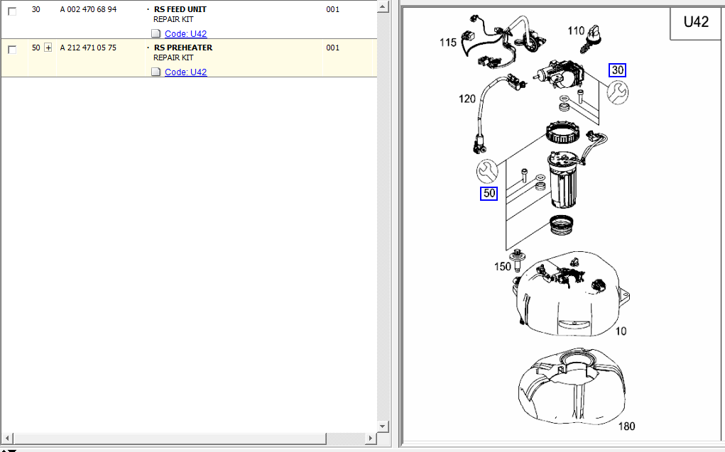

Does anyone know if the AdBlue preheater is covered under the extended warranty after the AEM? I don't exactly see in the list of parts that are covered, but who knows what Mercedes actually calls it.
• Diesel Exhaust Fluid (DEF) Injector
• Diesel Exhaust Fluid (DEF) Injector Controller
• Diesel Exhaust Fluid (DEF) Supply Module
• Diesel Exhaust Fluid (DEF) Pump
• Temperature Sensor Unit (DEF Temperature Sensor)
Old Feb 19, 2025 | 10:56 PM
  #1270
The only thing I guess would even be close is the Pump, maybe the pump and heater are joined? Would be interesting....
The adblue heater is not covered. Ours failed last month. 2014 GL350. We paid around $2500 for the dealer to replace it.
Those are separate from what I understand
Yeah, that's what I'm thinking as well since it's not specifically mentioned in the list of parts.
Originally Posted by edvaru
Weird, I had a CEL for Adblue heater failed. And the dealer replaced the heater for my 2009 GL320 and it was covered under warranty. I know that they replaced the whole adblue system during the field measure in 2023, maybe not for 2014 models.
Only DEF injector was replaced on the 2009s. The tank and everything in it wasn't touched. When your 2009 was covered under warranty, how many miles did it have? When was it replaced? Did you have any other extended warranty?

I just called my dealer. Service advisor told me that it is covered under warranty. Booked my an appointment for Monday. We'll see how it goes.
Old Feb 24, 2025 | 06:12 PM
  #1275
SickFinga's Avatar
Joined: Mar 2005
Posts: 36
97 M3/4
Warranty covered all the repairs.
