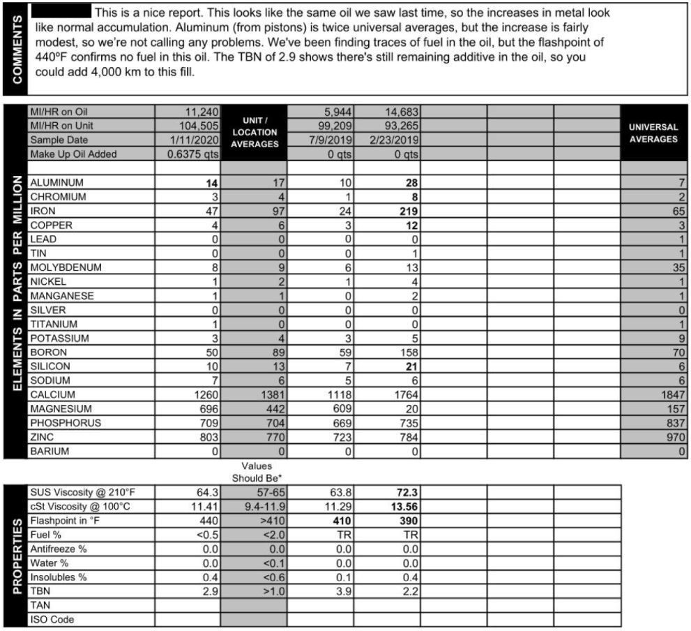

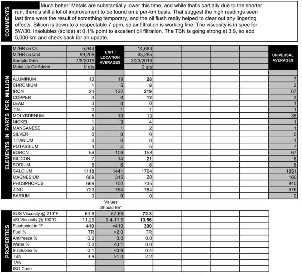

just going to add my oil reports here and comments that blackstone left. i also did the oil filter mod that peter did, except ive been running a DBL7349 filter ( https://shop.donaldson.com/store/en-...questid=147353 )
also did a cheap oil flush before putting in the fresh Amsoil. i dont think the flush cleaned everything out though considering the first report after the oil change, I'll do a better flush on the next oil change. ive been running Amsoil signature series diesel 5w-30 ( https://www.amsoil.ca/p/signature-se...oil-5w-30-dhd/ )
still on the same oil as of today since i dont drive much. all mileage numbers on the report are KM.
First report was done on the mercedes oil and recommended 1 yr interval. the subsequent 2 are on the amsoil with the new filter mod.
Let me know your thoughts since these reports don't mean much to me besides Blackstone's comments...

Both oils you used Babukb2 show low molybdenum, what would indicate dino oils? The link you posted- indicate amsoil as synthetic, but I wonder why they would do different formula than the rest of industry?
Still for such low kilometrage the iron and other metals are high.
I would be tempted to switch to good synthetic. The truth is that you have no way to check why the metals wear higher, but switching the oil is the simplest thing to do.
Unless your flush does the trick? What you use for that?
I am getting annoying with Blackstone double-tongue comments. "nice, metals are lower" >>> on the oil who run 1/3 the distance than the 1st one. What a BS it is.
I think would you run FSS recommended 20,000 km on the oil, you'd have lot of numbers in red.

the first report sample date 2/23/2019 - this was whatever oil mercedes sold me the car with. they did fresh oil and filter when I picked up the car, this sample was pulled approximately 1 yr driving on that oil, 14683km total on the oil.
the other 2 samples are the same Signature series max-duty synthetic diesel oil 5w-30. since starting to use the amsoil i haven't had to do an oil change yet.
what i did to flush was I ran liqui moly engine flush for a few minutes, then vacuumed out all the oil. then i poured some cheap Certified 10w-30 diesel oil in (i dont think this is synthetic https://www.canadiantire.ca/en/pdp/c...-0287915p.html ), let the engine run a few minutes, then again vacuumed out all the oil. then installed the new filter and put in the new Amsoil.
my guess would be because i used the vacuum method to do the oil change, i probably have remnants of the original Mercedes oil and also the cheap Certified oil in my good amsoil now.your thoughts on this?
this summer i was thinking to do the same flush procedure, but also after vacuuming to take off the oil drain plug and drain anything left in the pan, then maybe plug it back up and pour some oil in and then again take plug out and let it drain with any remnants.
i was also looking at ordering a Dimple magnetic plug and installing it since ill be taking the plug out.
im open to any other suggestions on a flush procedure if you think it will help. different engine flush liquid and/or different cheap oil to use for a flush.
