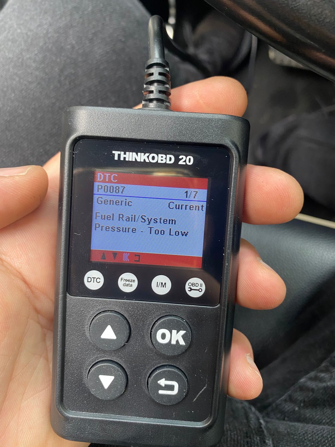

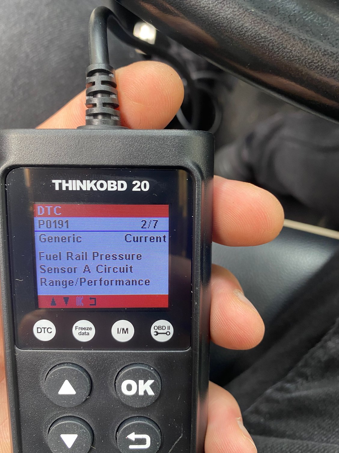

Hello
i have a problem with my car
my fuel pump have a rattling noise at 1500 rpm.
i have p0087 and p0191 error code
i have changed fuel rail sensor and fuel pump still same insue.
can anybody help me

i have changed the control valve and the fuel pump if i unplug the rail sensor the car works fine because it goes in limp mode
