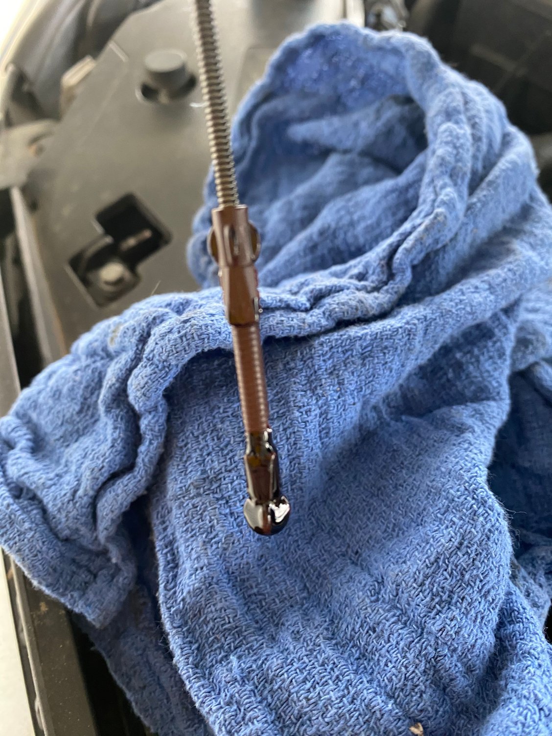

Turbo shaft is starting to get a little play in it. Compressor side isn’t hitting the housing however there is a little up & down play and a tad of in & out play. What do y’all think about that?

Thank you for easing my mind about it. Im running 5k mile oil changed, plus there is no oil consumption to speak of in those 5k miles. Went about 6k on this oil change & added nothing in between. I’m using a provent 200 and catching about 16oz. in 5k miles which leads me to believe it’s not burning much if any.
