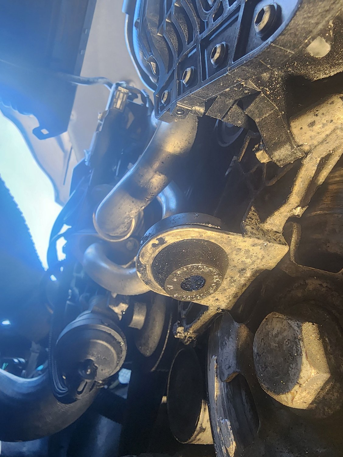

Have a 2015 GL350 Diesel with Mercedes emission modification. went to start it yesterday and it spit out oil across my driveway from tire to tire. I shut it off and looked at it the next day oil underneath looks like it was leaking before I don't have the plastic water guard underneath never put it back since i did the oil filter housing in November. the crank shaft pulley started a weird sequel and get real hot just from idling shut it down. looks like the crankshaft pulley is rubbing because the front off it looks weird. Has anybody experience this? did the crank shaft pulley fail? Any Tips?

Looks like your crankshaft damper/pulley has failed.

That looks like years of accumulated gunk with fresh oil on 1/2 of the engine.
Wash/wipe it, stuff some paper towels in suspected areas and restart engine to pinpoint the leak.

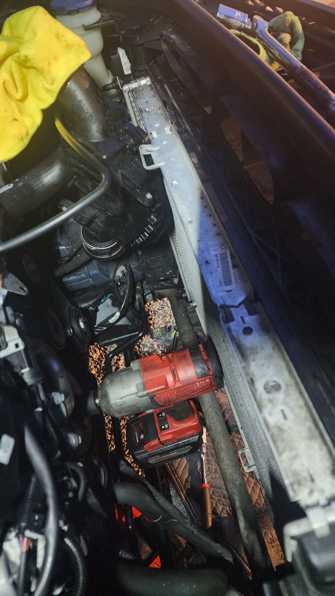

I looked at getting a puller but instead got a really beefy Milwaukee cordless impact with a short frame. It delivers an honest 250+ ft-lbs.
I felt a lot more comfortable pulling the radiator than trying to pull against the puller.

I have A Milwaukee high torque impact gun I might go that route and pull the radiator. I checked the part its correct i might order a bolt just in case.

Got if off with my milwaukee gun, just had to take out the electric fans. Came off without a struggle. The old one failed.

OP, was there scoring of the front cover, where inner edge of pulley could contact the motor?
I didn't have that, I caught it before it got that bad.
From your original pictures and title, I figured you were going to need to replace it or JBWeld a gouge.

Thanks to the OP for all the really good pictures - it shows just how well the accessories and intake plumbing can conspire to make a greasy mess
, over, under, around and behind the assembled complexity of the motor's frontside.
