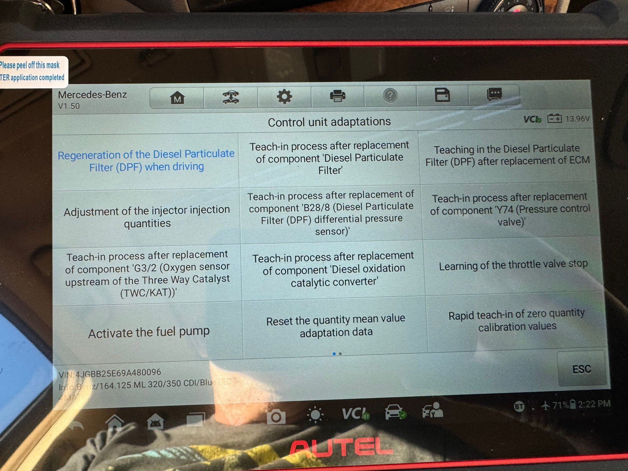

Plugged the Bluetooth adaptor into the ML, and it connected fast, and was able to read the VIN, and codes faster than anything I’ve used before.
I was able to read the engine ECU, transmission, AC, Adblue levels, etc.
But there was more.
I can also see options to do a manual DPF regen, reset adaptations for various parts and sensor replacements.
Never had access to this level of detail before.
But there is a second page too.
I was able to reset the MAF sensor adaptations, which you are supposedly to be done after an air filter change.
