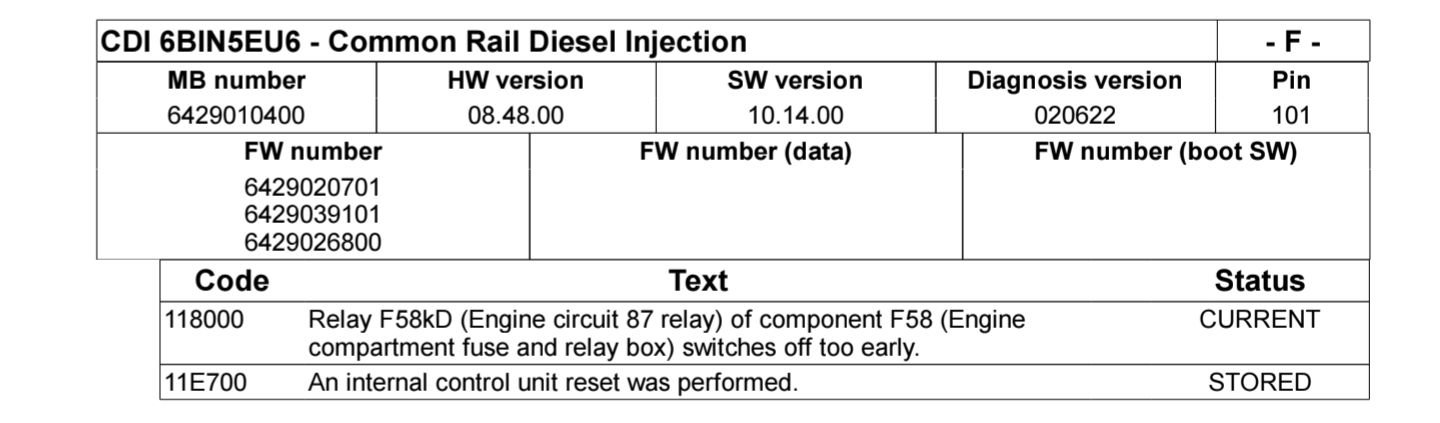

The issue hasn't come up today, but this is the code from when it did come up. I could not find any info on this. Can someone explain what this could be?

In my opinion your starter is shot. Could also be the starter solenoid. Sometimes the starter dies right away, then nothing happens when the key is turned. Other times the starter dies a slow death like you explained it. It happened also on my CLS350 with the OM642.
This could also explain your fault code. The relay works, but since the engine doesn't start it stores the DTC that the relay switched off too early, thinking that if the relay would be ON longer, the engine would start. But it is the starter that's not turning...
