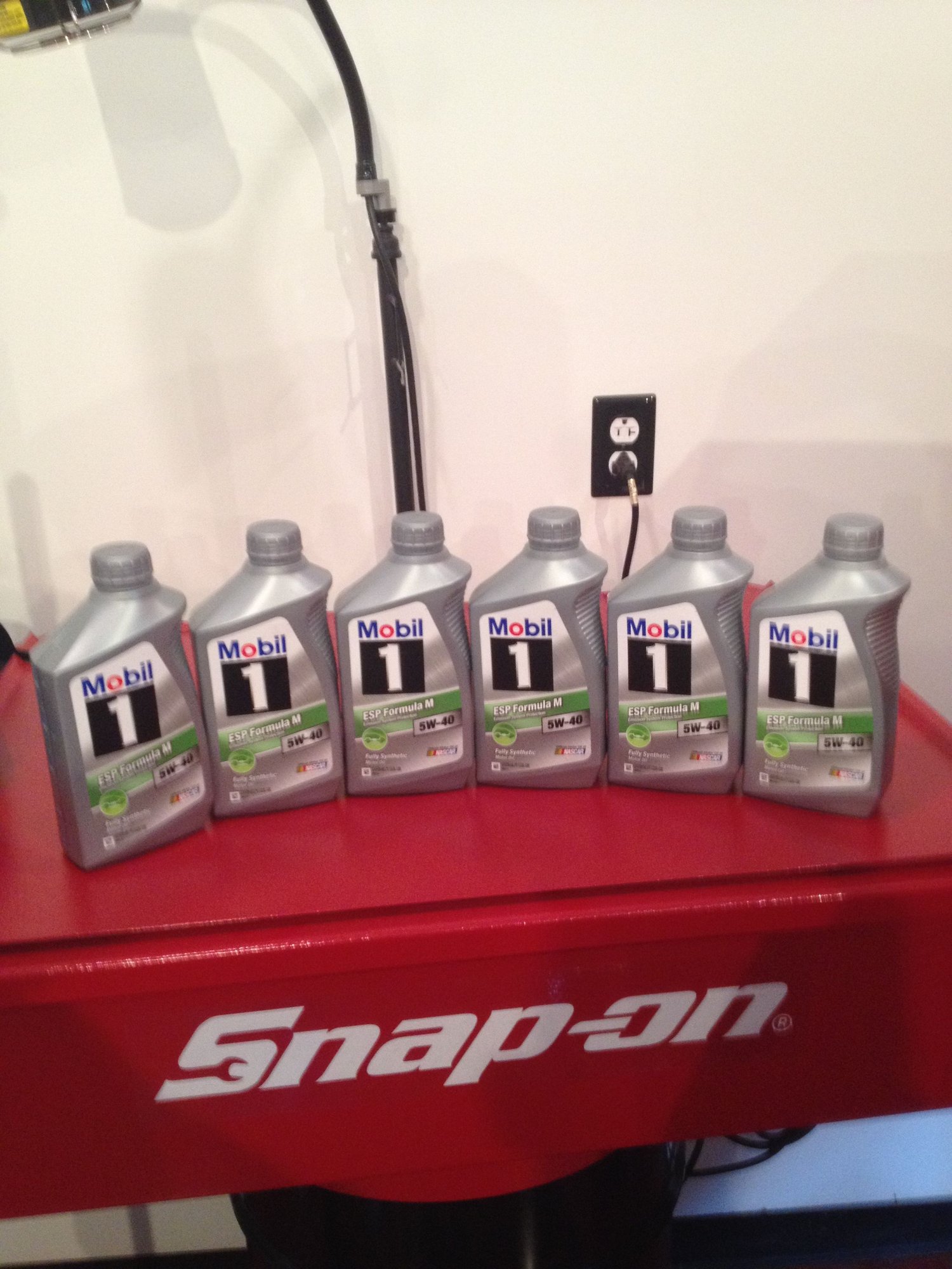

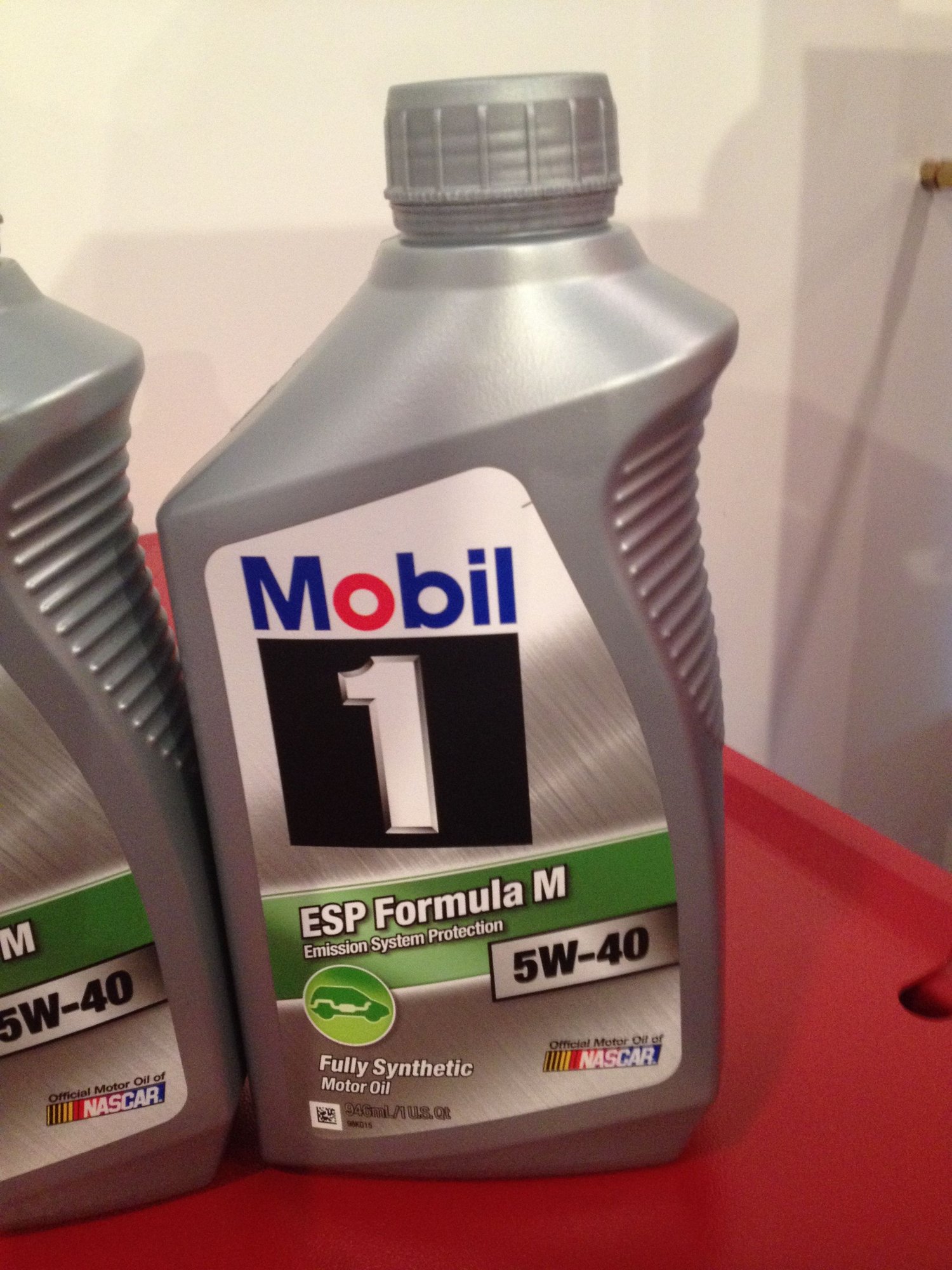

Thought I would post here that I have a case of Mobil1 ESP Formula M 5w-40 I don't need. It was shipped to me by mistake and the seller did not want to pay for the return shipping. 6 unopened quarts with the box.
So it didn't cost me anything. If someone here has any interest, shoot me a PM and we can work something out.
Just looked it up, interesting oil for anyone looking for a 229.51 approved 5w-40

Well I only had one forum member ask about the oil and he was too far away to ship it economically.
Seems a shame but I guess if nobody else is close enough to pick it up, I will just go ahead and put it in the old lawnmower.
Dang, that seems like a waste (unless your lawn mower's got a DPF lol)
I don't have a DPF myself but that's still good oil, sending you a DM.
