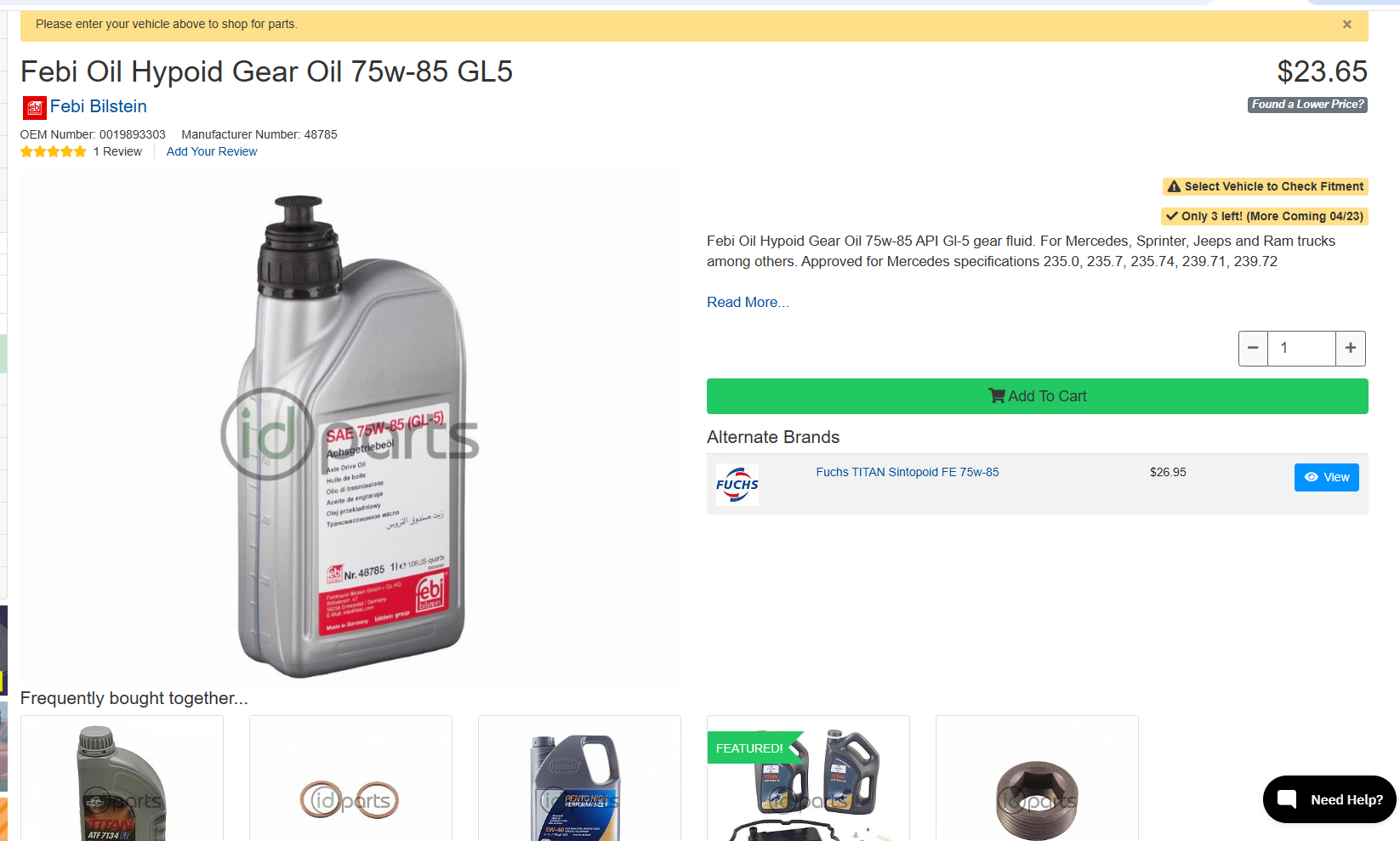

For my W204 I use the Febi 75W-85 which meets the specific spec for front and rear diff on my car. Not sure which specific MB spec is for yours.
I was able to find it locally from an online diesel parts website that has free pickup at the warehouse a few miles from my house.
I see FCP has it also for $29/quart.

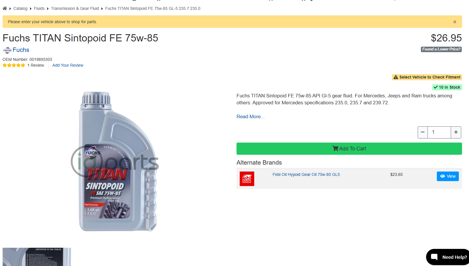

They have the Fuch's that says it meets similar specs, but not all.
