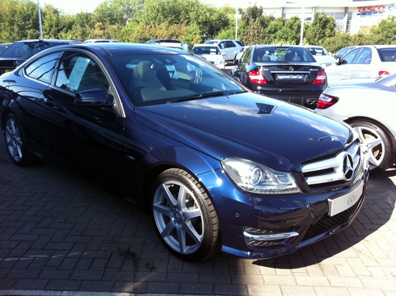

There's a quick shot of a C-Coupe I snapped the other day at my dealer.

Nab! The C-coupe looks great in blue/wheel upgrade! Do you have any more shots for me?

It looks really nice Ryan, got to say every time I see one I like them more and more. I'll take some more shots of it if it's still there in the next week; if you look in the picture there's a C63 in the background - going to look at that only problem is it has a very basic spec - which compared to a standard model W204 is high but I'd want extra kit on it (PPP, carbon etc)
