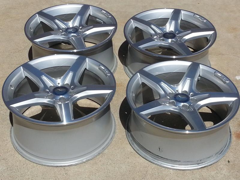

Old Jul 30, 2013 | 02:11 PM
  #89
miky2001's Avatar
Joined: May 2013
Posts: 93
2010 E550
I got my AMG wheels!
i got my 19" AMG wheels!!
parts numbers are:
PART# A231 401 1602 front 19 X 8.5" OFFSET 35.5MM.
A231 401 1702 rear 19 X 9.5" OFFSET 48MM.
i want to make them black, powedercoat glossy black, (or perhaps plastidip?)
i plan on getting 255 35 R19 & 285 30 R19 tires since i have been told here they will fit my stock suspension on my 2010 E550.
anyone know for 100% positive these tires will fit before i lay out the cash for the tires? i dont want to waste my hard earned cash if they are too fat.
might be selling my 6 spoke stock wheels soon if anyone needs them
