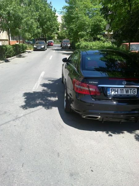

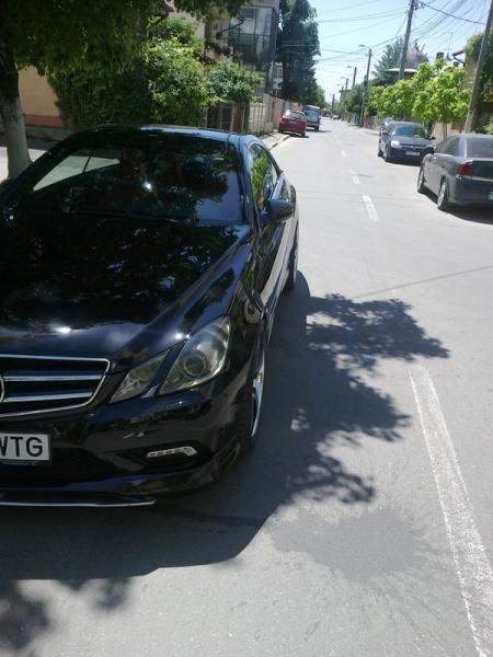

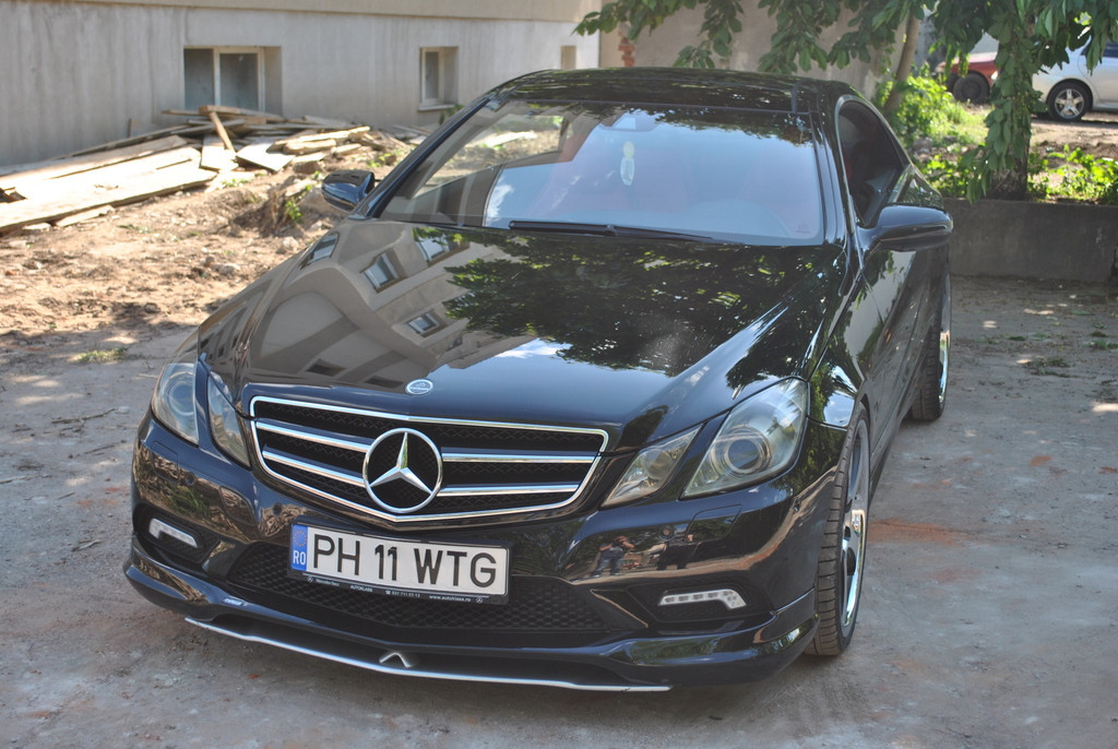

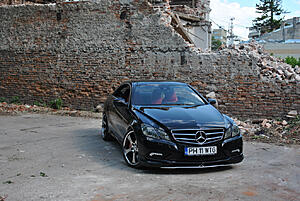

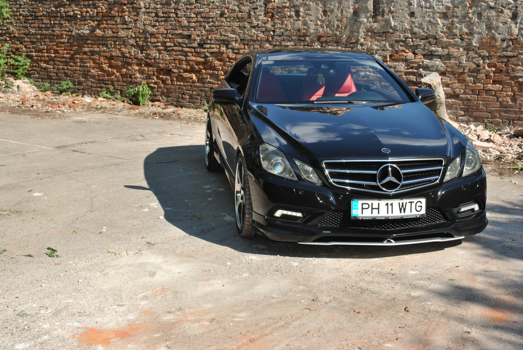

I think this thread it will be useful for the newcomers.I often receive PM's with question about offset and tires set up.I posted here some pictures with my set up maybe it will help.I think all senior members should post pictures and info about their set ups.I hope i am not wrong starting this thread.
My set up is FRONT:245/30/20 ET 35;8,5*20
REAR : 285/25/20 ET 45;10*20
I am using EIBACH springs.

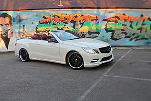

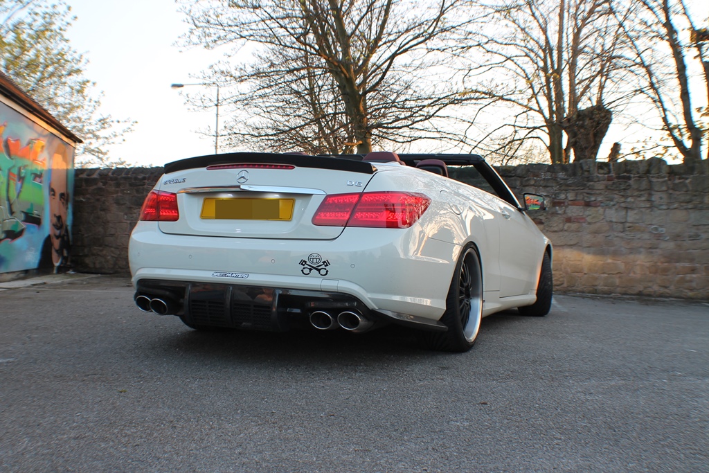

my set up:
front: ET40 8.5x19 235/35
rear: ET38 9.5x19 265/30
with H&R springs

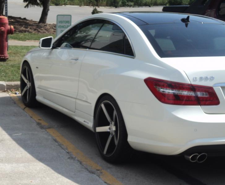

20x9 245/35/20 Nitto Invo
20x10 275/30/20 Nitto Invo
Not sure on the offsets, likely somewhere in the 40's for both F & R.
KW SportComfort coilovers, no rubbing at all.

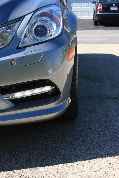

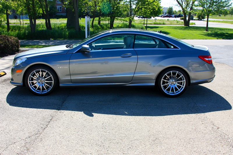

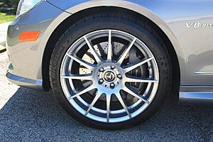

Here is my setup:
Velocity Motoring VMR 721 wheels
F: 19x8.5 ET35 235/40-19 Michelin Pilot Super Sport
R: 19x9.5 ET 45 265/35-19
Schrader 28214 TMPS sensors
No rubbing with stock suspension even with taller tires to reduce fender gap. Had good luck with VMR wheels on my Audi S4 so decided to give them a try on the E550. MB wheel caps do not fit these wheels so I bought some MB logo wheel center cap stickers off Ebay to cover the supplied wheel caps.
Very happy with this setup. Handling, tracking and grip all improved over OE wheels and tires.

Everybody should note that above tire sizes were ONLY possible due to stock suspensions were replaced by KW coilovers.

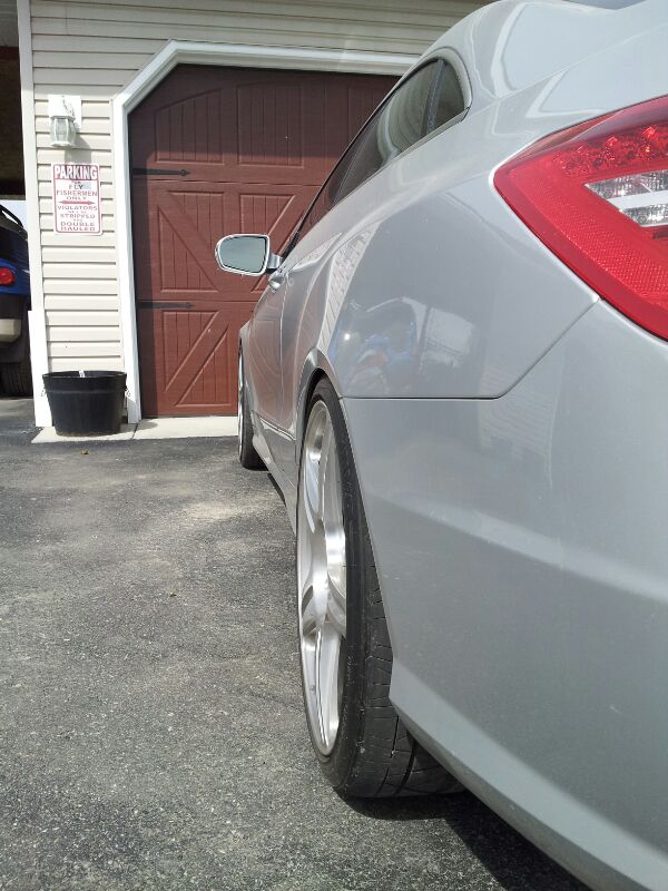

I drove the car with these wheels on and stock suspension and it was fine, in fact I even had 295/25/20's on the rear and it was okay. I lowered it with the coils and the 295's just barely rubbed the fender on big bumps, that's one reason why I sized down to a 275/30. The other reason is that a 295 on a 10" wheel looks like a square block, too wide and doesn't match the contour of the front tire.

Well I do not know what else was required to fit 295/25-20 on stock's rear since I did not even try it, but I know for sure that there's no way to fit 245/35-20 upfront on stock suspension. For 245/35-20 front coliovers are required. Unless Canadian cars are so different from US, there's just no way for unmodified suspension due to perch protrusion. We have tried that without any success on several E550/E350 coupes and even E350 sedans (which have more room).

Perhaps because I have the dynamic suspension with the adjustable sport/comfort mode. Struts and perches may be skinnier than the standard setup? Maybe it's just a freak of nature haha

As per above you had 245/30-20 front (not 245/35-20) on stock suspensions. I know 100% that there is zero chance of 245/35-20 fitting front on stock suspensions. It is possible only with coilovers (which you have now hence makes it possible).

Yea I mistakingly typed the wrong number, should be 245/30/20, not 245/35/20. Good catch. Can't edit my post for some reason.

DR-Nab, may I ask what diffuser are you using? I'm loving it!
