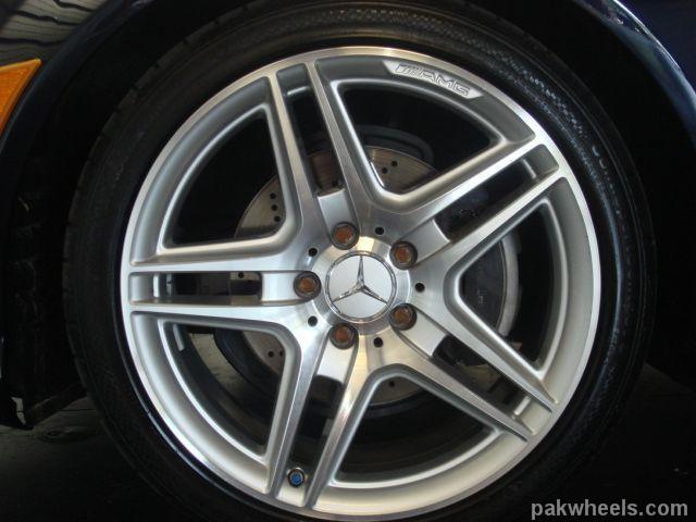

http://assets.pakwheels.com/forums/2...heels(com).jpg
Those are the rims I have. Would fitting high performance rears such as Potenza Pole Position's be better than just fitting a slightly wider tire?
I'm just having issues with general off the line starts and fast (but not ridiculous) cornering. It just seems like its very very easy to lose the rear.

I (as well as several others here with 550s) had the same issues when I got my E550. Your car has even more torque.
I immediately switched to high performance and wider tires. I wanted to buy rear E sedan's rims only, but for their price (actually for price of one) I bought four 19" aftermarket rims instead.
If you do not want to buy/upgrade rims, then at least a switch to very sticky summer performance tires (I would go with Pilot Supersport or PS2) is a must on these cars. OEM all season tires just do not work on 550s.
