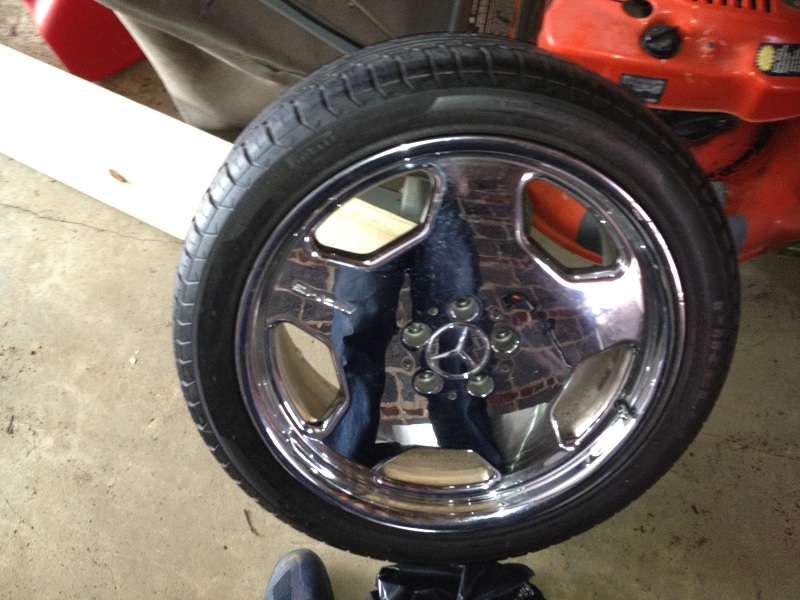

So one of my neighbors is selling his Monoblock Amg wheels and tires.
I think they are not staggered .. Correction on the tire size They are 19 inch rims with 255/40/19 size tires
My question is if these will fit my car. These came off an 2001 S class but will they fit my E550 Coupe?
I do not know the offset yet but i guess i will see and maybe change out tires.
Anyone knows if these tires will fit?

I checked the back and is said ET 46
so do you think they will fit?

Wheels will fit. You may want to run 10mm spacers upfront for more aggressive look (and 10mm rear if non-staggered wheels). Tires (from S-class as on those wheels) will never fit, do not even try. For tires, you will need 245/35-19 front and 275/30-19 rear, assuming those S-class wheels are staggered - 8.5" front and 9.5" rear. If wheels are non-staggered (8.5" front/rear), you can run 245/35-19 front and 255/35-19 rear, but I would look elsewhere.

Thanks everyone for the response! where is the best place to pick up these tires? does tire rack.com have good tires?
They are non Staggered so i will probably get spacers for all four wheels.
