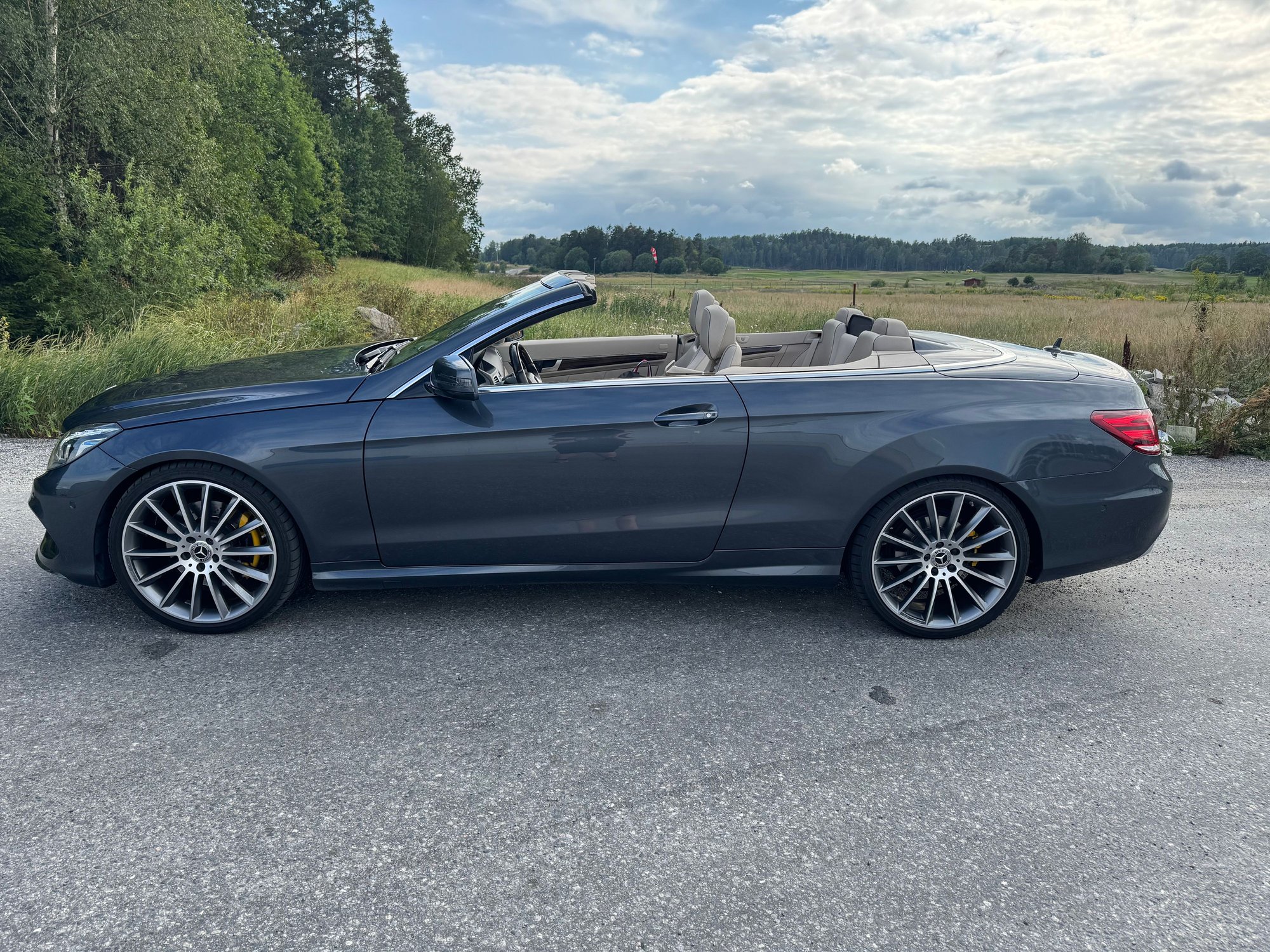

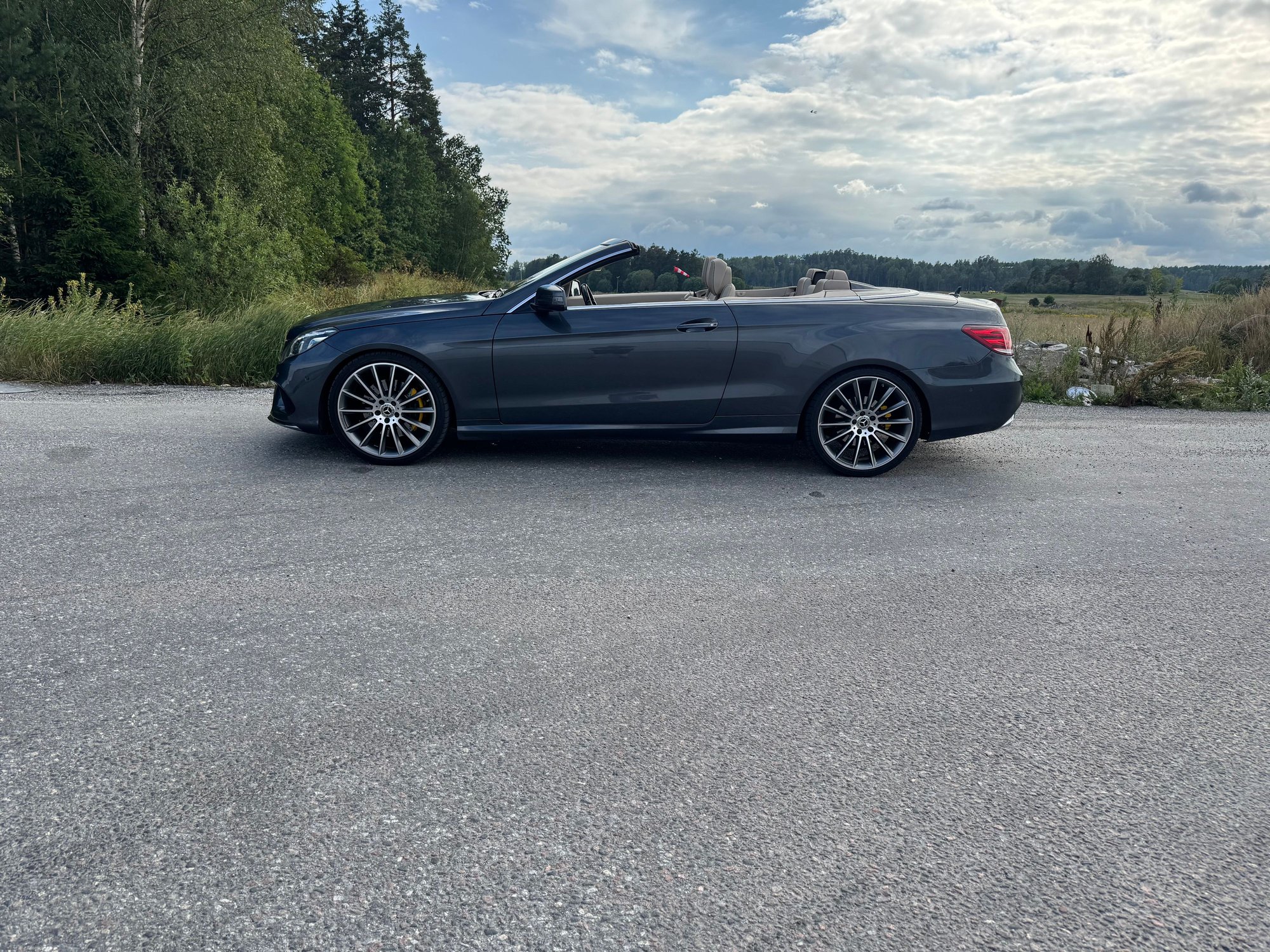

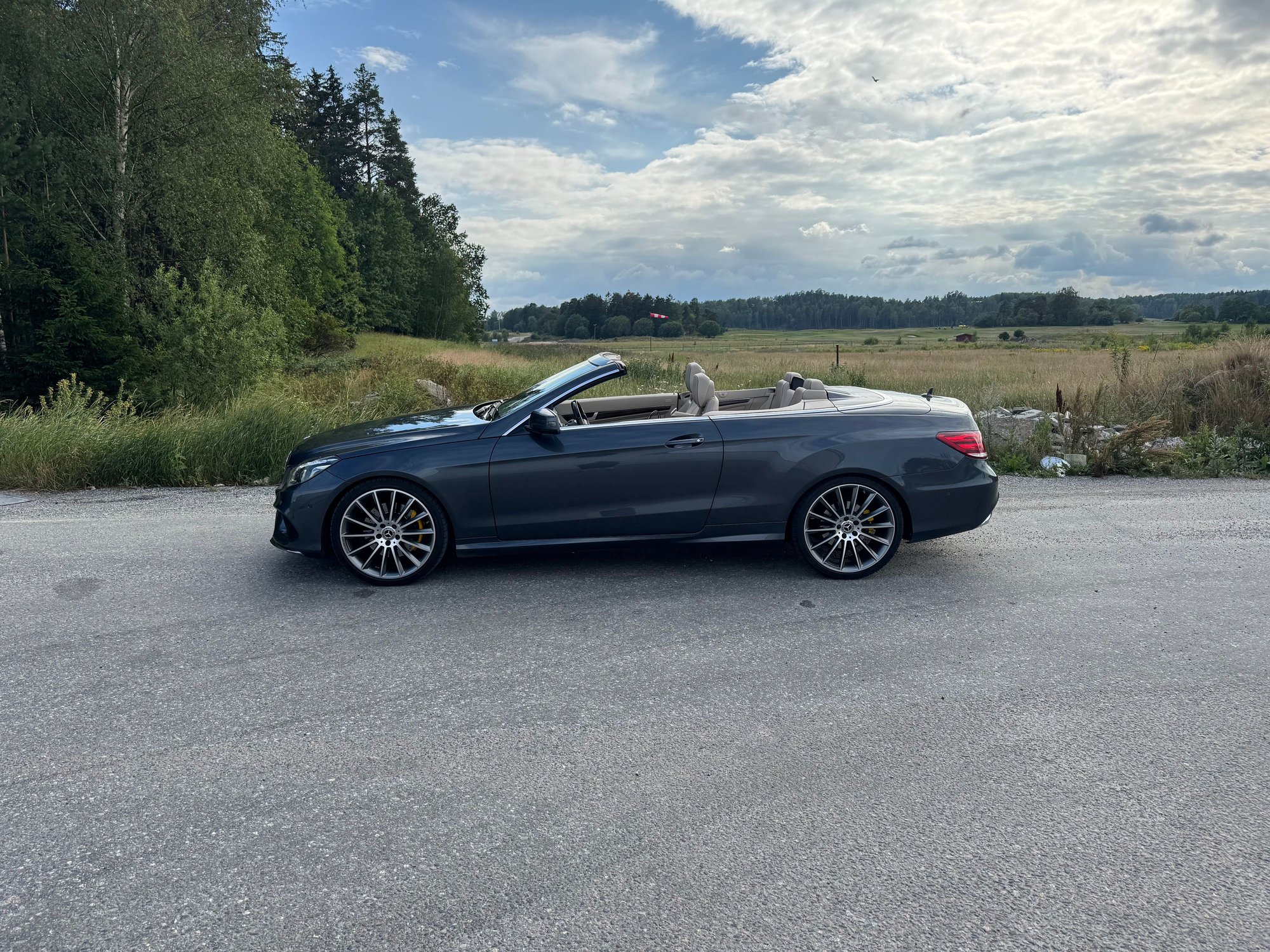

Hi!
I have an E400 Cab -2015 .
I have bought 20" rims
Front 8" ET 43
Rear 9" ET 49
I have read the whole thread and I'm still not sure if they will fit or not?
My thoughts on tires are:
Front 235/35 R20
Rear 265/30 R20
Will this setup fit on my car or should i change something?
Thanks in advance

Should work with no issues

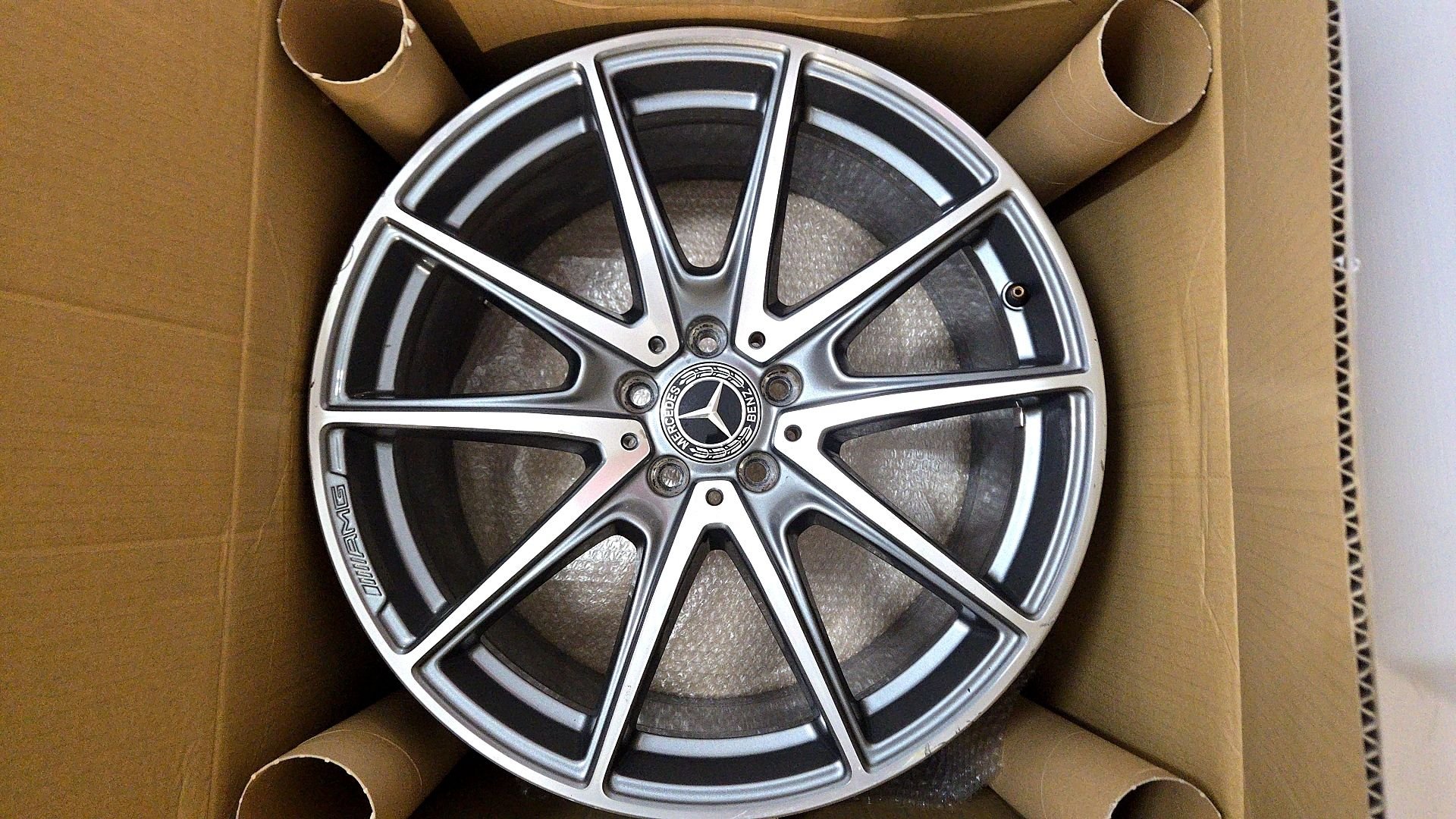

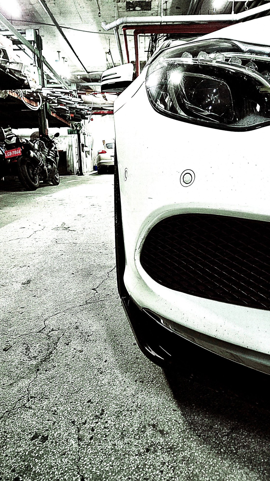

E400+AMG line S63 rims
Front could upgrade to 255/35-20 ET38
Its seems not very big then, even 20
It's seems not very big then, even 20" already.
Still, I  put them on my car without any modifications, everything is fine and fluently. Road situations feedback is way better, turning  response sharp than before.
It's heavy(14-15kg each), but feels very rigid and long lifespan. Beautiful rims too.
Rear wheel is very close to hit the panel, but no. 275/30-20 ET38

Hi again,
I just tried to mount these on my car but they were rubbing pretty badly on the top of the strut tower.
Do you think a spacer will solve this? Which thickness should I go for? 10mm?
Thank you

11mm spacer solved this , still rubbing a bit on hard bumps but its ok. ET 32 front (with spacer) and ET49 back. W213 E-class AMG wheels
