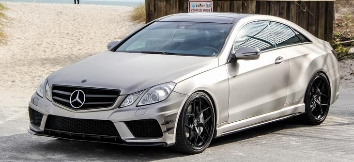

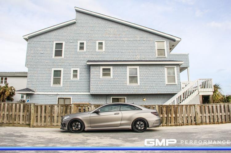

2010 E550

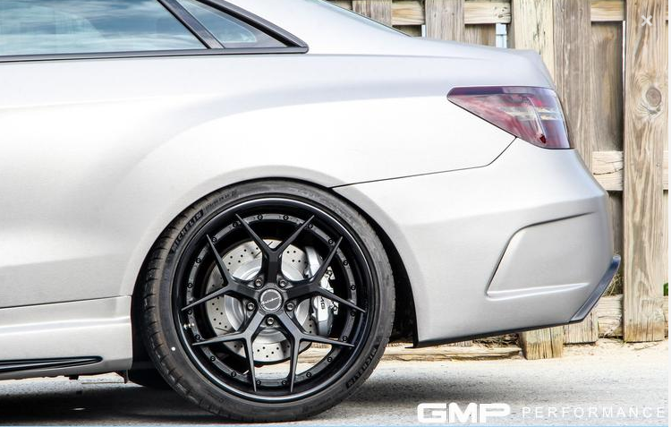

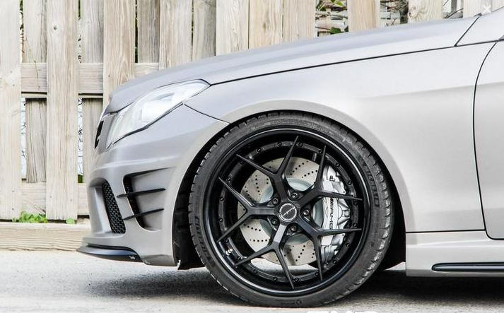

Brixton Forged PF7 Targa
Front – 20x8.5 ET35 245/30/20
Rear – 20x9.5 ET46 275/30/20
KW Coilovers
zero rub in front or rear.

Nice ride!
BEAUTIFUL car! You spent a nice dollar on that ride. Brixton wheels, kw coilovers, full body kit, AMG brakes.

Thanks! It has been quite a journey as are most builds I suppose...
Brakes from the w204 c63 are direct bolt up on rear and I had the black bracket made to convert the fronts from the c63
More pics..

are the fronts 390mm?
More pics..
Looks nice what color is your wrap. Reminds me a little of mine in satin dark grey. I was gonna go with some stance wheels very similar to those but they w were on back order. Also did you change your exhaust setup?
The fronts are 360 and the rears are 330. I had asked the shop that did the brake conversion to document the build for me and so he took a picture of the rear rotor and caliper with the bracket for the fronts...
Thanks! Wrap is Avery Denison color is Brushed Titanium
GMP in Charlotte did the c63 brake conversion, KW coilovers and a set of Kleeman headers. As part of that they did x-pipe, resonator delete, cutouts and the mufflers were left stock. I replaced the chrome quad tips in these pictures with black ones to go with the all the black out I had done.
