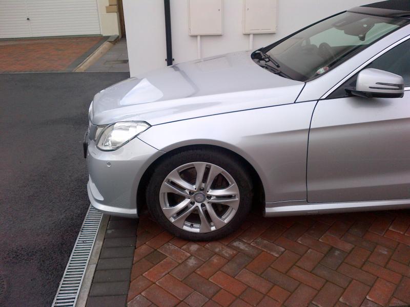

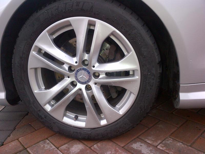

Old Dec 30, 2013 | 06:21 AM
theraven333's Avatar
Joined: Sep 2012
Posts: 204
From: England
Mercedes E350 CD Iridium silver convertible 2010
Here are my 17" winter wheels, I use these Mercedes wheels for winter as the AMG diamond cut wheels are so prone to corrosion!!!

Old Dec 30, 2013 | 06:29 AM
mariemiguel0617's Avatar
Joined: Dec 2013
Posts: 54
2012
The 17" wheels of your Mercedes theraven333 are really impressive. I even do like the color of your car matches your wheels
