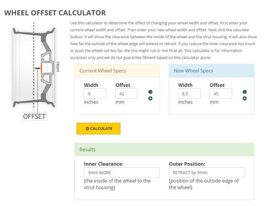

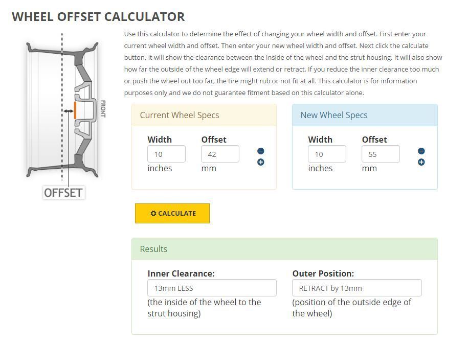

Using SnakeDoctor's specs as baseline:
20x9 +42ET (effective offset with +45 and 3mm spacer) Front
20x10 +42ET Rear
The front wheels will have 3mm more clearance on inside and 9mm less poke. Your desired tire size of 245/35-20 is about 26.8" total diameter so over an inch more than 235/30-20 (25.7" diameter). So you need to consider the 10mm wider and 1" taller tire (if SnakeDoctor's front setup has at least 8mm (3mm + 5mm (1/2 of 10mm)) clearance to the strut housing and with 1/2" higher tire (from center of wheel) then you should be fine.
The rear wheels (since same width) will have 13mm less clearance on inside (to strut housing) or 13mm less poke. This may not work depending on how much clearance is available to strut housing. Your desired tire size of 285/30-20 is about 26.7" total diameter so also over an inch more diameter than 285/25-20 (25.6" diameter). As SnakeDoctor noted - his setup is already pretty tight so it's not looking good that the rears would fit (may need spacers to bring the wheel out more).
Also, keep in mind that your tire diameter from OEM stock (255/35-18 on rear is typical size) is about 1.7" more which would cause a noticeable difference in speedometer accuracy (with larger diameter tires your actual speed will be more than what is indicated on speedometer).
Offset calculator:
https://www.1010tires.com/Tools/Whee...et-Calculator#

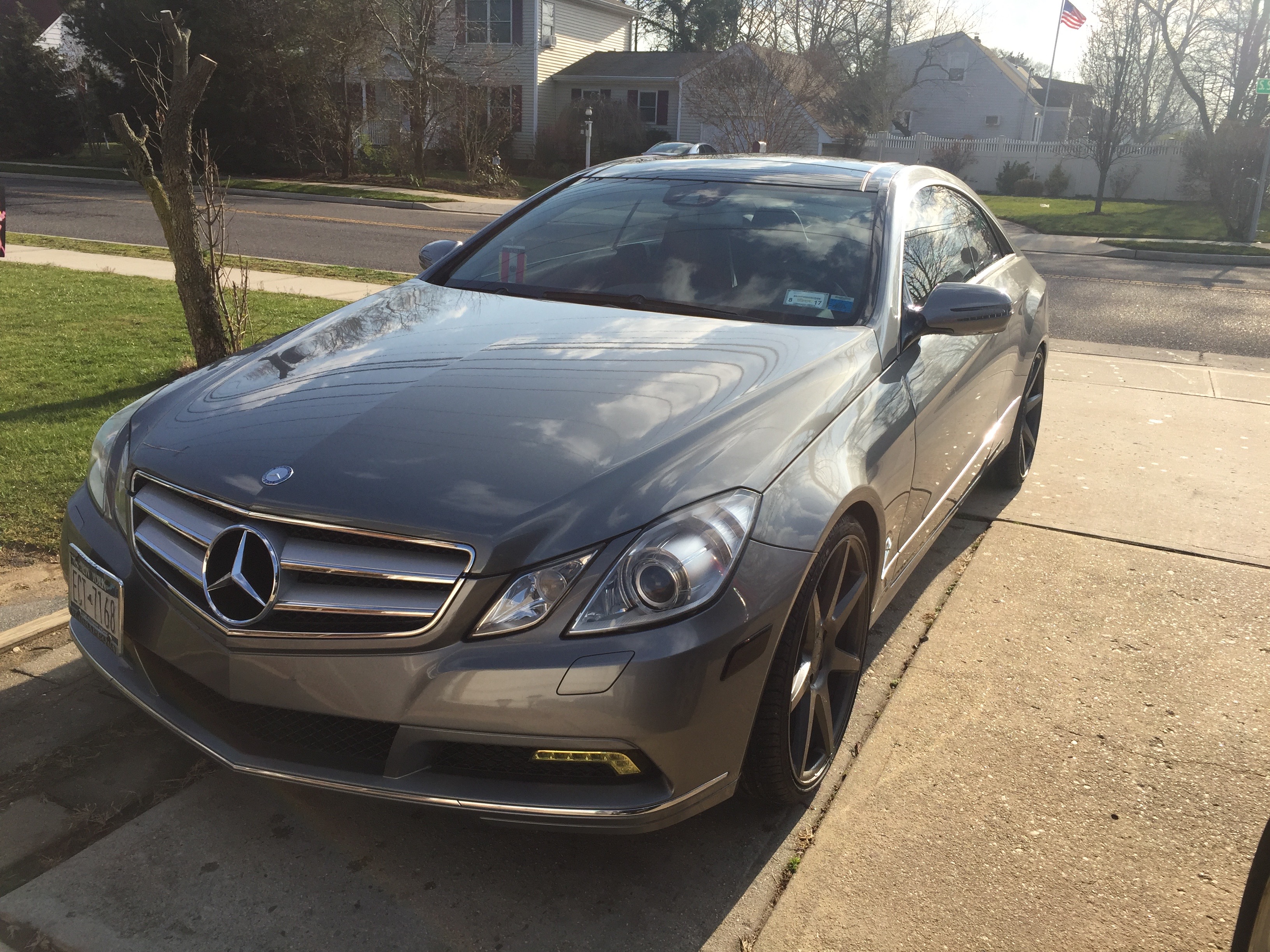

So I recently got my tires mounted on the ca and it finally fits.. So I went with 245/30/20 on the front and 285/25/20 on the rear.. No stretch tires or spacers needed, also there is no rubbing in the struts or the fenders. I will post pictures soon

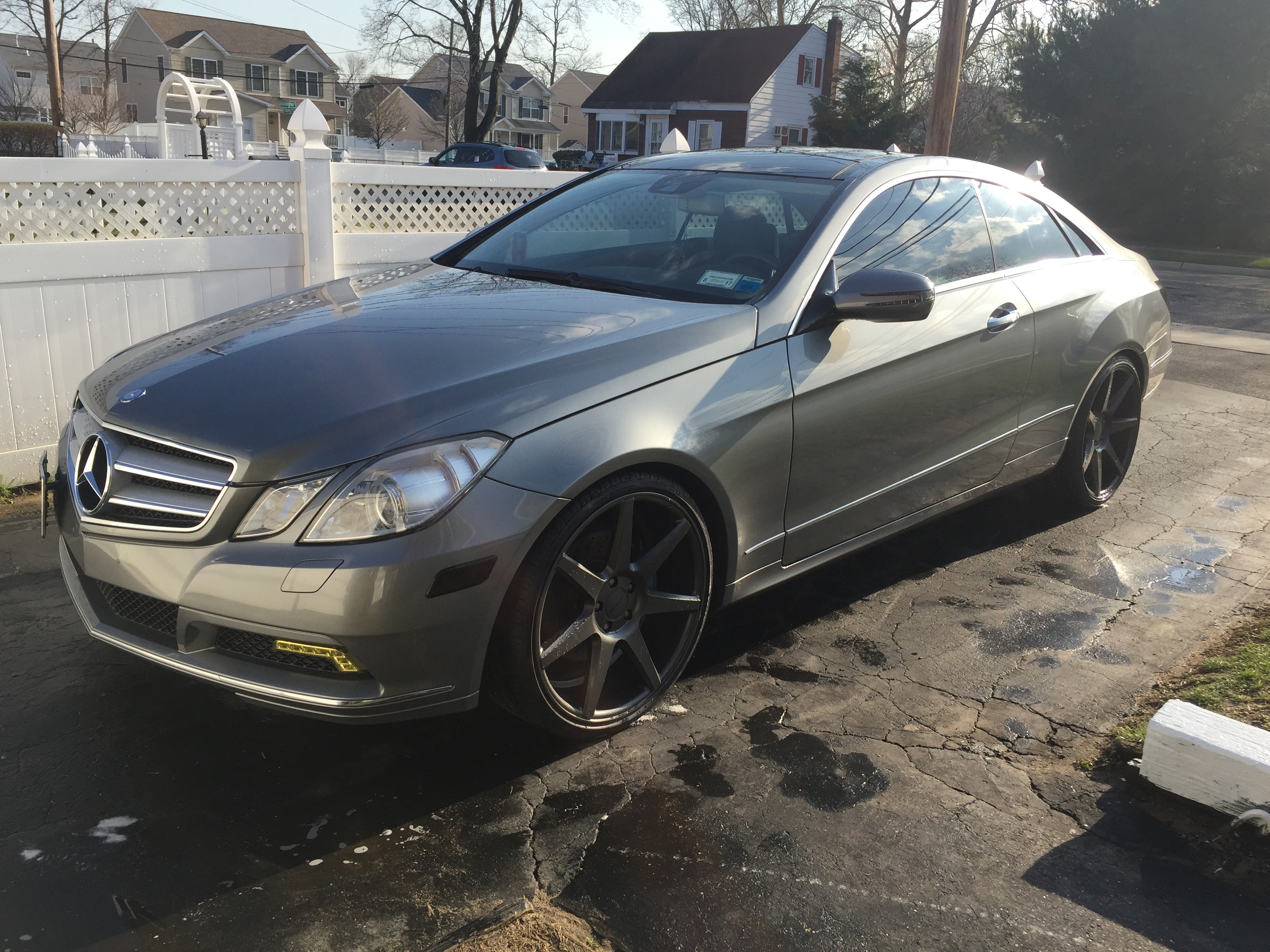

So im using my iPad and it only allows me to upload one picture idk why but here one picture lol so wheels size are 20x8.5 +44 and 20x10 +55.. I will post more pics when I get home and use my laptop.

here is a couple more pics of how my setup looks.i hope you guys like it as much as i do.i might get some coilover in the near future just to lower the car a little bit more in the front and in the rear without rolling out the fenders.
