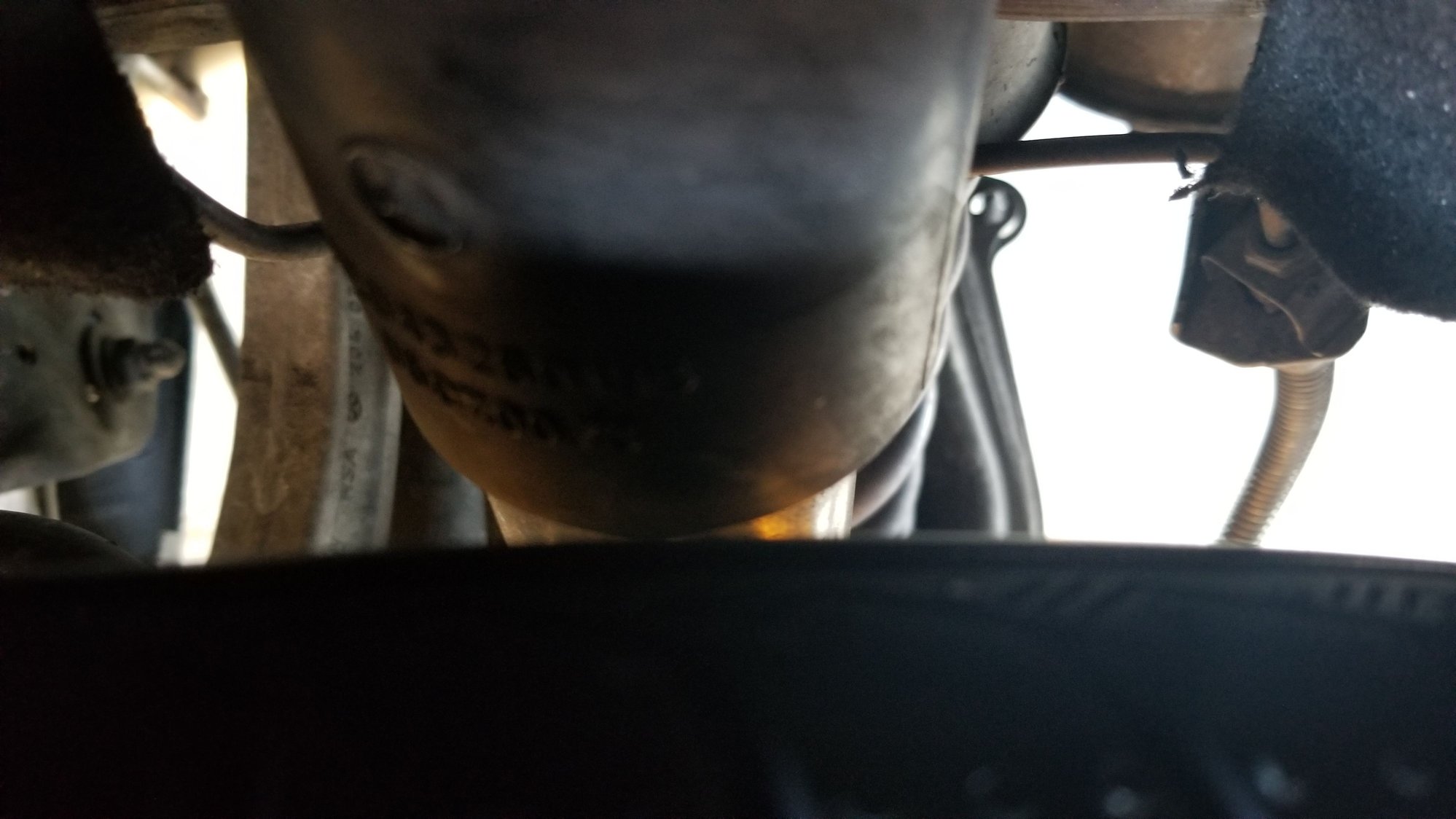

Yup! I'm actually running a 275/35 with no issues at the moment, was on a 285/30 before lowering, fender clearance became an issue at my current height with the 285s though. With the 275 there is only around a half inch clearance between the strut and tire. I think going 305 would be cutting it real close (an extra 15mm/0.6in on both the inside and outside of the tire). Some pics below for your reference.

I was rubbing pretty badly on the outer fender liner/the plastic that seems to be friction welded on the inside lip of the fender. You could perhaps try to modify the fender a bit, but I've heard they're quite difficult to roll. Not sure if V3s are any thinner than the stock struts, so don't know if they will give you any benefit on the clearance between the wheel/tire and strut. They would certainly help with the rubbing on the fender as you could set the height of the car, I'm at the mercy of how my H&Rs settled. Another couple pics below of the flushness of the tire with the fender. I know it kind of looks like theres a bit of room, but the damn plastic stuff inside of the fender robs you of another quarter inch or so.

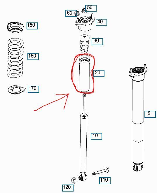

Your pics gave me an idea and an observation. You said that there is ½ inch between the tire and the rear shock. I checked the part number on the black “tube” in your picture ( thanks for the clear pics! ) and all that thing is, is a black “protective tube” < that’s what’s listed in the parts catalog. That protective tube is wide and thick and is robbing precious inches from the backspacing of a meatier tire.
It “protects” the needle like shaft from the environment. Here’s the catch, that can be done away with in order to gain more space as many shock manufactures do away with this “tube”. many kits (Aftermarket and even OEM ) don’t have this, so I am classifying this as a non essential, and non critical part of the suspension setup.
I have attached pictures of a KW kit without it and also a Mercedes parts diagram with it highlighted. If this part were to be taken off, the rear rim backpad can be CNC’d shaved a couple of MILIMETERS, pushing the whole wheel and tire “in” toward the strut, one can gain gain 0.75 of an inch or more space (factoring your original ½ inch). Ive seen hairline like millimeter clearance with suspension components with the mustang guys and although close, there is no rubbing or contact with moving suspension pieces as long as every mm is taken into account.

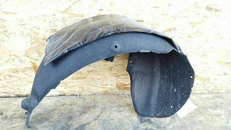

If the plastic fender well has to be trimmed off completely to gain some vertical clearance there is a method (also see picture of rear plastic fender liner). the underside of the fender well will need to be replaced with truck-Bedliner spray (like rhino), ultra thin dynamat and or weather resistant felt type material (these are tricks used in the car modding industry to squeeze ultra wide wheels in different makes without going widebody or fender flares).

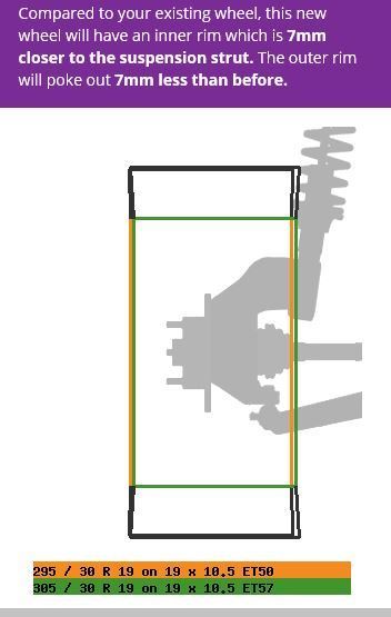

Leaving this right here, using the c63 couple Rim specs.
I used a 295/30 19 hypothetical tire size with your wheel specs (19x10.5 ET 50) to gauge difference. It gets pushed in 7mm toward the strut but also (which I guess it’s a god thing) 7mm away from the other problematic area of the inner well/ lip.
