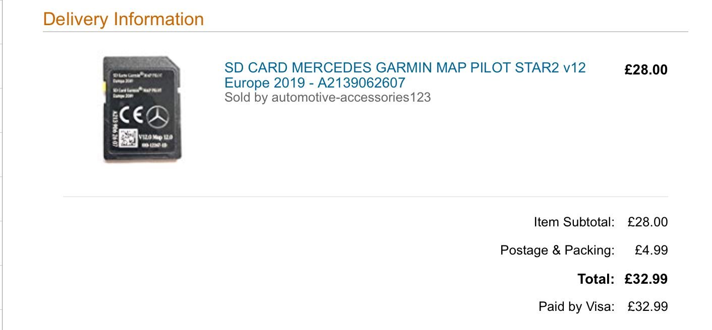

Hi. Just joined. I have recently purchased an Eclass 350 cabriolet 2014.
There was no memory card in the slot so when the sat nav is on it doesn’t pick up my correct location. It shows a different part of the Uk which I’m guessing was the last place it was last used with the missing sd card. I purchased a sd card from amazon and put it in but nothing has changed.
Just wondering if anyone can point me in the right direction as to what I need to do next.
Cheers Dave

Hi thanks for your reply. When I put the nav on the the map that comes on the screen is a totally different part of the country than where I am. 🤔

Just to make clear, the SD card has nothing to do with your navigation. It is only used to play music from. Your GPS trouble is totally unrelated.
