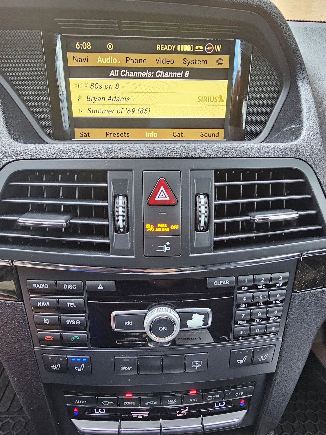

Well, my order came and there's one thing I can't seem to figure out. For the LVDS box, there doesn't seem to be any connector that will fit into it...

You might have the wrong LVDS box for your screen. That box lools like for NTG 4.0. The LVDS red cable needs to connect to one of the power wires from the main harness. Look for one of the male plug that will fit the female end on the LVDS and look at the label. BTW....if I were you add a foam pad (2mm thick) between the plastic housing and the screen (the bottom flat surface where the screen sits into) to make the screen rigid and not wiggle up and down on bumps (trust me on this one). This will also make the screen not feel flimsy. Go to a craft store and look for a stick-on foam pad then cut to the shape of the bottom of the trim. I went through a lot of trial and error to figure out how to not make it wiggle and now it is like OEM fit. Before if I press on it it will flex, now it is rock hard and no squeaks.

Appreciate the reply and the tips. From all the pics I've seen on how to tell them apart, mine is an NTG 4.0, isn't it?
False. Yours is a 4.5. 4.0 does not have SD card slot on the faceplate. Contact the seller and ask for a 4.5 LVDS module.

Ugh. Wish they would state that in the "pick which one you have" choice. Instead, they simply use the pics of the screens - and mine looks like the top one.
I wonder if anything else is different for this install now...
