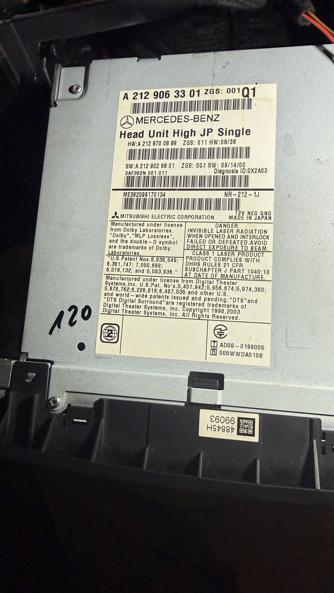

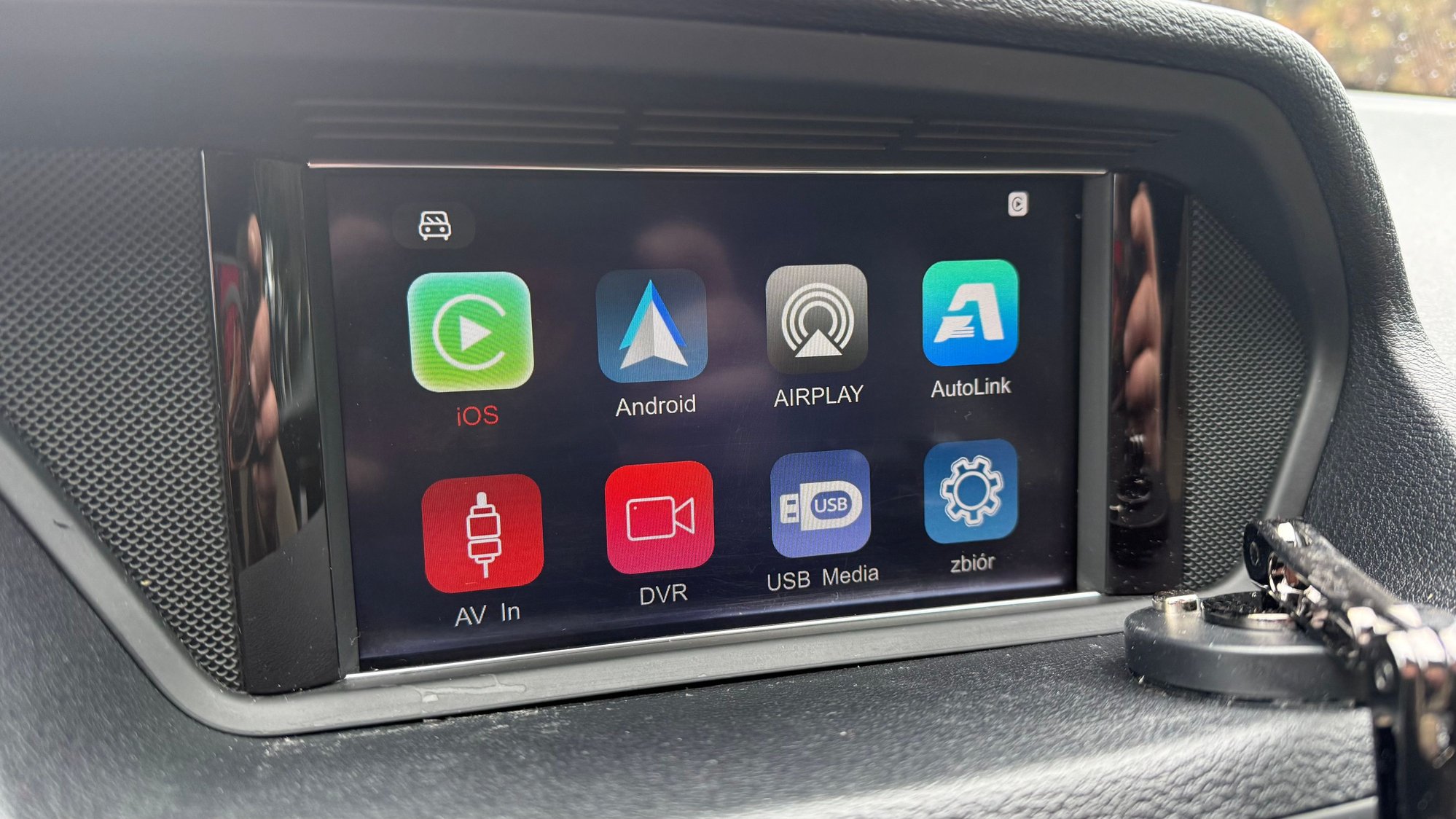

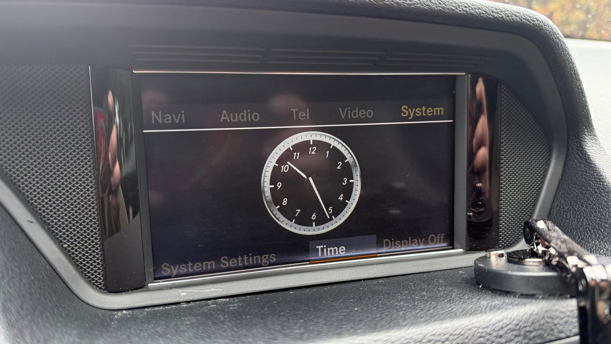

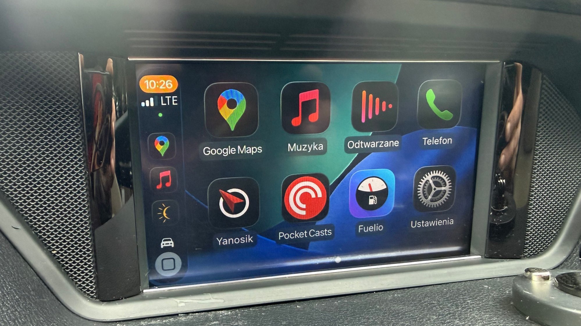

Yesterday I finished installing the CarPlay box. I have NTG 4.0, JPY version, and I used the Bonroad box from Ali.
Impressions:
- I have AUX and AMI, but the sound goes through the car's Bluetooth, so the quality is nice (still digital). The Harman Kardon is only useful for CDs and DVDs, which can be played while using the CarPlay module-also nice.
- The module wakes up on its own, without any intervention. I get in, my phone in my pocket, and the menu opens automatically. It's fantastic.
- The display is 7” 800x600, ages behind today's smartphones, but it works great for maps. Smooth, very good colours, contrast. Resolution is visible only watching pictures, but->next point
- it was MUST to keep original interior design. I consider touchscreens dangerous, and operating Command is comfortable (of course, I broke comand knob; I've already ordered a metal shaft).
- Smoothness, usability, speed, and phone connection – excellent. I recommend an wireless charger, as it drains the phone battery faster.
Concerns:
- I'm aware of the possibility that it might overheat in the summer. The box is behind the screen; I'll let you know in six months.
- The installation isn't tricky, or bad, it's terrible. It took me two evenings, and I was about to give up. There's no space, you have to break your fingers in 20 places to install it, and it still lacks flexibility. Huge risk of cutting wires… nightmare.
I'm happy with the result, but don't let anyone think it took 20 minutes, like on YouTube.
