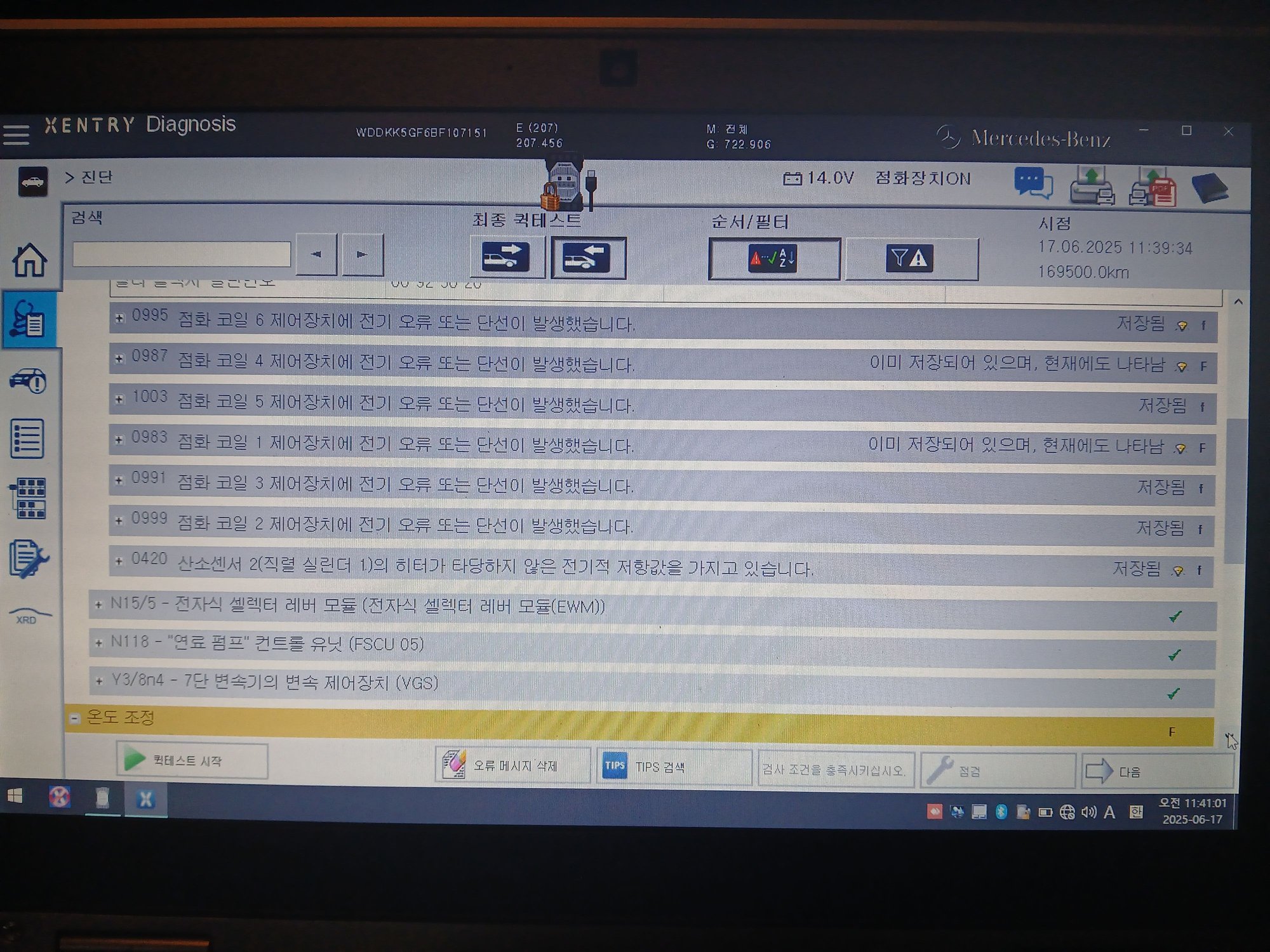

Hi, mine is w207 e350 cabriolet(2011 year, m272).
When it drives about 100km, all of those engine fault codes come up one at a time. p0351~p0356 and p0054. However, there seems no problem, such as misfires so on.
I did replace all of oxygen sensors(upstream, downstream) and six ignition coils, plus spark plugs.(oem or genuine)
I looked up the live data; they all are in proper range. Nothing so over or under.
The ecu has no problem, looking in and out. Fuses in a SAM control module has no damages.
Has anyone have this kind of issue?
I've got no idea what brings these codes.

You've done a good job initially at swapping the faulted parts.
Now you realize it's time to troubleshoot this further more seriously...
Both of these issues involve a bad connection
I can guess... likely a shared marginal power GND.
Study your electric diagram by VIN to spot what are shared circuits path around:
ECU + COILS + LAMBDA HEATERS.
Your Mercedes will run very well afterwards.
