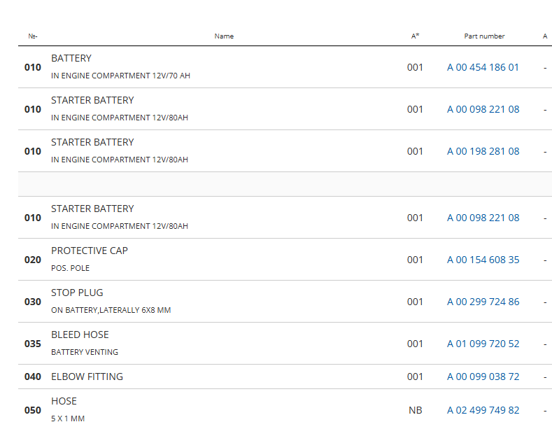

Im not sure for yours. My W204 with M272 engine has the 84ah battery which is H7 agm. Parts diagrams options show 70ah, 80ah, 84ah.
I looked up part #'s for the E350 207.456 which is a cabriolet with M272 engine and they list either 70ah or 80ah.

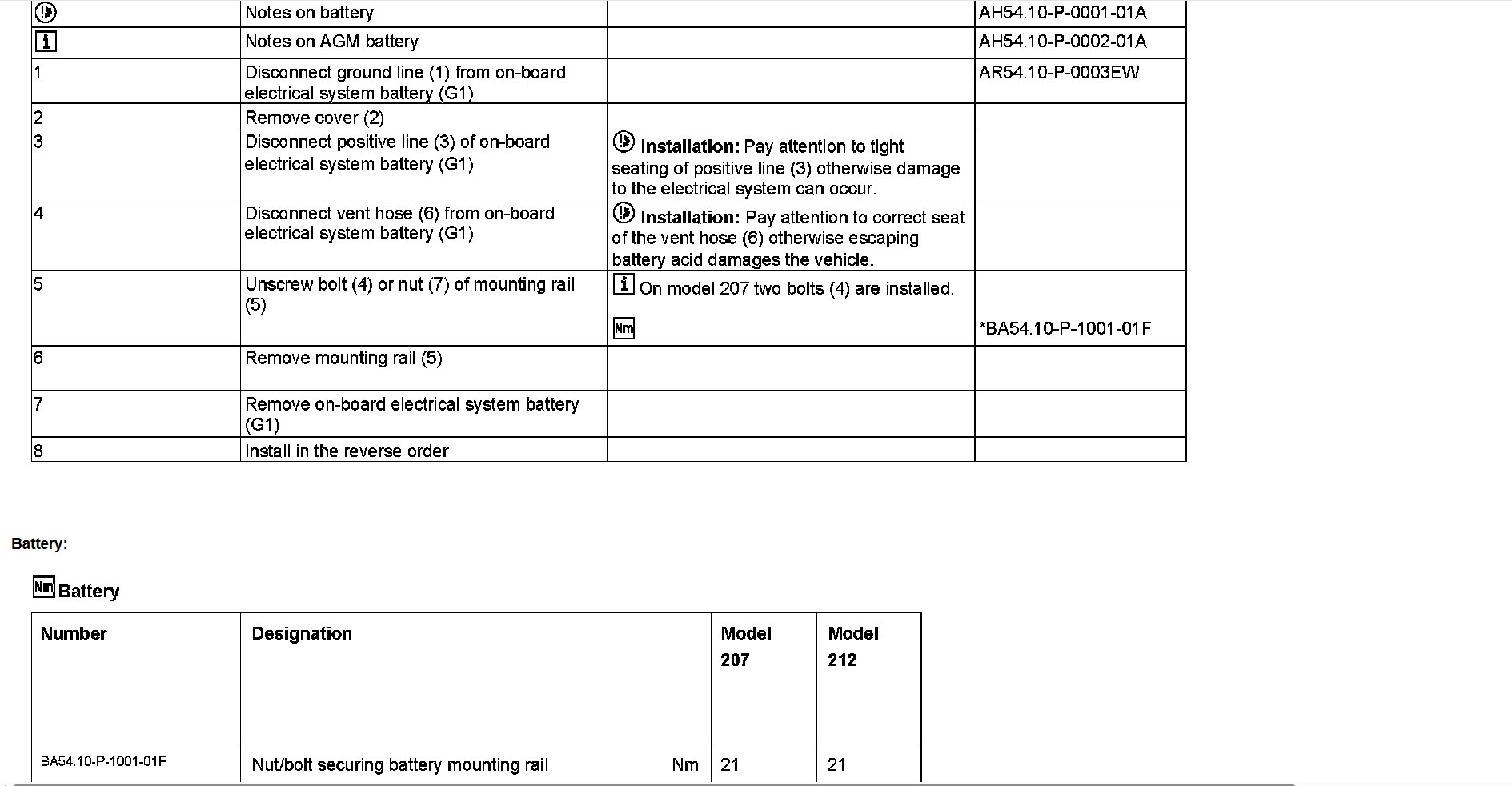

Pretty much same procedure for replacing the starter battery.

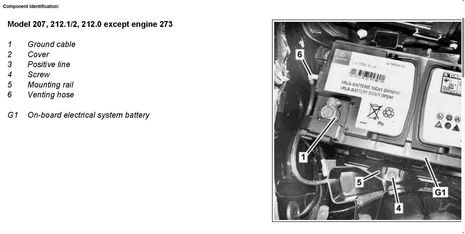

* Just noticed it looks like the hold down bracket on the 207 is on the front of the battery. My W204 is on the side near the engine.

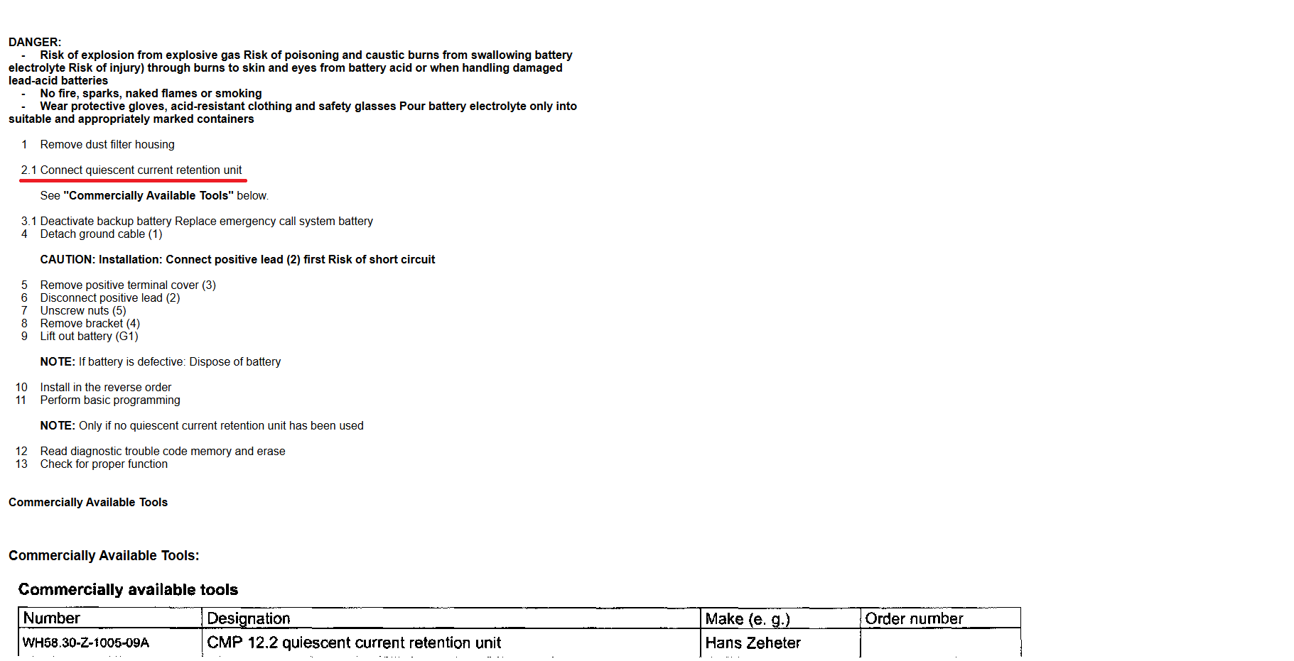

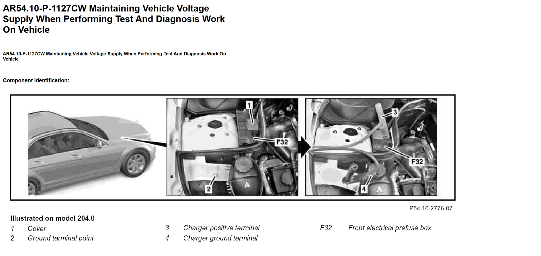

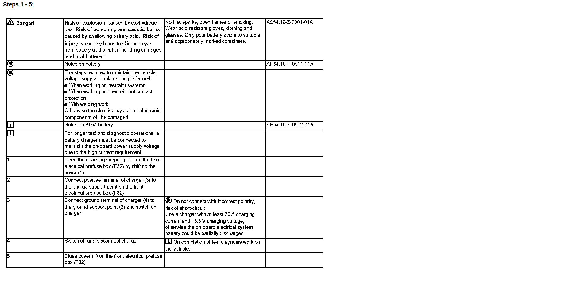

I come across all types of information its hard to remember where i saw it. Just found the info on connecting the battery adapter:
